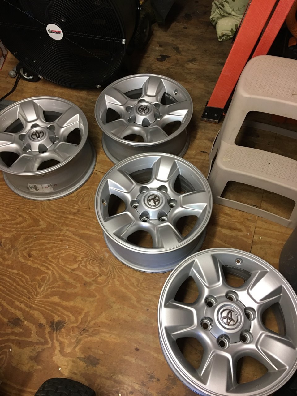

    Anyon have success with a specialty company that bead blasts and powdercoates the factory silver and then bakes on a clear coat? They quoted @100 a wheel which wasn’t bad, I guess you have to really want to keep that factory wheel for that money.
    I almost had this done to my wheels, which won’t be on till next week. I knew the exact wheel I wanted and have for years. Finally came up on Craigslist about an hour away so I went and got them. They indeed have been refinished by someone else.
    Factory 1st Gen Tundra/Sequoia 16” 5-spoke rims.
