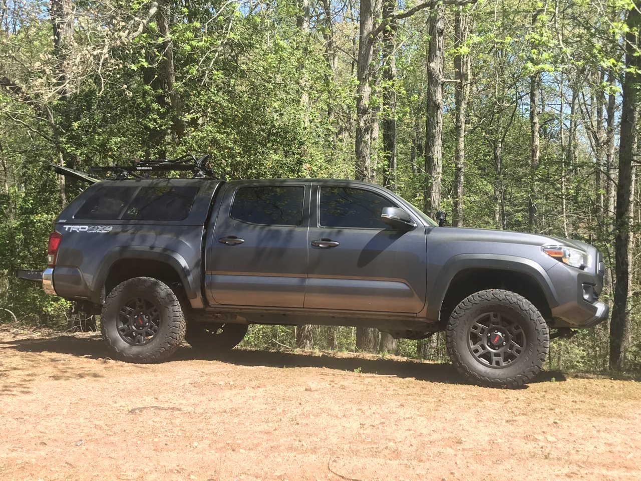

    Hahaha yeah I love the top, very useful for me but I tried taking it off the other day to haul a big package and 180 lbs just wasn’t happening by myself lol

    Thanks man I appreciate it! I have the full Icon stage 2 kit with 285/70/17 BFG KO2's. I honestly need to get upper control arms. I want to adjust it up a little higher, (I believe im only sitting around 1.5" of lift over stock right now.) I want it to be at least 2.5" over stock. These damn trucks are always a work in progress lol.

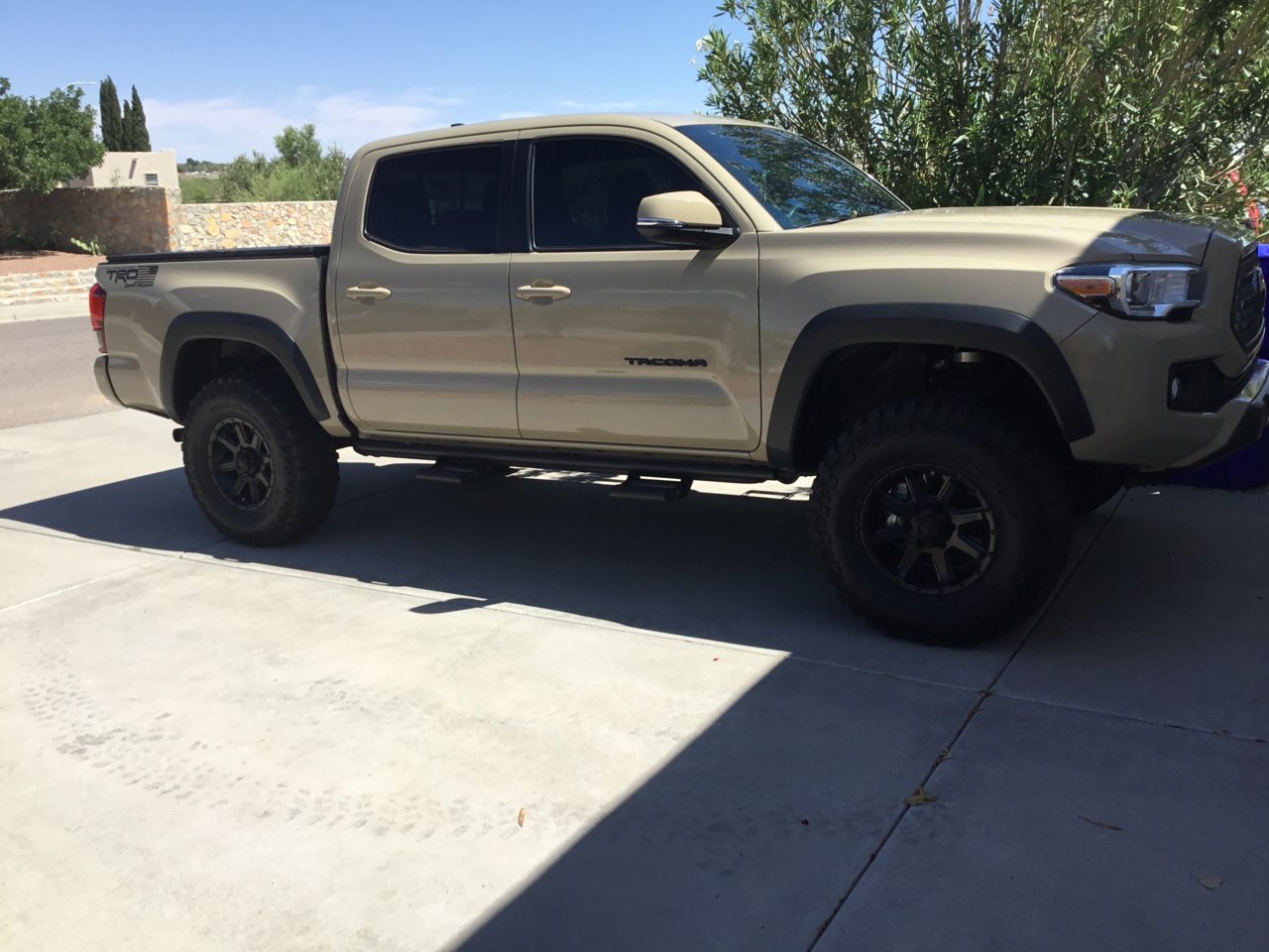

    I can’t remember what percentage my tint guy told me the OEM were, but he did tell me that they were factory tinted all around and did block UV. My front windows were tinted to match the rear as closely as possible and the windshield as much as possible while still remaining legal.

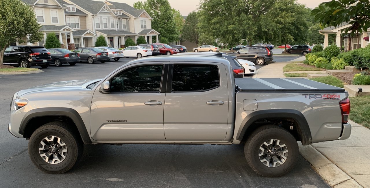

    Add my two cents. Buddy is former police officer and professional tint installer now. He recommends machine cut ceramic tint which is what he installed on mine. Blocks heat from the cab of the vehicle which is a big added benefit.
    First, all glass isn’t absolutely clear (aka 100% light transmission) that’s why you get readings of around 72% on your front windows.
    Stock rear tinted windows meter at about 29% using his meter.
    I had him install 35% ceramic on my front windows and it matches virtually perfectly but is technically a few percent lower ~26% when metered.
    Another note on the laws, often they are NET values. Meaning if the law says 35% net tint allowed, putting on 35% tint will (as mine does above) result in a lower net value.
    I would highly recommend doing 35% film on the fronts if you want to match the rears perfectly. (Photo attached)

    Ceramic is what’s on mine. It’s more expensive but worth every penny I think.

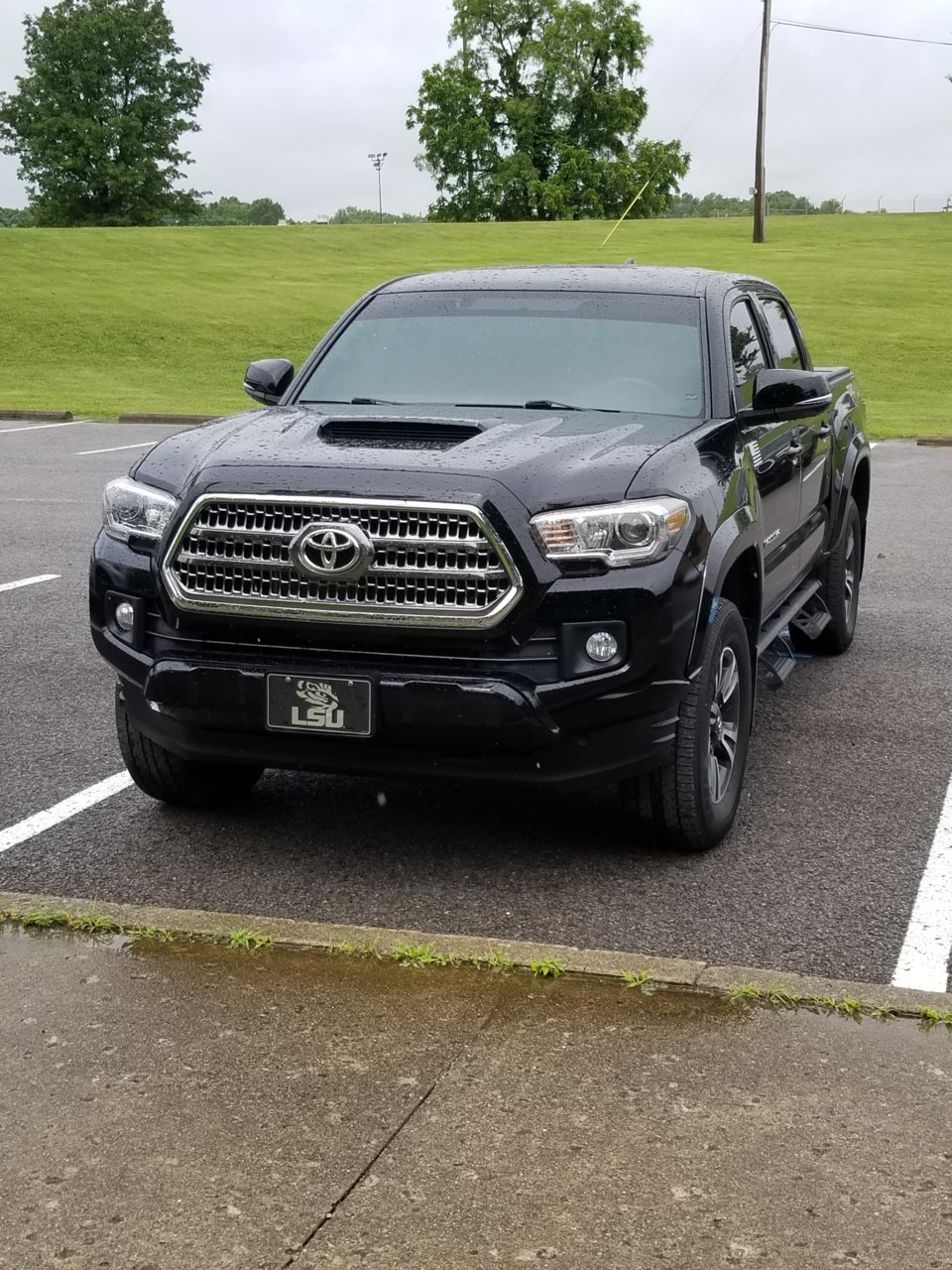

    Here in Kentucky this is legal, and let me say, that strip makes a world of difference, same percentage as the rest of my tint. Is this illegal in Californistan?
