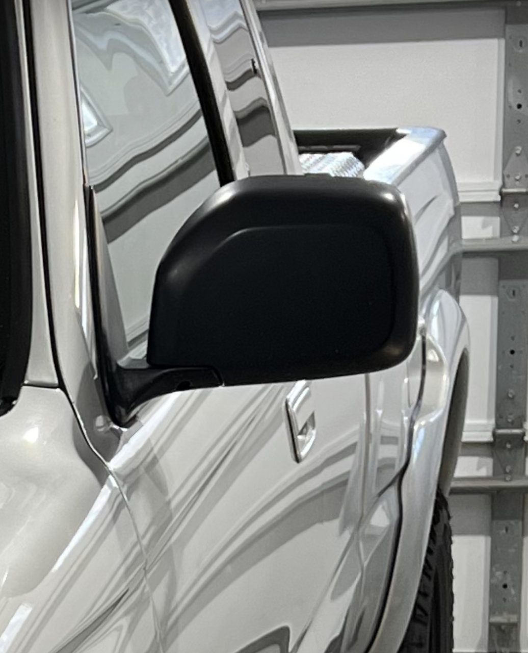

    6E06A8D7-51FA-4EFF-B727-F88DED30C296.jpg Has anyone had any success in restoring some of the luster to the black plastic mirror housing? I’ve been giving my Tacoma a bit of long-overdue detailing love and in addition to a good polish, underbody fluid film treatment, new Weather Mat floor mats and a front bumper replacement (separate thread), I was wondering if there was anything I could do to restore the sun-faded black plastic on the mirrors. The picture is a bit deceiving because I just wiped the plastic down, so it appears much more glossy in the picture than it is, but I’d like it be this glossy again. :)

    I use Mother's Back-to-Black on all my trim. It comes in two kinds: paste and spray. With the paste you have to wipe it on and buff it off after it dries. With the spray you simply spray it on and let it dry, then buff off any overspray that lands on your paint or glass. I definitely prefer the ease of the spray. Works amazing and lasts for months before you have to reapply it.

    Black to back as others said. If they are too far gone you can plastidip them like I did. Was about to replace them till I read up on here. Used grey scotch brite to lightly sand them, followed by alcohol then multiple coats of black plastidip. Turned out like new. I use liquid car wax on them after each wash.

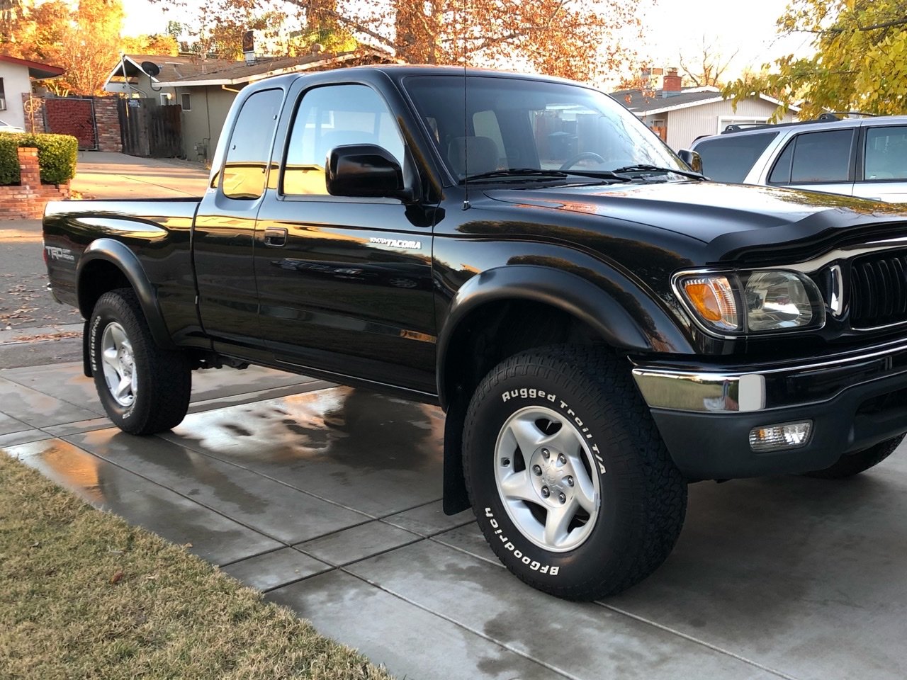

    I just wax my mirrors with Griot’s Best of Show wax at the same time I’m waxing the whole truck. Keeps them looking great for a long time. Mothers Back to Black washes away too fast in my experience with using it.
    Edit: Added photo, but mirrors look much glossier in person.

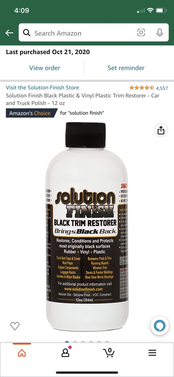

    This stuff works amazing for SoCal faded plastics. Lasts forever too. Found this product from following detailers. 4519ACCD-30D1-4DA6-AA4A-64BEA6EC8F04.jpg

    I use this stuff on my fender flares.
