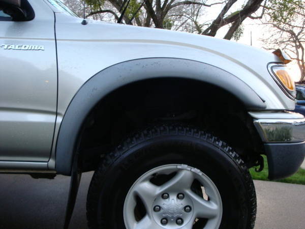

    On my lunar mist metallic, mine were so bad that I remember I did a double-take when I was considering buying the truck to figure out whether they were color matched...
    I am going with the Magic Eraser followed by 303 UV protectant route.
    Did one side of the truck today:
    Before:
    After. This is about 15 minutes with one pad, and without applying any 303 yet. It looked even better after the 303, but it was getting dark and I was wet and tired and cold....
    We'll see how the 303 holds up. I can't wait to do the other side, then hit the bumper valance. So far, I am a big fan.
    And NO, I DO NOT Armor All my tires. They are just wet. So don't even start.
