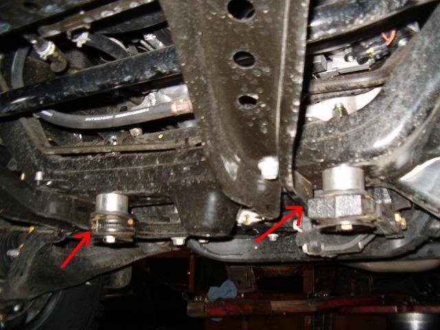

    From this picture I only see them using the big spacer and the longer bolt supplied. I understand I probably will use the nut and big washer supplied to bolt it down, but what are the 4 squares and other bolts supplied, along with smaller washers used for? :confused:

  18. May 18, 2009 at 12:57 AM
    #38
    RelentlessFab
    RelentlessFab Eric @Relentless Fab Vendor
    Feb 17, 2008
    #4772
    15,815
    Eric
    Sparks, NV
    07 AC 6mt>03 SR5 >08 Sport and 17 6MT TRD OR
    Relentless Armored! Too many others to list.
    Hmm, IDk really. My kit didn't have those in it. Maybe they're for re-installing the skid so there isn't the interference I mentioned before?:confused: Read the directions and let me know. I'm curious now.......

    Yep, looks like I was right in my previous post. They're used as spacers to give the clearance needed to install the skid with the diff drop spacers.
