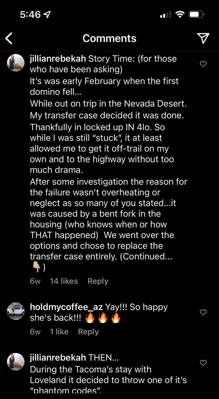

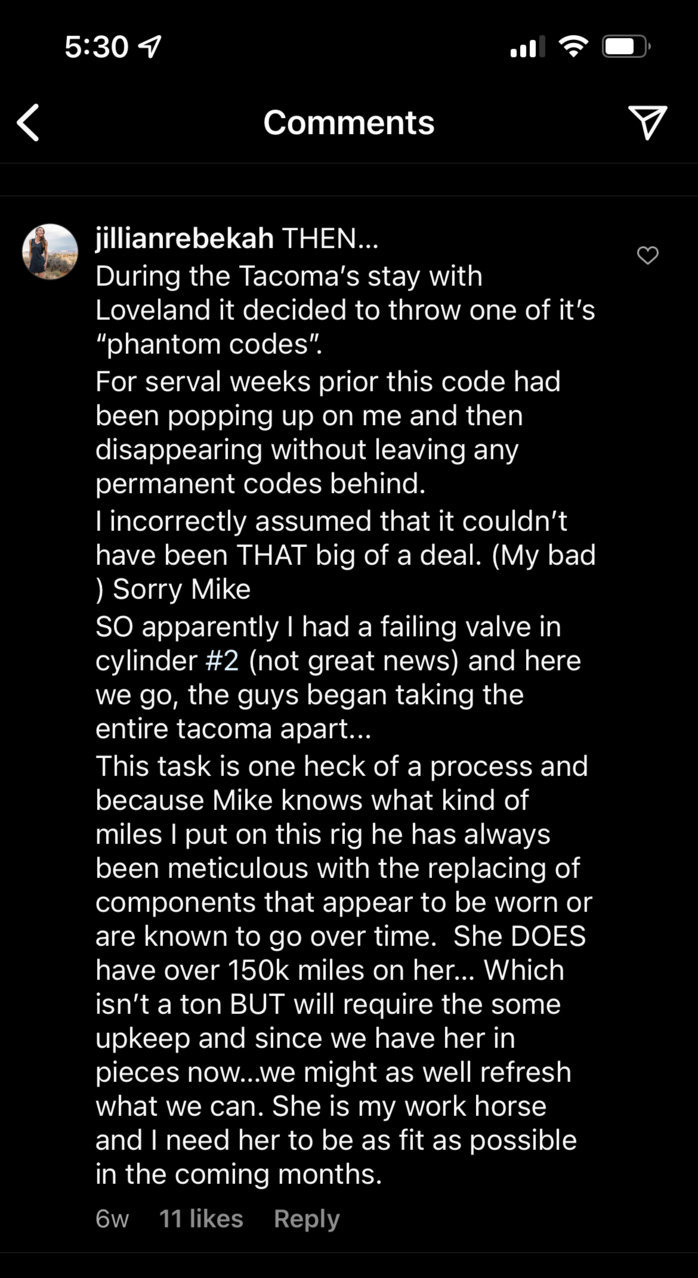

    Not sure if it’s been covered already, I follow this person on IG. Took a screen shot of her post explaining what happened to her taco at 150k miles. Seems like one of the valves failed, along with the transfer case.
    150k miles of constant abuse is pretty good, but definitely expected a bit more though. I believe I’ve seen a few with valve issues and there’s also a few that have grenaded at an incline. As the tacos age, it’ll be interesting to see what failures become a common issue for those that wheel their rig.

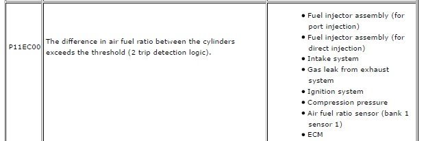

    Damm!!! So today my 2018 with 49k miles the check engine light pop with P11EC.. Is there a slight chance is not this freaking valve 1 leak?

    What are the symptoms?

    No symptoms. It just pop i i used my pocket scanner!!
    Thanks in advance!!
