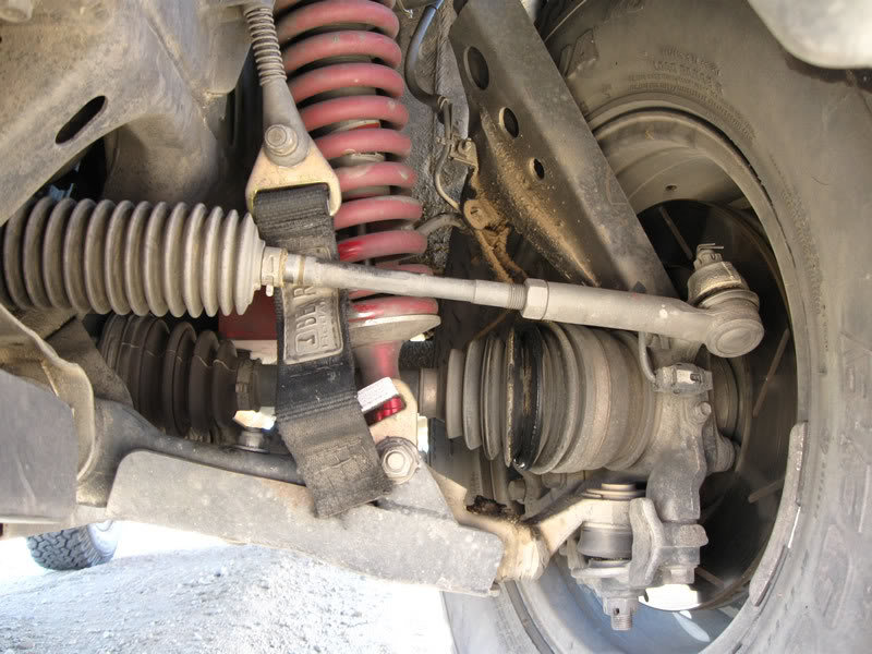

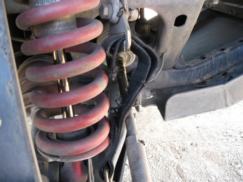

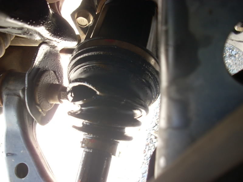

    I was just too hard on this stuff:

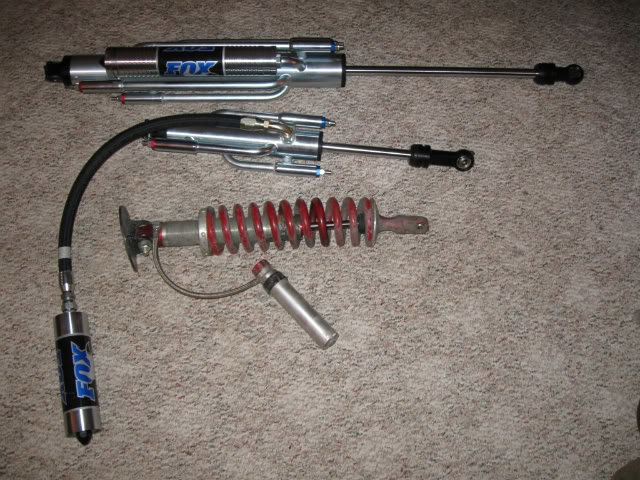

    Bent the heck out of the coilover at the bottom of this picture:

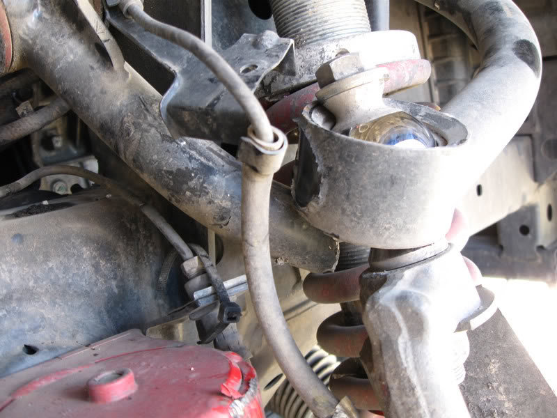

    I installed something wrong here:

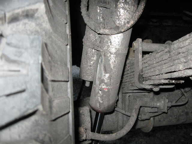

    And the Tundra Racing rear disc brake kit will wear a hole in your driver's side rear shock.
    There was other stuff but those are the big ones.

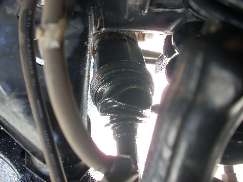

    I installed OME 886's with a .5" top plate spacer in anticipation of a bumper and winch, because everyone is saying they only got 2" of lift out of the 886's alone, well it put me at over 4" of lift, closer to 5" and I ended up doing this
