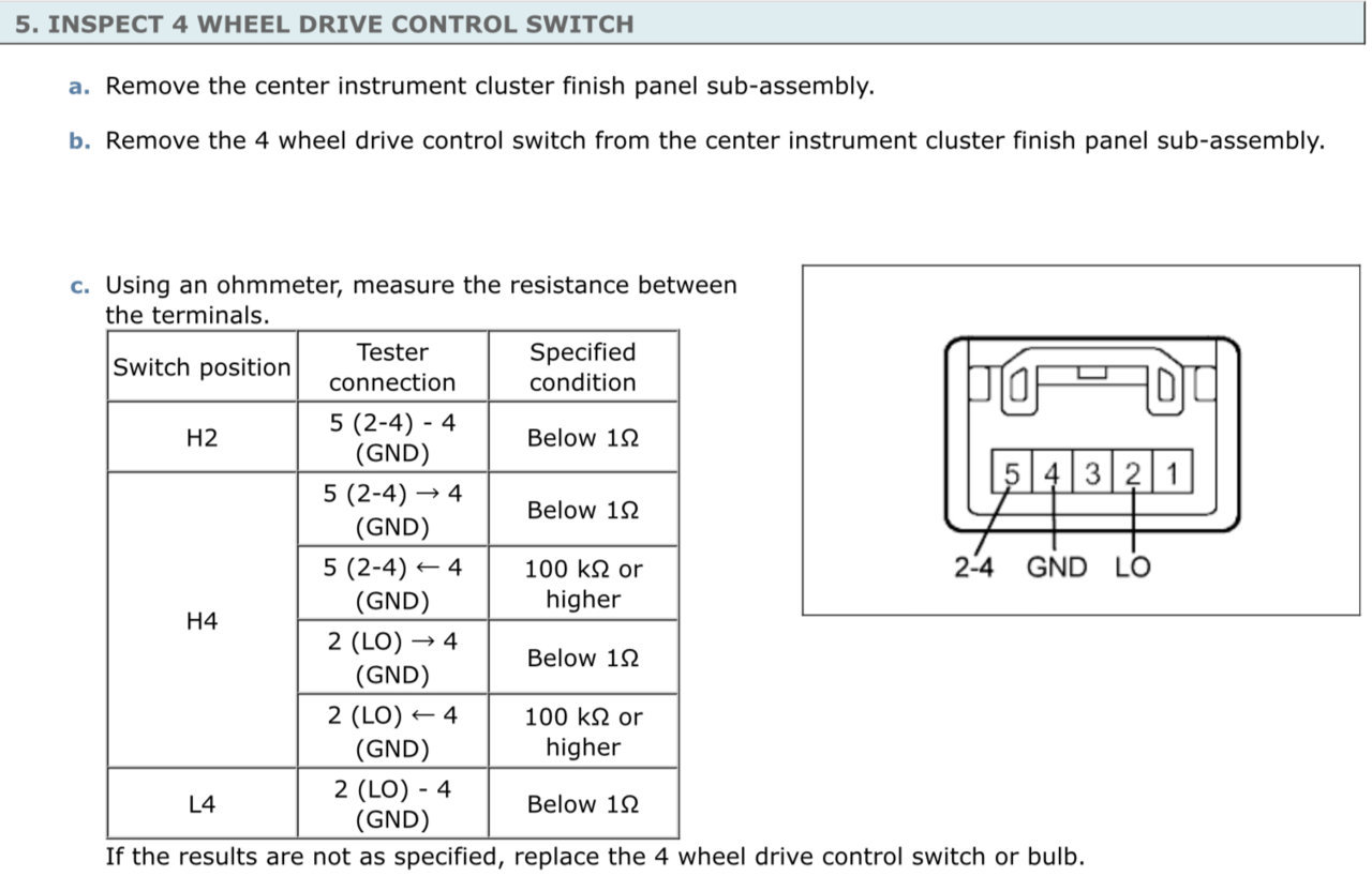

    @Dm93 can link you to his thread to check the switch voltages.
    Dm93 and Bishop84 like this.

    Dm93
    Dm93 Test Don't Guess
    Mar 3, 2015
    #150066
    12,710
    Texas
    2014 DC OR 6spd 4x4
    Predator tube steps, Ranch Hand grill guard, Magnaflow CatBack exhaust, Toyota tool box & bed mat, 2LO Module by @Up2NoGood, Rearview Compass/Temp Mirror, Tune by @JustDSM.

    Sounds like a good plan.
    I don’t have one of those, but I know a guy that does:rofl:

    Oh I do exercise it frequently, it's not the actuators that are getting stuck, it's that they're not being told to shift for some reason
    Thanks for the info! I'll break out the DMM and start poking at it.
    I'll check the switch first and see if those readings are in spec or borderline. If they're kosher, then I'll try removing the module. Just because it's an intermittent problem and there's no way to know immediately if removing the module solves it.
    Thanks for the input everyone, I'll start looking into it.

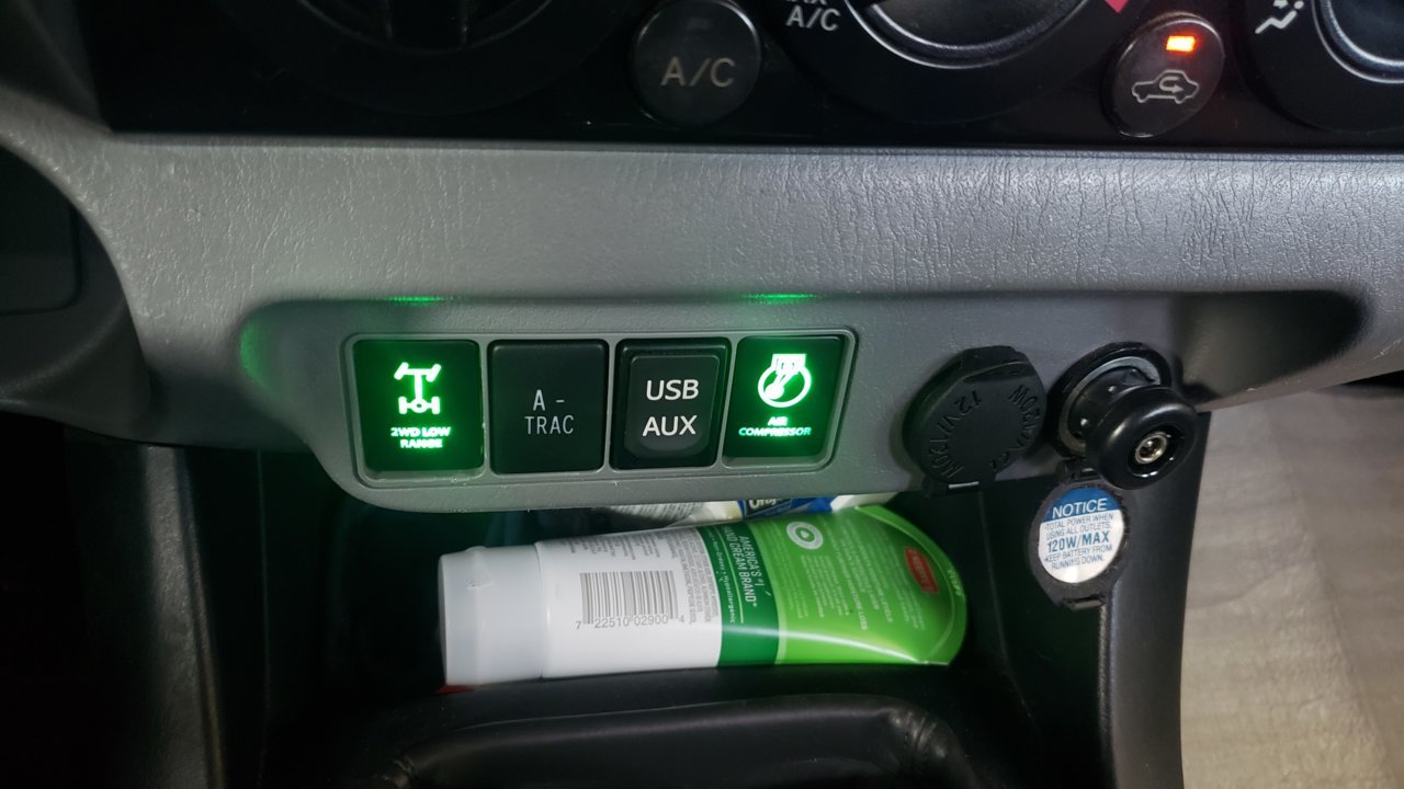

    Are you using the external switch for the 2low module or controlling it with the 4wd switch?
  11. Mar 9, 2023 at 5:50 AM

    Controlling it through the stock 4wd switch

    Ah, maybe the module gets confused at times if you move the switch too quick? Just a thought, I had mine that way when I first got it and it seemed to work fine but I didn't like that it would go into 4wd if I turned the truck off and restarted it so I installed a separate switch.
