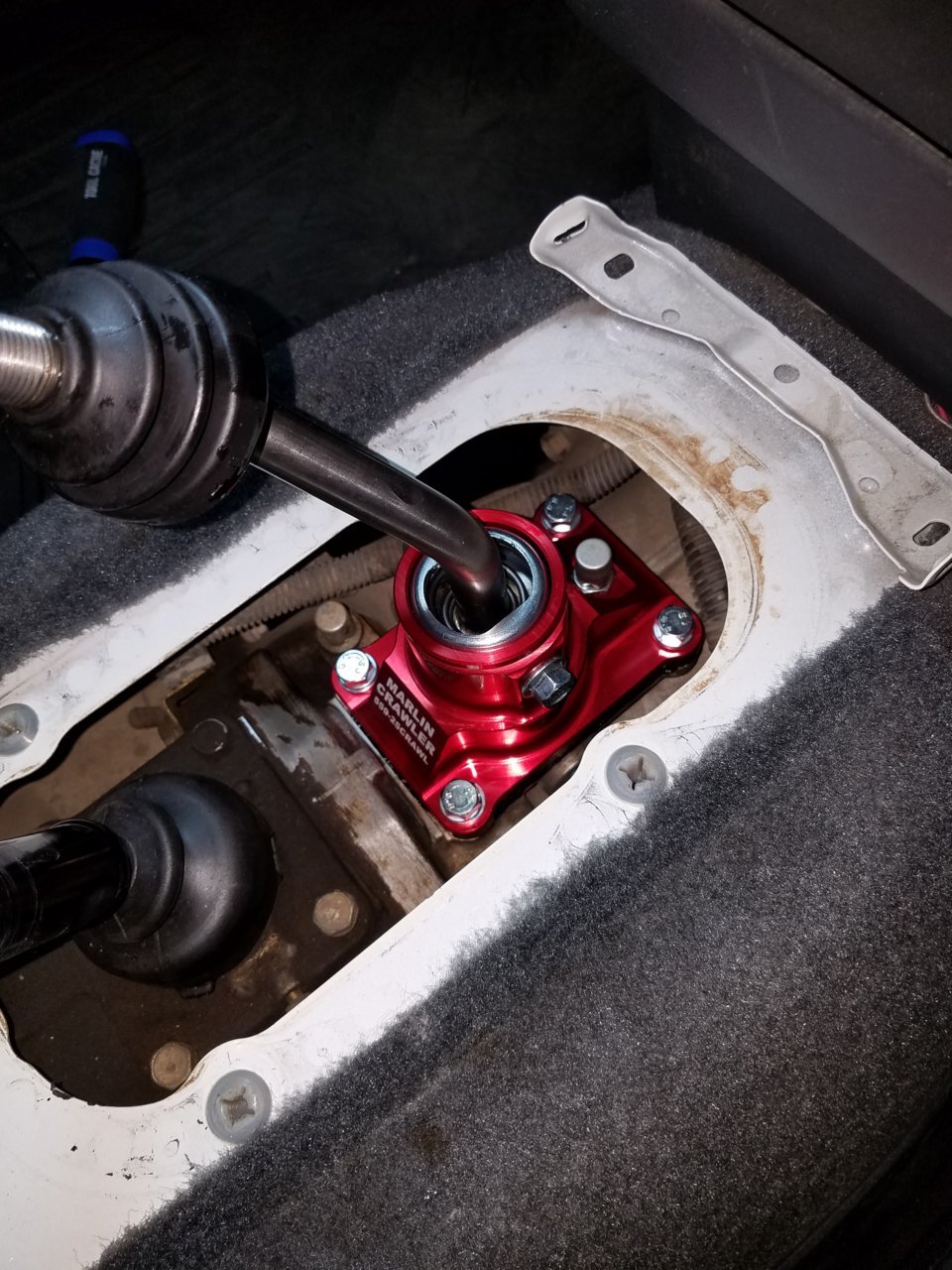

  4. May 16, 2018 at 2:28 PM
    #44
    homegrown_xt
    homegrown_xt Well-Known Member
    Apr 24, 2018
    #251572
    587
    Sonoma County
    1996 Tacoma Xcab 4x4 V6 MTM
    Rancho Quick lift. Wheelers Off Road Progressive AAL with Rancho RS9000's, braided brake lines & clutch line. BFG 32x11.50 15 All Terrain Tires Deck Plate Mod. Flowmaster 60 series muffler and Marlin Crawler Short Throw Shifter.
    I got the Marlin Crawler kit. I had the LCE kit but the ball adapter didn't fit very well to my stock shifter so I had it tacked welded. Didn't feel comfortable with it so I switched over to the Marlin kit.

  5. Jul 24, 2020 at 3:22 AM
    #45
    stevotivo12
    stevotivo12 Well-Known Member
    Feb 3, 2016
    #176967
    1,638
    Stephen
    2016 Silver Tacoma TRD Sport MT
    Front hellwig sway bar,All pro sway bar end links, Fox 2.5 Resi Coilovers and Shocks, Fox 2.5 Hydraulic Bumpstops, Budbuilt Traction bar, Total Chaos UCAs w/ heim joints, Icon AAL, AFE Power Intake with dynamic scoop, URD spec U, URD short shifter, Flossy weighted shift knob, michelin tires, black badges, black tailgate letters, black grill with custom Diaz Fab Devil horn yota logo, retrofit/morimoto HID conversion, red interior LED lights, Pioneer head unit, kenwood excelon door speakers, 2 10" pioneer subs,
    Yeah the Hurst shifter is a better solution IMO. It feels better, works better, and is less likely to break being that its all metal and designed to work the way it does. Only 'downside' is that it generates a little gear noise due to the solid path from the transmission into the cab, but you get used to it fast
