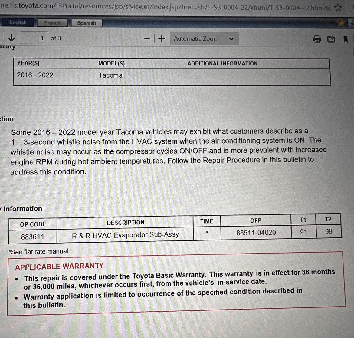

    Here we go. Finally got Toyota to admit it and fix it :muscleflexing:

    Sweet! How would I go about getting this fixed?

    It’s a TSB, so you just go to the dealership and tell them to fix it

    Please follow up and let us know how it goes. What they have to rip apart or any issues after the repair.

    Will do. But it’s just a full dash rip apart to get to the fan assembly. Then it gets replaced! Curious what the part difference is.

    Just took mine to the dealer. They heard the noise and are ordering the parts. Should be done next week. How involved is this repair? Anyone know?

    like I just said in the prior post, it’s a full dash removal. Also bolts from the front cowl. Not a quick job
