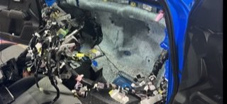

    Just an update mid-way through the swap. Not too bad. Basically just have to undo the last 149 steps that the Toyota assembly line does when building the truck. Easy peasy.
