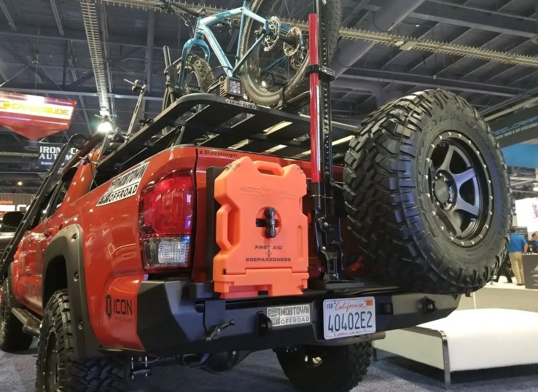

    Ours.
    Hidden hitch, reuses factory licence plate lights, relocates trailer plug, optional light cutouts and optional back up sensor cutouts. Includes the license plate bracket.
    It is not tow rated but we can safely say youll never need to be concerned. We built a hitch, stronger than what comes on the truck, then designed a bumper around it. We've trailered other trucks, on car trailers with no issues.
    Shackle points are 3/4" thick and pass through the bumper and wrap around 2-1/2" x 1/4" thick square tube, then fully welded.
    Bumper is made from 3/16" and 1/4" plate steel.
    105lbs installed

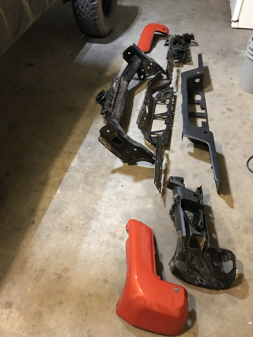

    Let's show them this revolutionary plastic bumper.
    When mine was rear ended I payed for a full swingout and sliders with the money from this design..

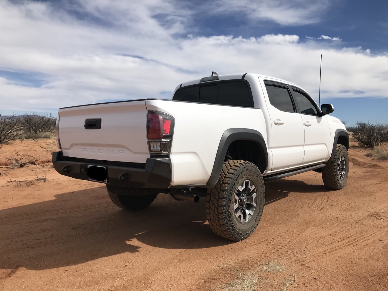

    Super clean debadged and with the Pro tails. The Storm Trooper style would look even better if it was matte white too. White is probably the only other color I would have bought after inferno.

    Both of those trucks are beautiful. Love the boxy look of the bumper. Somehow boxy and sleek at the same time, which is hard to pull off.

    The Inferno Tacoma was our SEMA 2017 build. Was placed in the Rhino rack booth. Truck was fully armored by us less the front bumper which was ARB because ours was not complete prior to SEMA. That truck has been in many magazines since SEMA.
