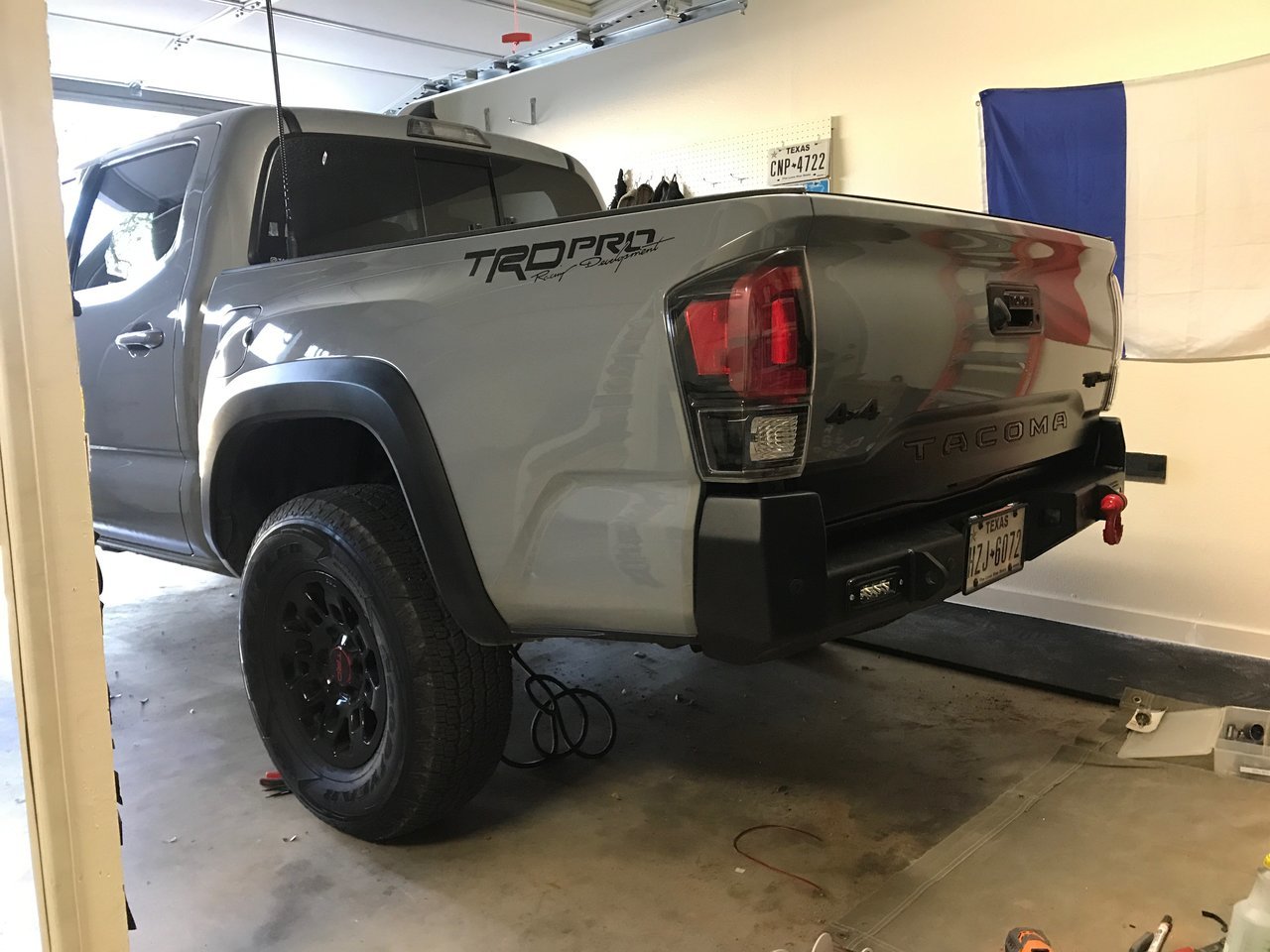

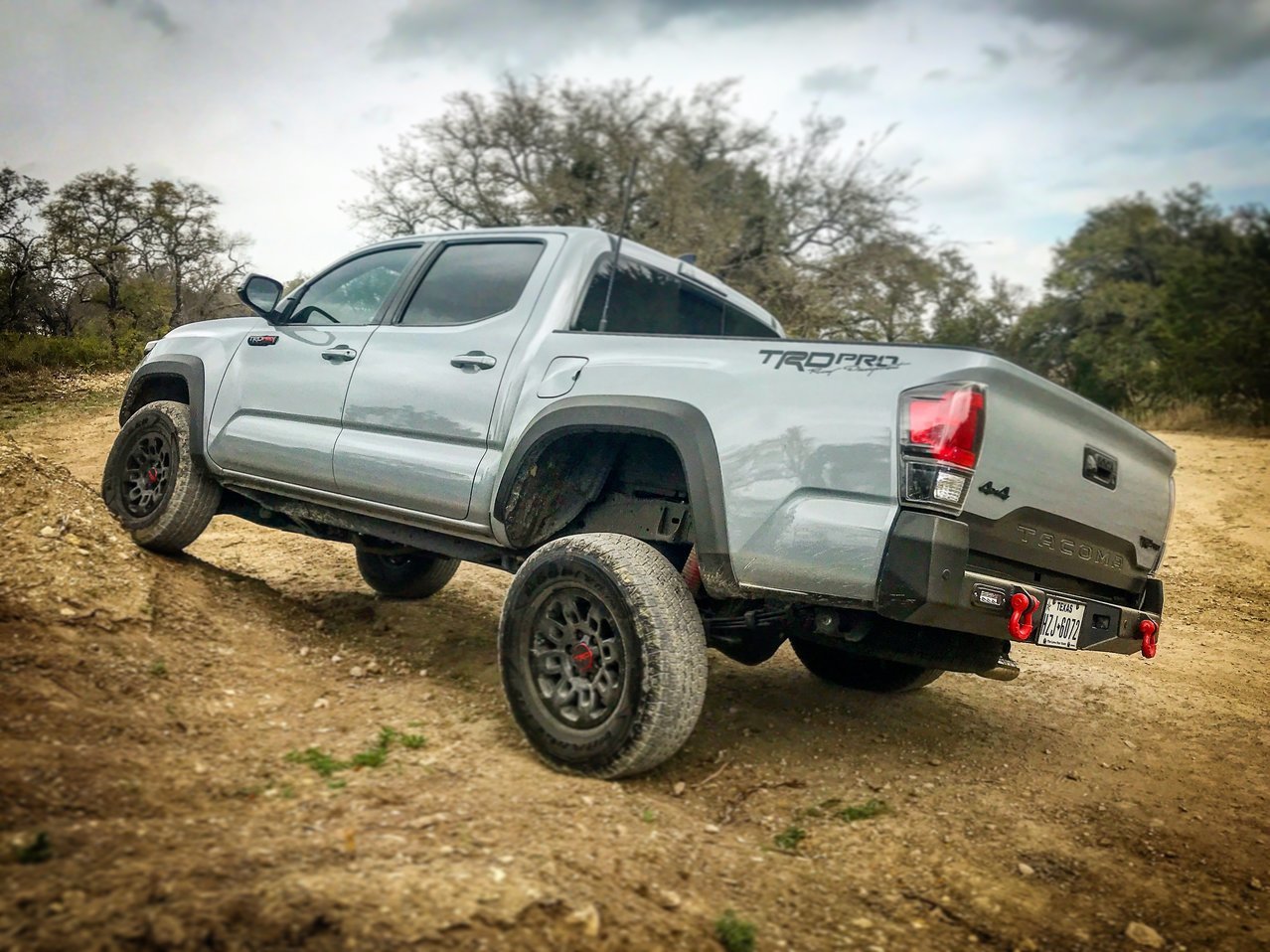

    To tacopromatt: Great rear bumper look! Nice work! Something to think about for my taco. Glad they caught the nut in Austin, too.

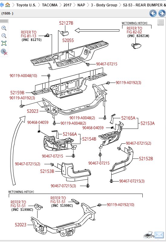

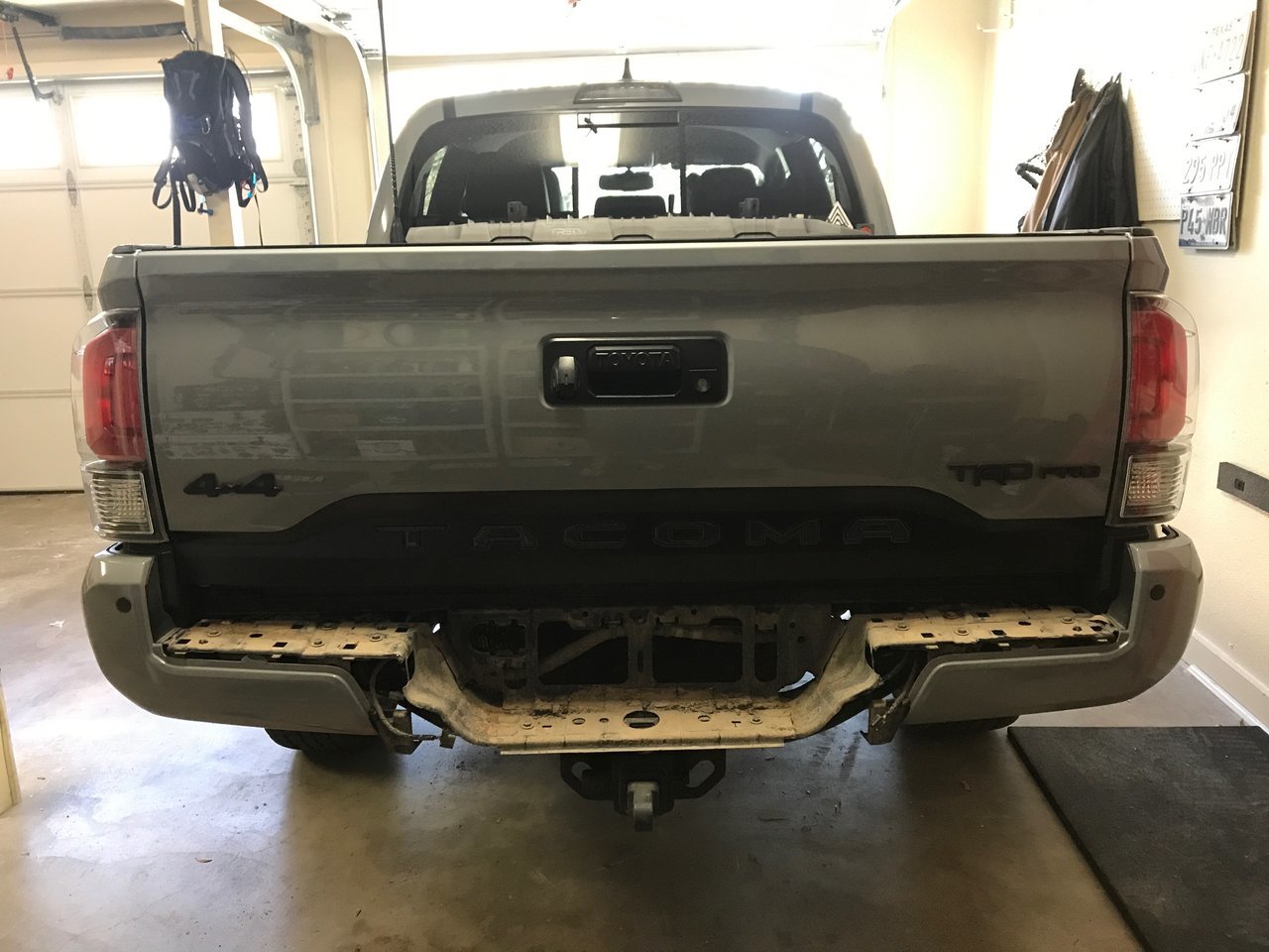

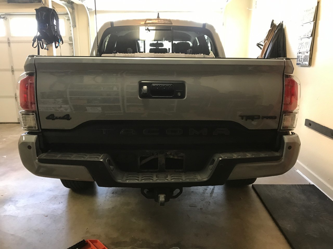

    Breakdown of the factory rear bumper if anyone is interested.

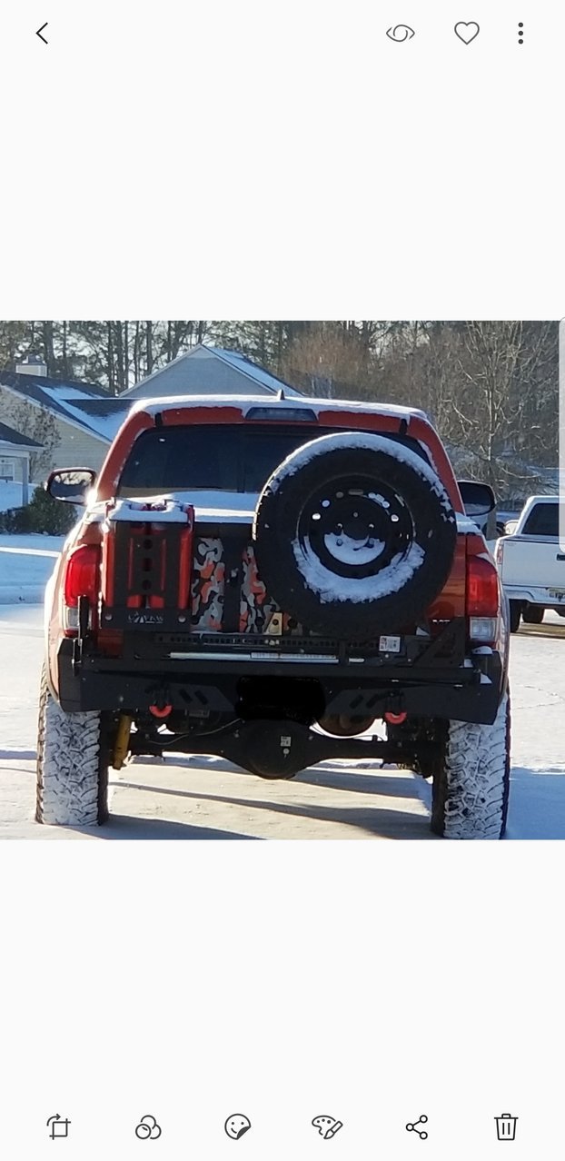

    It would decrease departure angle. I have a c4 and it has a hidden hitch wouldn't have bought it if it didn't.
