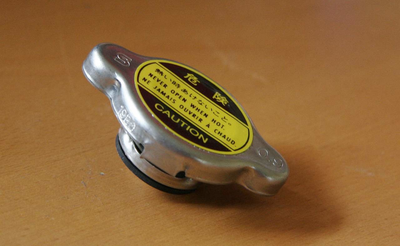

    This cap from Amazon is supposedly OEM, part# verified for my truck. It leaks coolant. The spring bottoms out at about 9 lbs.
    The main reason to replace the other one I have is it's some aftermarket cap, and I saw a bit of coolant residue next to it that may or may not have been there a long time. After the OEM one leaked I replaced my other one back. I noticed it's significantly higher pressure. I wiped down the area good, and it's not leaking after a few drives. Gonna leave it alone.
    Obviously returning this OEM one. Counterfeit you think? A reviewer had the same issue as me.
    https://www.amazon.com/gp/product/B00KTKNJ72/

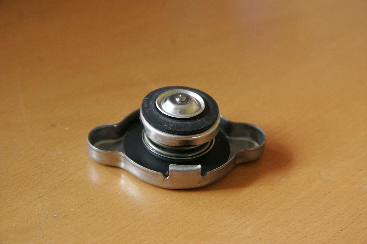

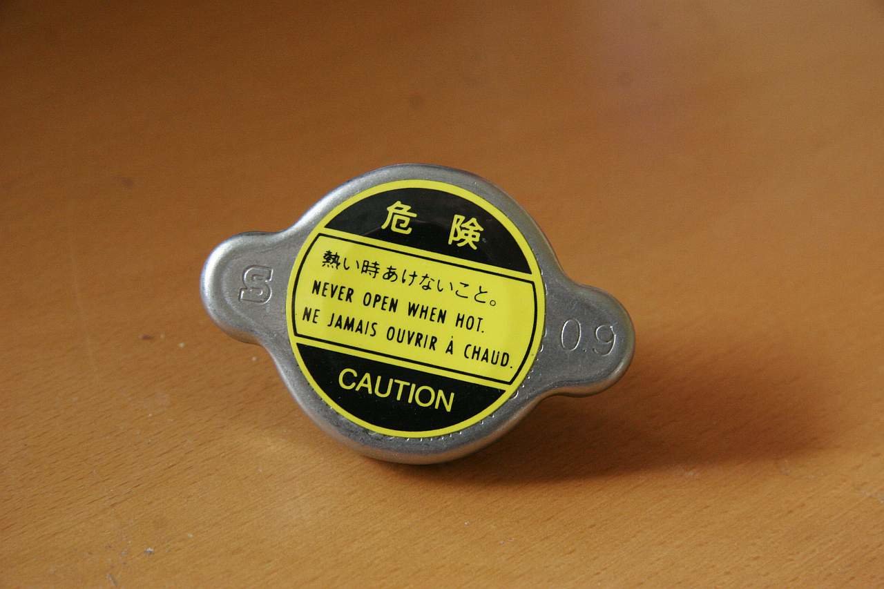

    Does yours have the same markings on the lip (pic 3)?

    Right, I bought from Craig Inc on Amazon. I don't know for sure about the lip marking because I already boxed it up, but I don't remember seeing that 1980 or anything like that.
