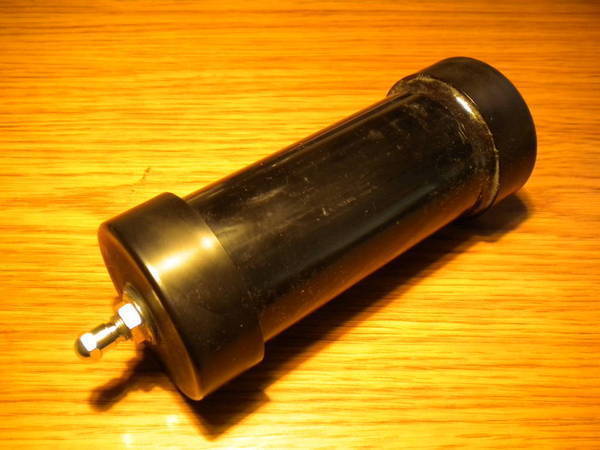

    Got my canister ready to go...:thumbsup:

    Just finished mine again.
    Out with the steel in with the PVC sch. 40
    I used 2 1/2" and one of the sensors out the side instead of the end.
    My truck is back in ballance with the federally mandated universe again.
    Mount location is next, since I used Unistrut to replace my Tacoma rails I will use a set of Unistrut clips to hold it nice and tight.
    Pics later.

    I'd probably just put it in your cargo area. Mine has held for several months but at some point I assume it could start leaking. At least make it easily removable.
