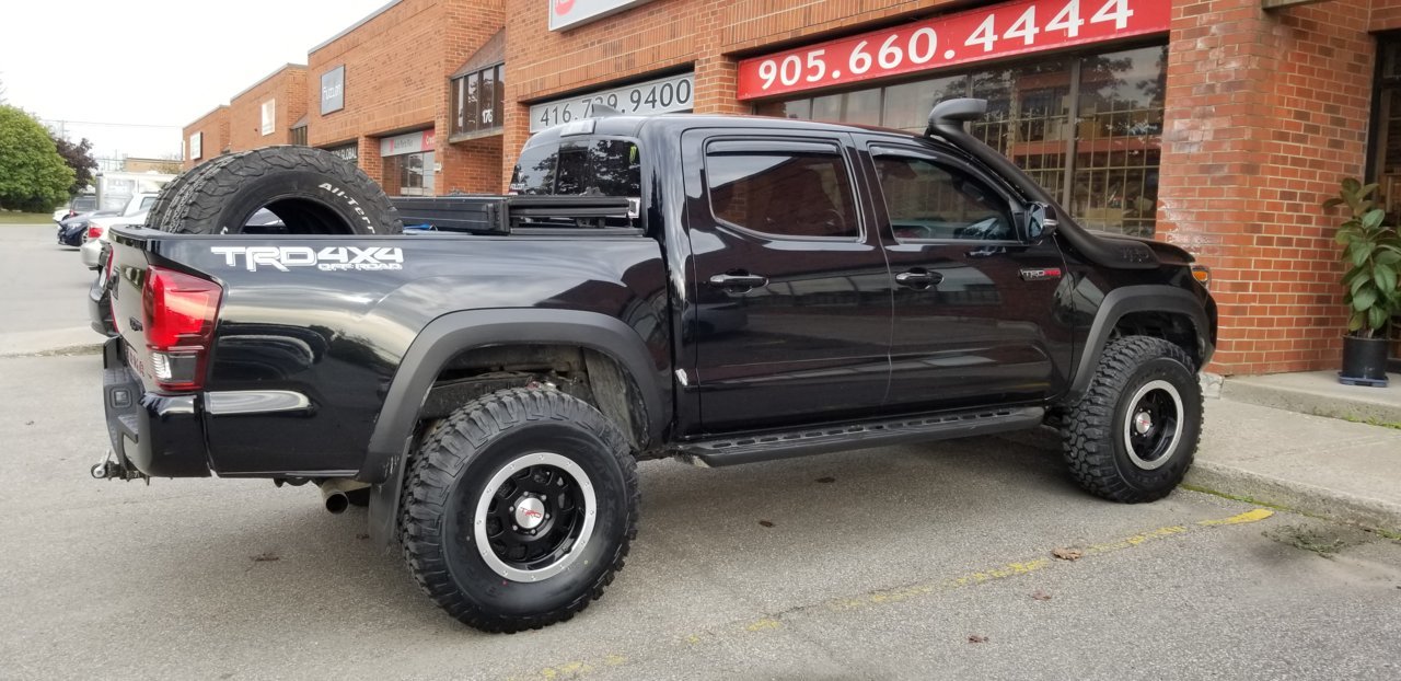

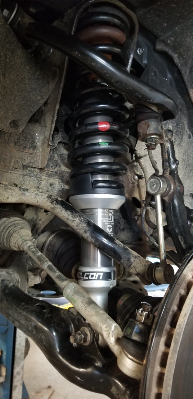

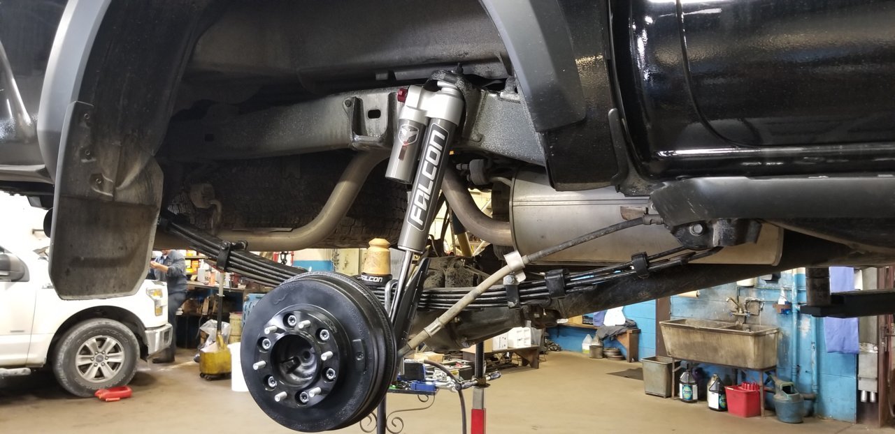

    Falcons are on love them so far Anyone running 33s having rubbing on front 255 85 r16 ?
    TacoPandaTRD, =JSG=, BSCowboy and 2 others like this.

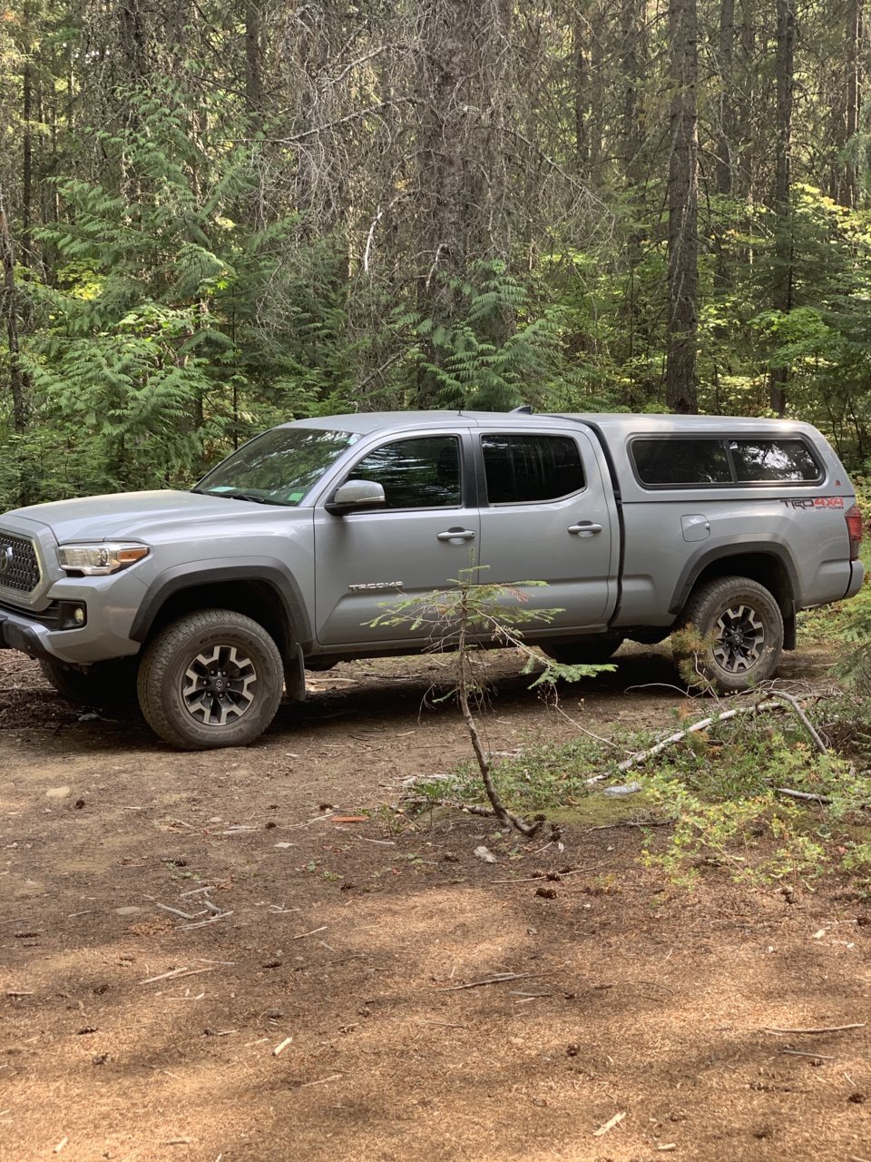

    @BZ4X4
    Here’s a pic with about 700-800lbs of weight in the back. I’m on the middle setting on the rear shocks. I spent the day traveling around NF roads and never had an issue, even with all that weight in the back.
