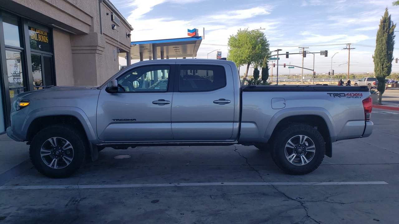

    Recently installed the tow haul kit and the ride is definitely firmer but in a good way! I love the adjustability of the rears I have a sleeping platform built out in the back of the Tacoma and when I have all my camping gear loaded I use the second setting and it rides great. I left the fronts set at level and got about 1.5-1.75” of lift. The rear instead of the blocks I used the icon 3 leaf add a leaf and got about an 1” of lift and the truck sits perfectly level. So far loving the setup great for the price and not breaking the bank.3954BC3B-B8AC-4B0F-A238-EFE58ECFD672.jpgBCBAEDE3-C2C5-4942-93FD-7A57181E3E7B.jpgCDE1CB09-1D14-4881-ACEF-061997C13CA6.jpg37E373AA-40FA-4DDE-9166-C65FBCE1D77D.jpgA00B1F7A-5EC9-4818-BDCA-926AD64525BE.jpg
