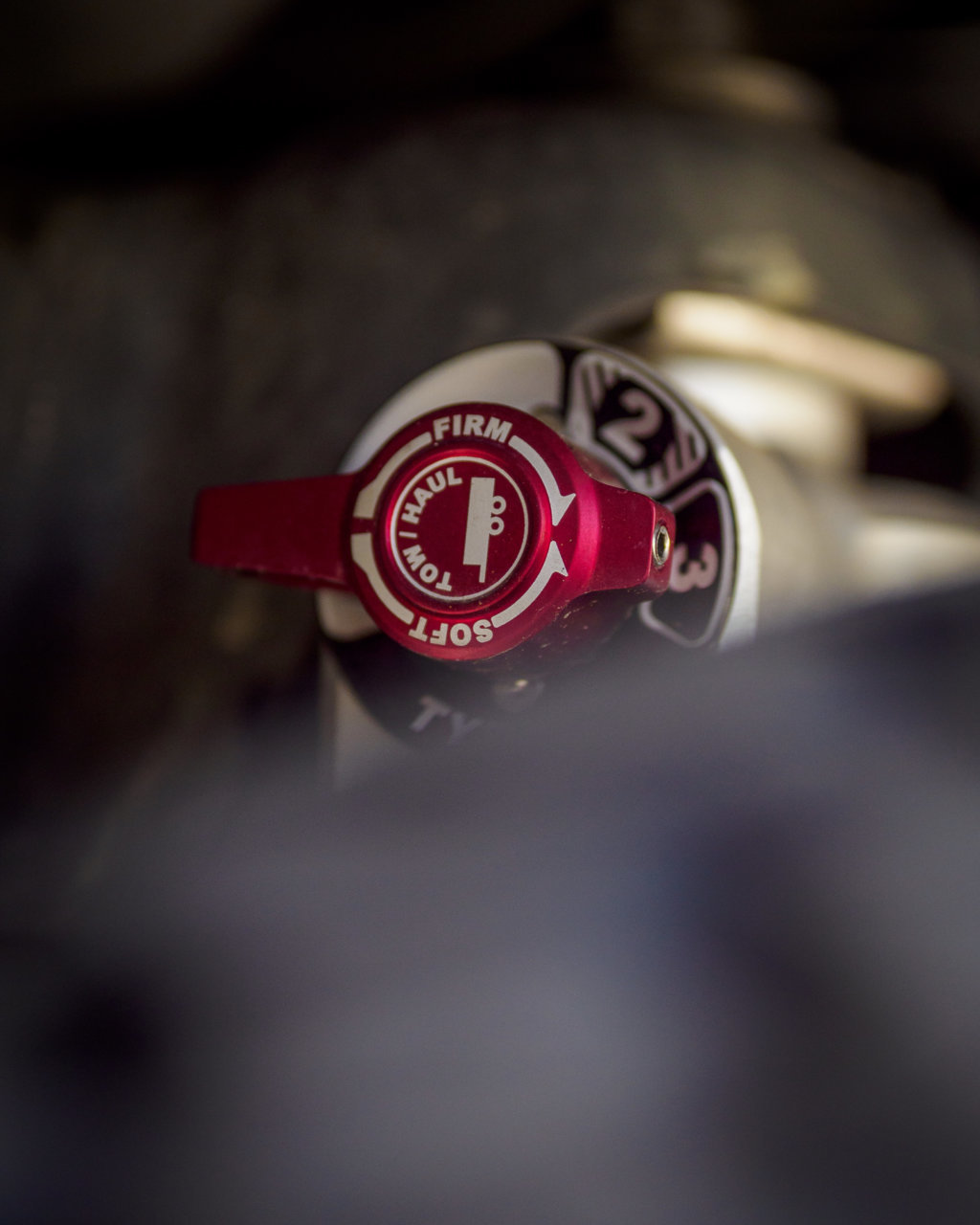

    Experiment with the rear settings in different scenarios. I’ve found it really useful to have that rear adjustability in so many situations. Towing, off road and on road. Sometimes on street I would set it at Medium (with no extra load) and the added firmness really makes handling great. Other times I would be more into setting 1 (comfort and control setting). Enjoy!

    Like everyone else said on road they are definitely firmer but not in a bad way feels more planted. I have a shell on my tuck so with the extra weight my rears feel softer but I have the tow hauls so I can adjust them to the extra weight.

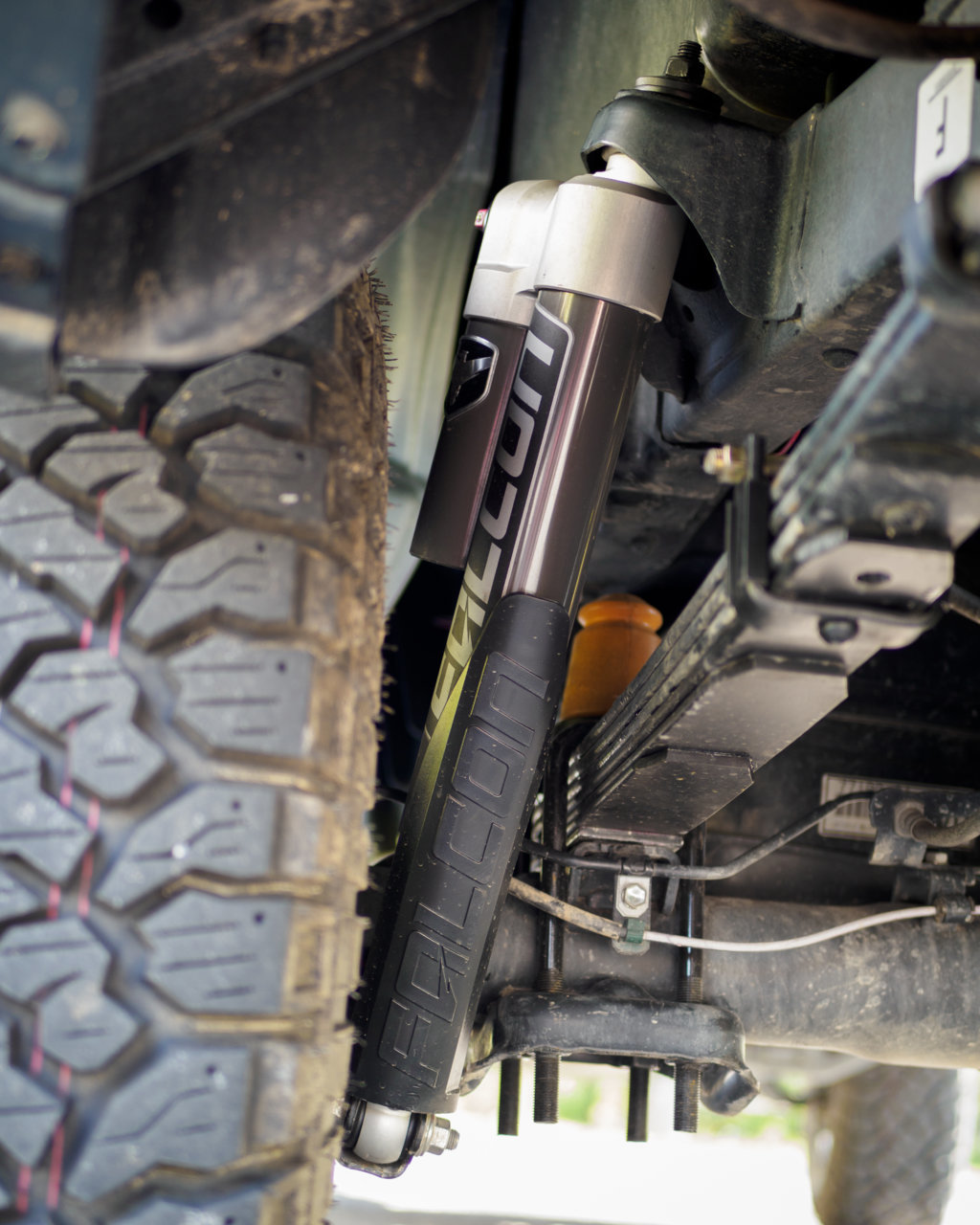

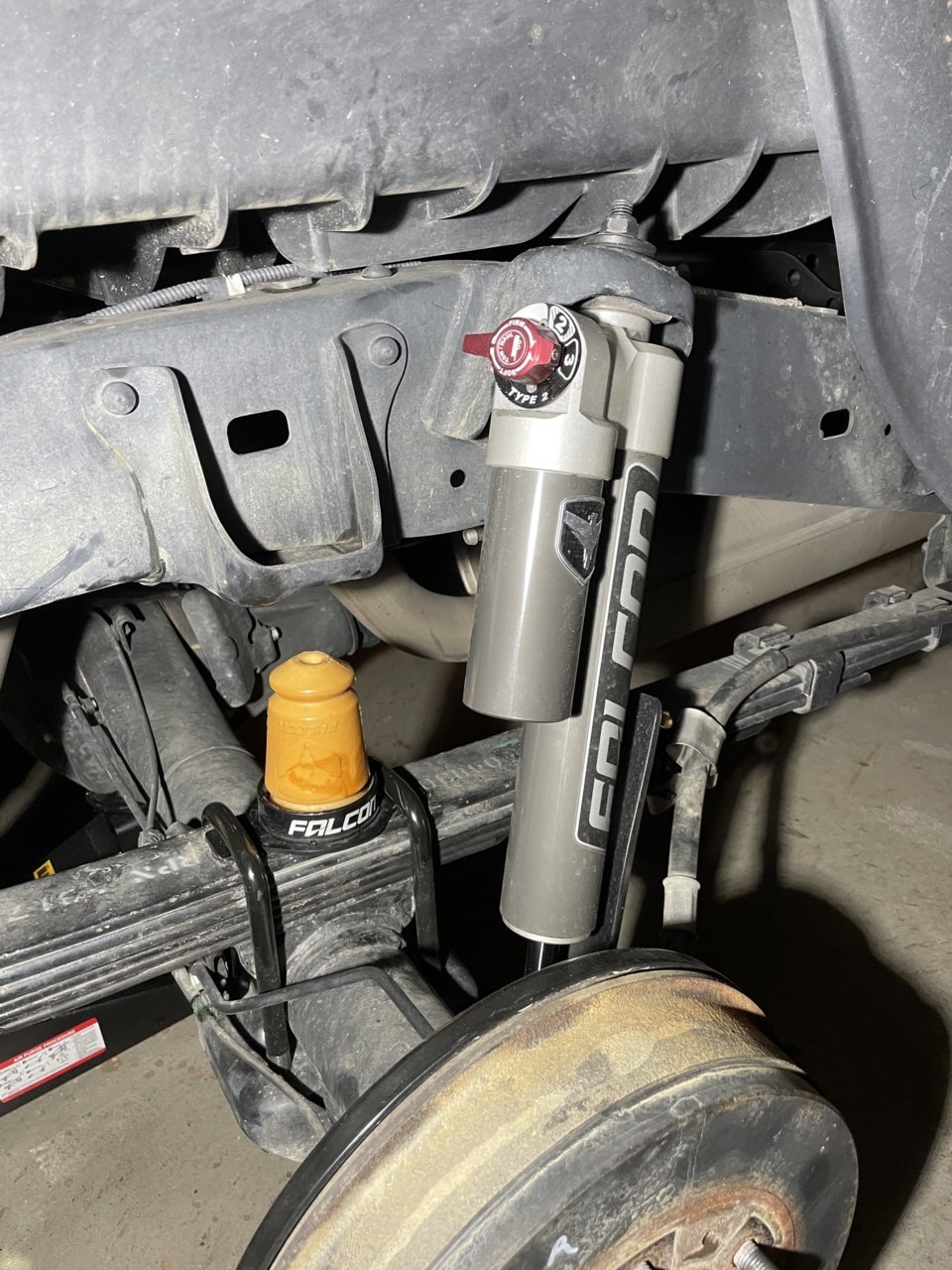

    I just bought the falcon tow haul level lift. They estimate three weeks out. Just making sure, but the rear shocks are longer than the level kit. I’m assuming the front shocks are the same. So to be level I’ll have to use the top heavy load notch and not the level notch?

    No you would still use the level setting. The longer rear shocks will just give you more droop. Use the top setting if you’re running a bumper or winch.

    Ok. I’m not understanding, the rear shock is different because of the lift block. So if the rear is 1.25 inches higher and level on both kits is level then I’m assuming the front shocks are different too? Sorry if I’m being dense. I also don’t want to do the front twice if I can avoid it.

    So the rear are 1.25” longer shocks if you get the tow haul. It does come with 1.25” lift blocks for the rear so when you add those and the level setting in the front the truck should sit even or “level”. If you go to the top setting on the front shocks your front will sit higher than the rear most likely

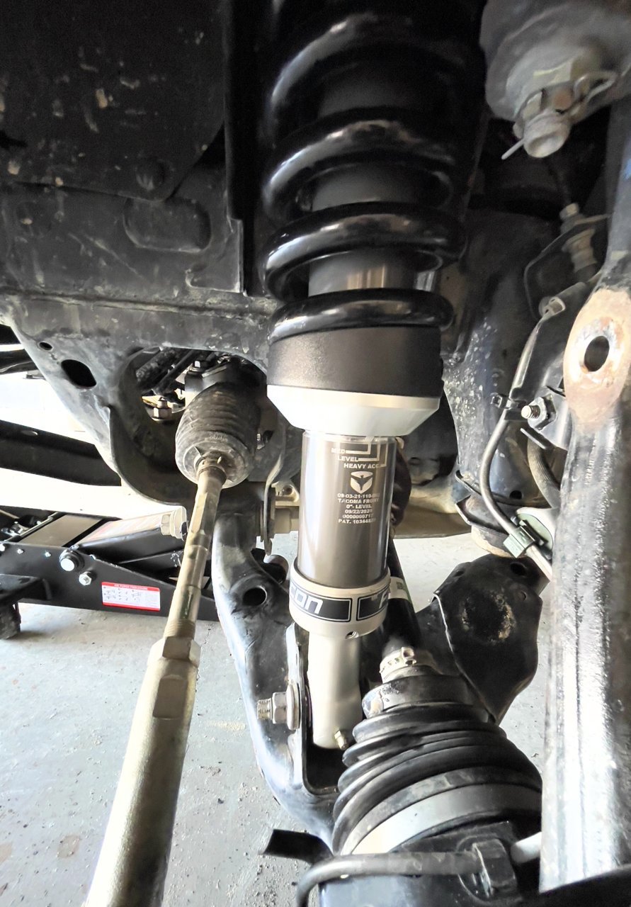

    Vst I skimmed though this thread again. What happened with the top nut on your front shocks? Did you stick with stock coil spring?

    Yes stock coils and I did the install myself. So I messed up on one part you have to keep and re use a metal like washer from the stock shocks and place it on top through the shaft under the top hat on the new shock. If not you can’t tighten down the top nut it will just screw down to the bottom of the threads and not compress the top bushing. If you’re having a shop do the install I’m sure they won’t miss this step it just wasn’t in the directions.
