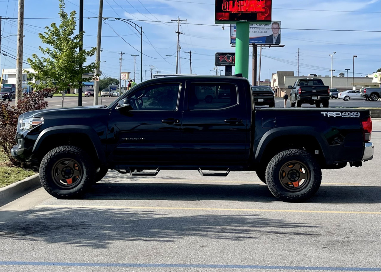

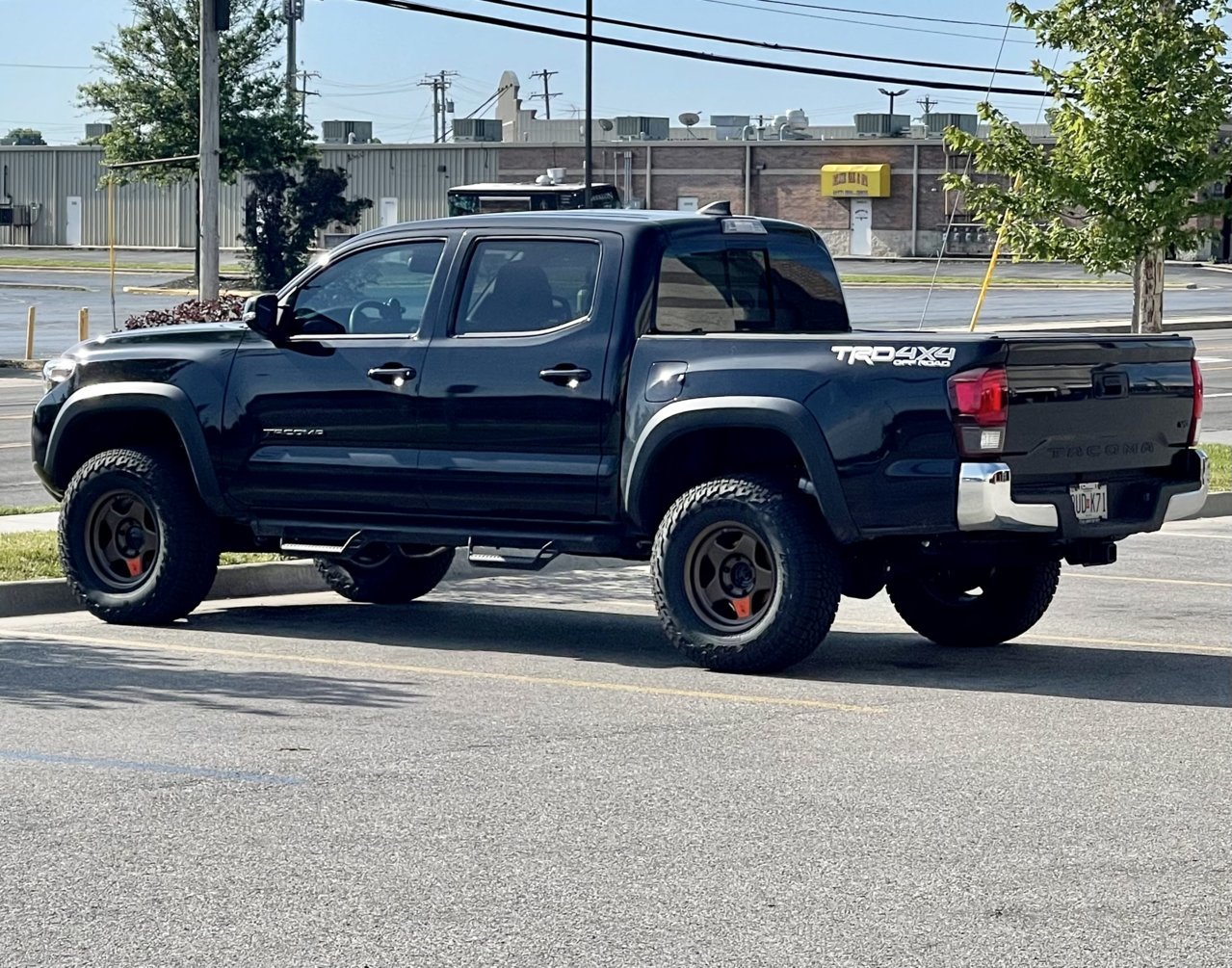

    Got mine installed last night. Getting it aligned now. 2DCA0783-1B87-44E3-8473-8521C56A8A27.jpg922A9097-EC08-4BE5-8CE6-A43A6E25B247.jpg

    nice!
    You’ll like em! I swear mine feel better after a couple thousand miles. These trucks look so much better once they’re leveled in front!
