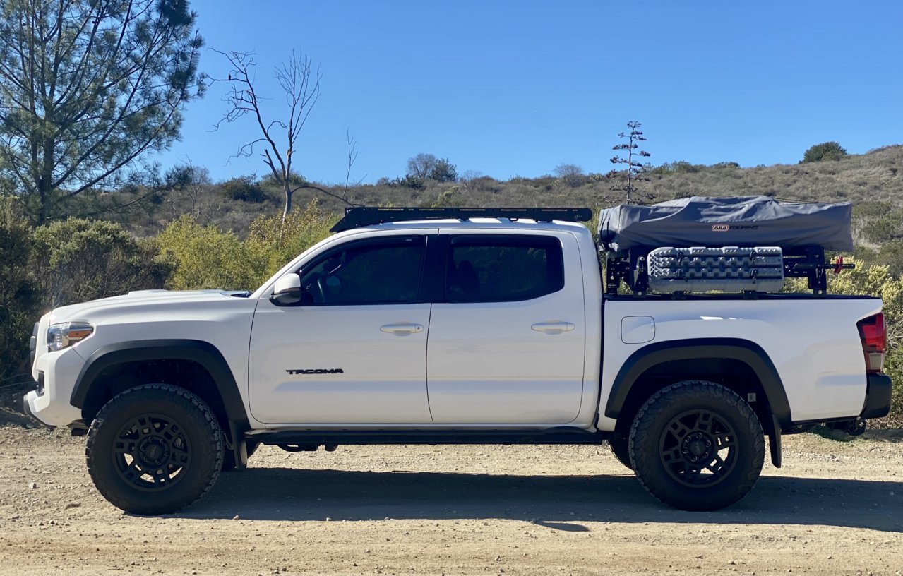

    I used a 1.5” Icon AAL instead of the 1.25 block included in the kit, and I’m happy with how it came out. This is the Sport Tow/Haul version, and I used 1.25 spacers to avoid cutting the rear pocket. I wish I would have taken a good before pic to compare, but this is a huge improvement over the stock setup.
