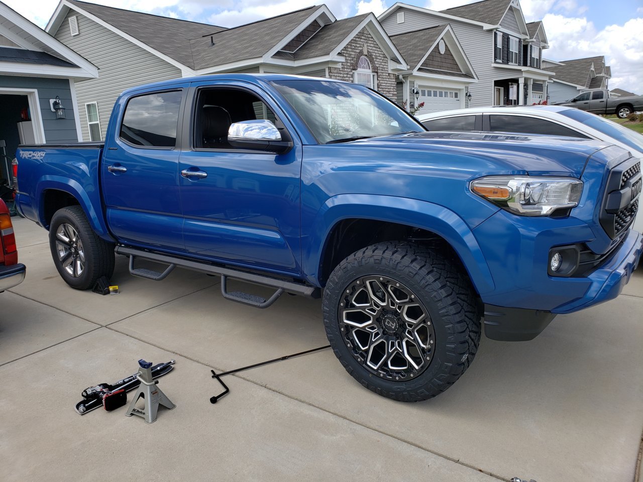

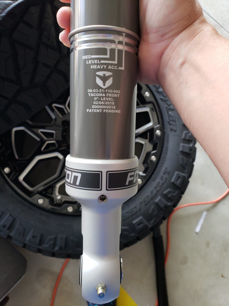

    JAL what I have been told when contacting Falcon Shocks is that Med is around a inch and Level is 2 inches and Heavy Acc is 2 inches with a front bumper or winch setup. I do not have and heavy accessories and was told I should get around 2.25 of a lift. I cant claim this to be true yet because I have not installed them but when I do I will use the heavy acc setup. As far as the OME springs I have no idea if that will work. 20180713_093550.jpg

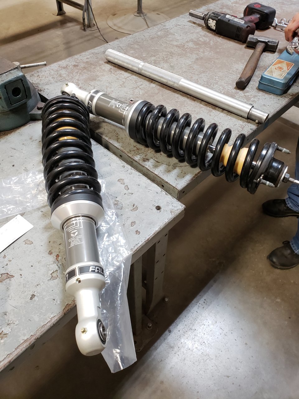

    Just picked up installed today from my local shop San Diego.
    Ride is excellent and I’m fully leveled out. I’ll be heading to the desert this weekend to hit some washes.
    When I spoke to Falcon/ TeraFlex, the gentleman I spoke to said that if I wanted to run 285s, to add a 1” spacer in rear then set the front to the highest setting. He said the taco in their promo video had 285s with the above mentioned block and front setting. He said they did have to trim the front a little but it was very minimal (they used a razor blade from what he told me). Anything more than 1” in the rear over stock wouldn’t have enough travel for these shocks.
    It’s perfect for me because I’m a weekend warrior. Not in the market for a full blown system at this point. I want a better ride, larger tires and more confidence pushing my DD on trails.
    Just to round out this quick overview, for right around $2K you can be fully leveled with another 1” of lift in the tank if you choose. It’s a better ride and I’m anticipating great comfort and confidence on the trails and camping trips I’ll be taking.
    These pics are just so everyone can see them installed. I’ll get better ones up soon.

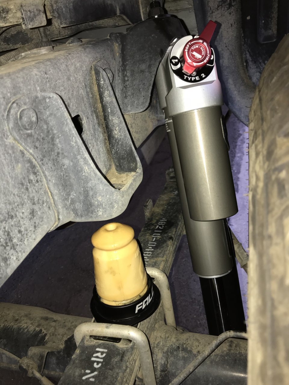

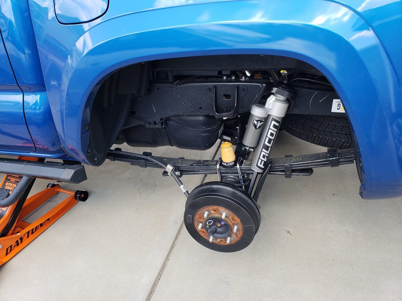

    Got the rears done waiting on the Taco lean spacer before I do the front.

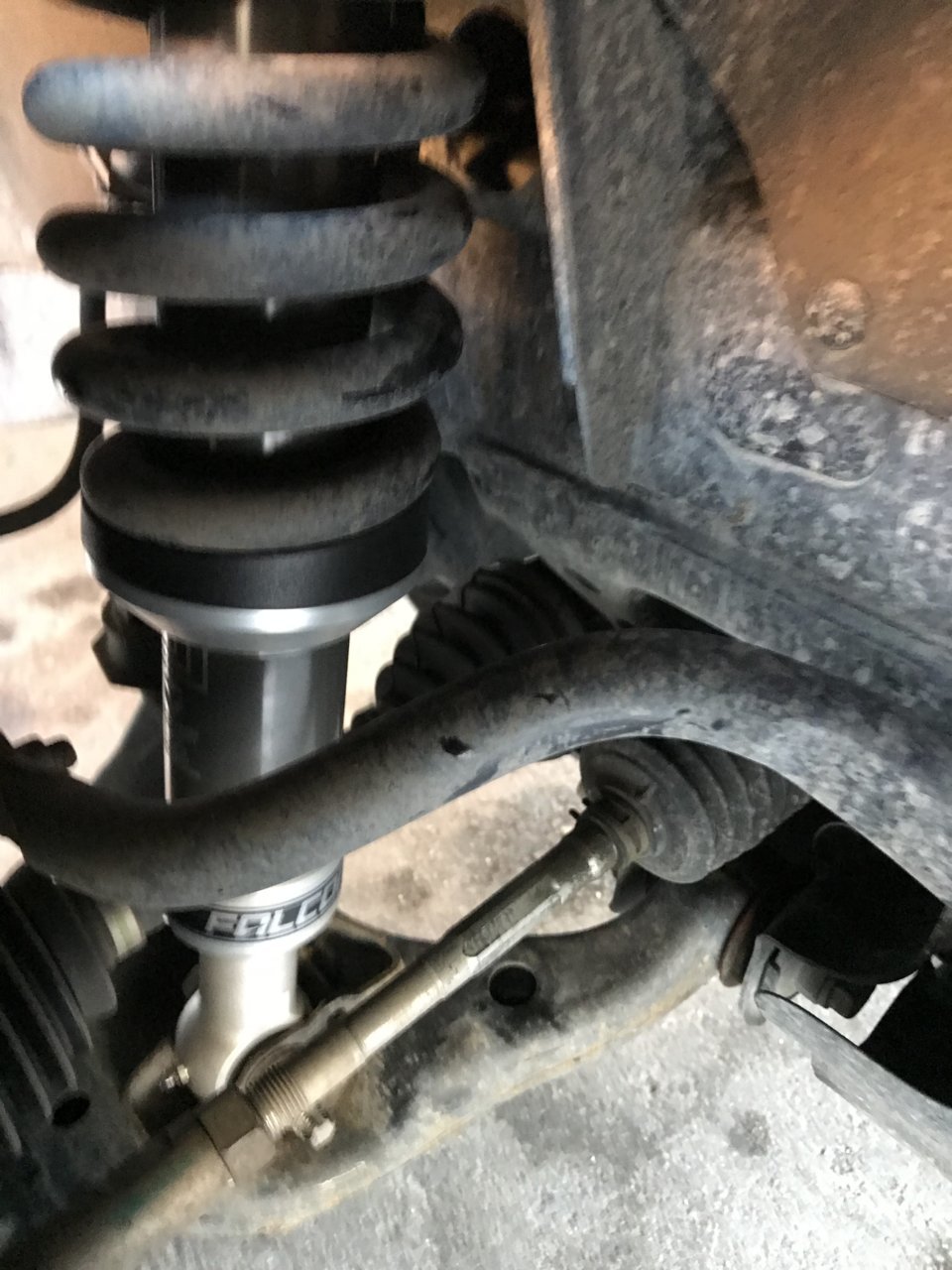

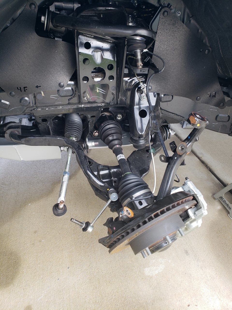

    Got to the front this morning before work hopefully finish it up tomorrow. Was easy to take things apart since it only has 1k miles..

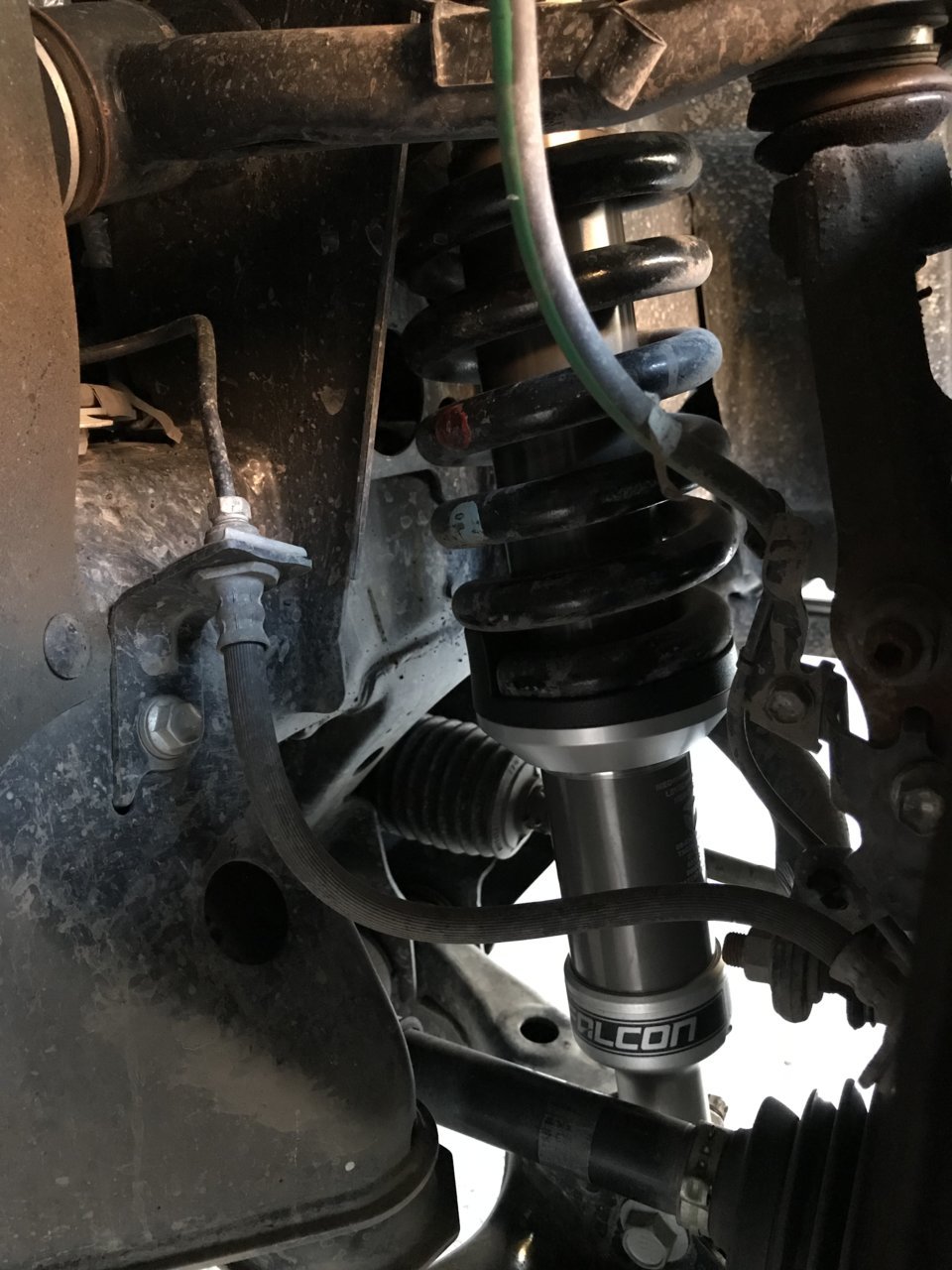

    Getting there..

    Did you put the shock on backwards? The shin guard isn't doing much facing the rear, and the resi should face the rear as well. Unless this is a design thing? I could be wrong.
