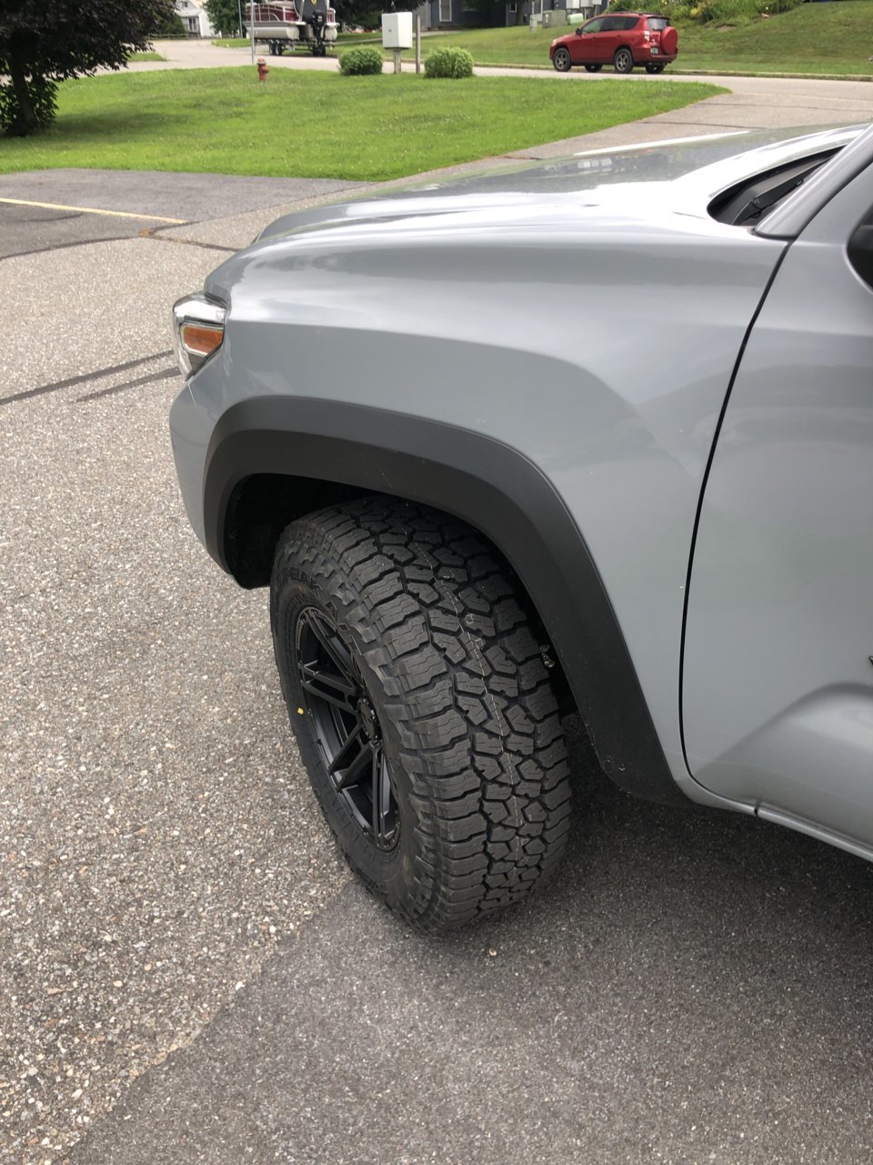

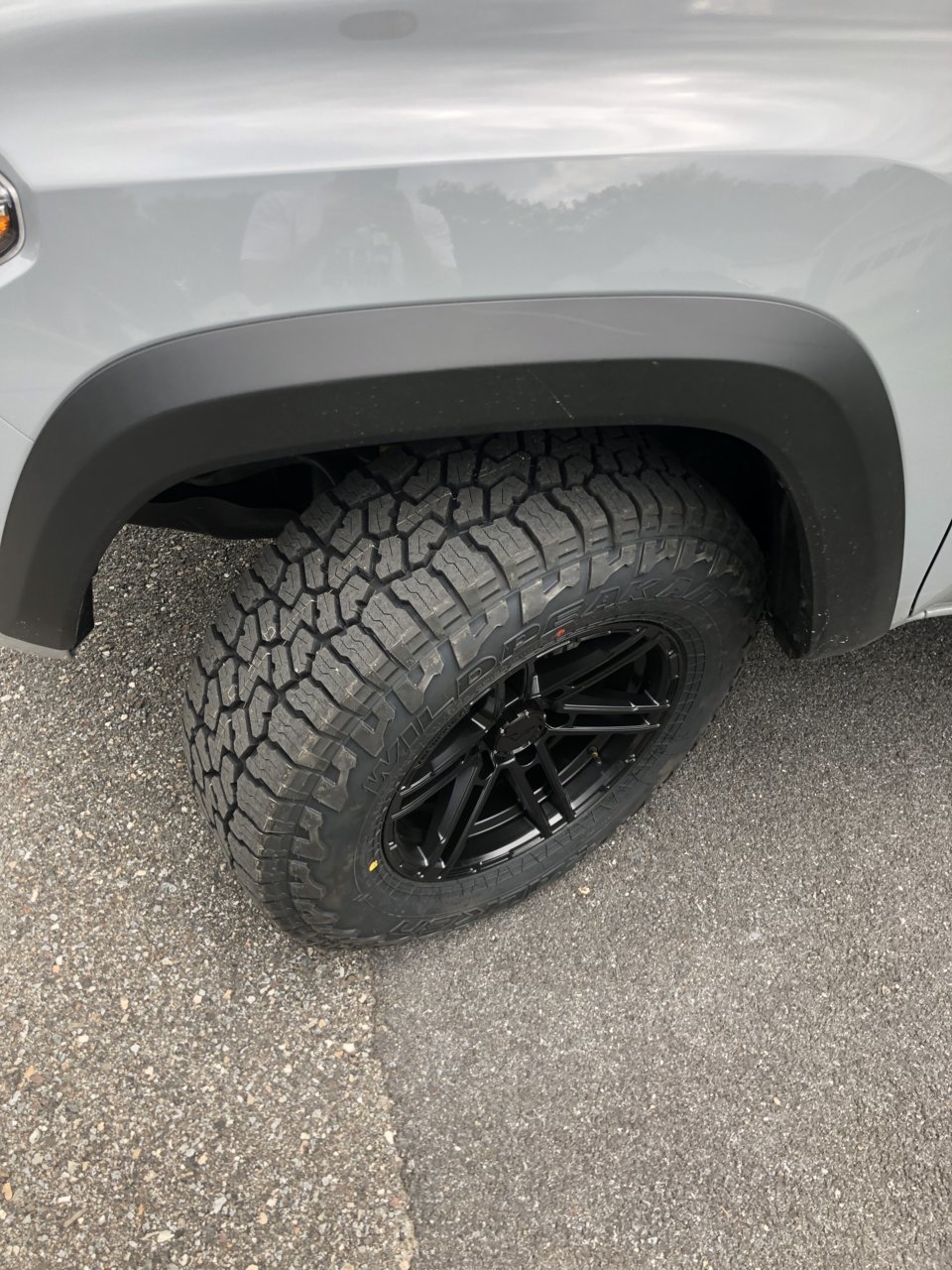

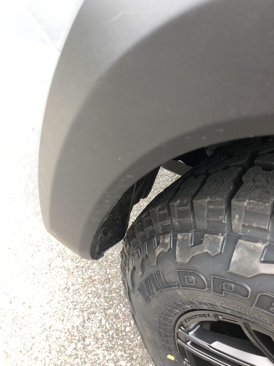

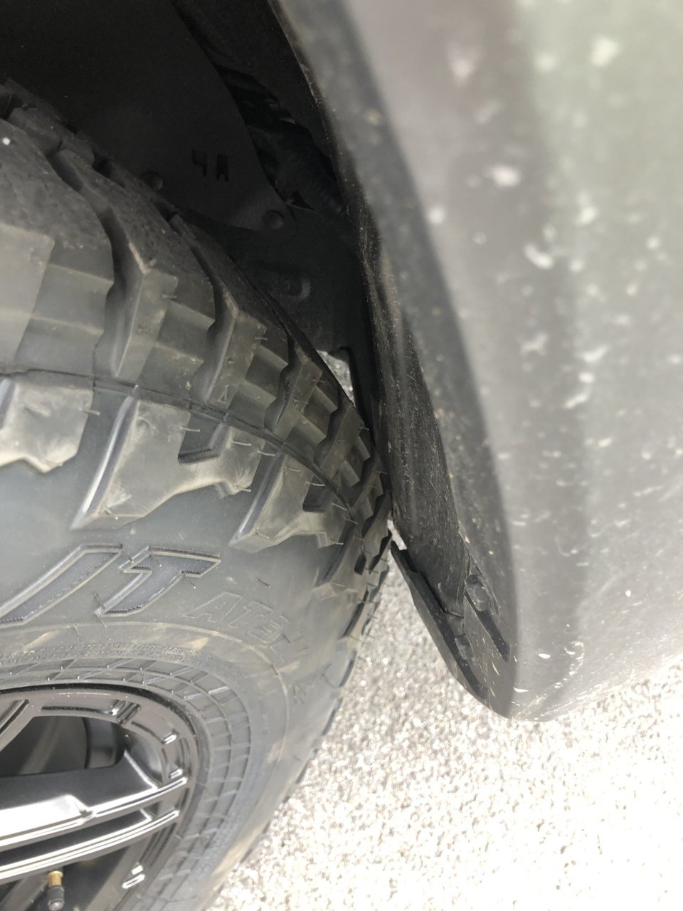

    Thanks for the replies everyone. Here are some photos.

    A heat gun will solve that issue.

    Thanks for the suggestion. Yea it's pretty minor but a bummer when I was expecting to have no issue.
