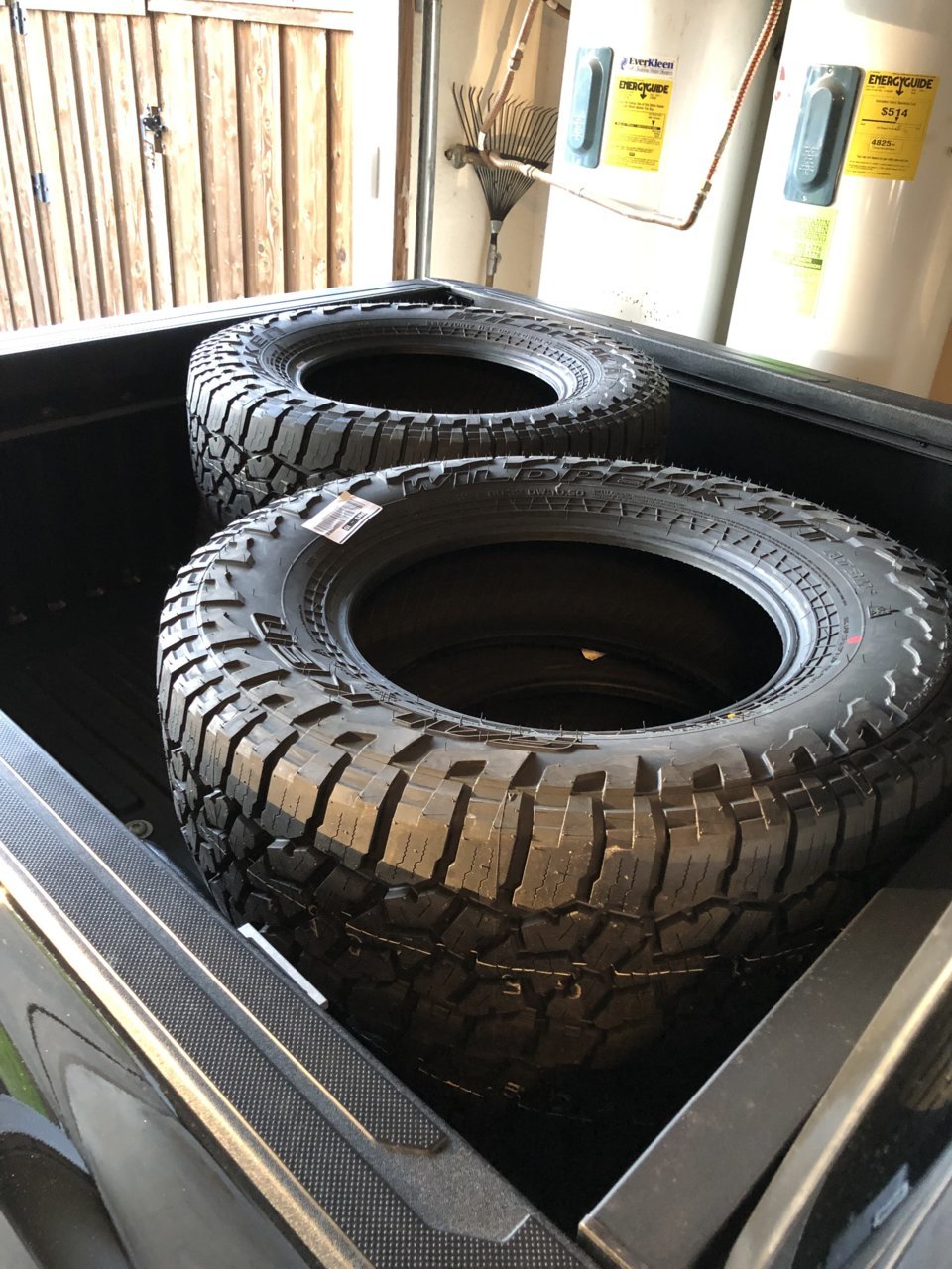

    Guess I’ll find out tomorrow:
    3-E3-AD30-C-FA79-4-FF9-B912-32557-ACACDD_9d48c47c4d51b87c6b85bcfbded331c29e673d57.jpg

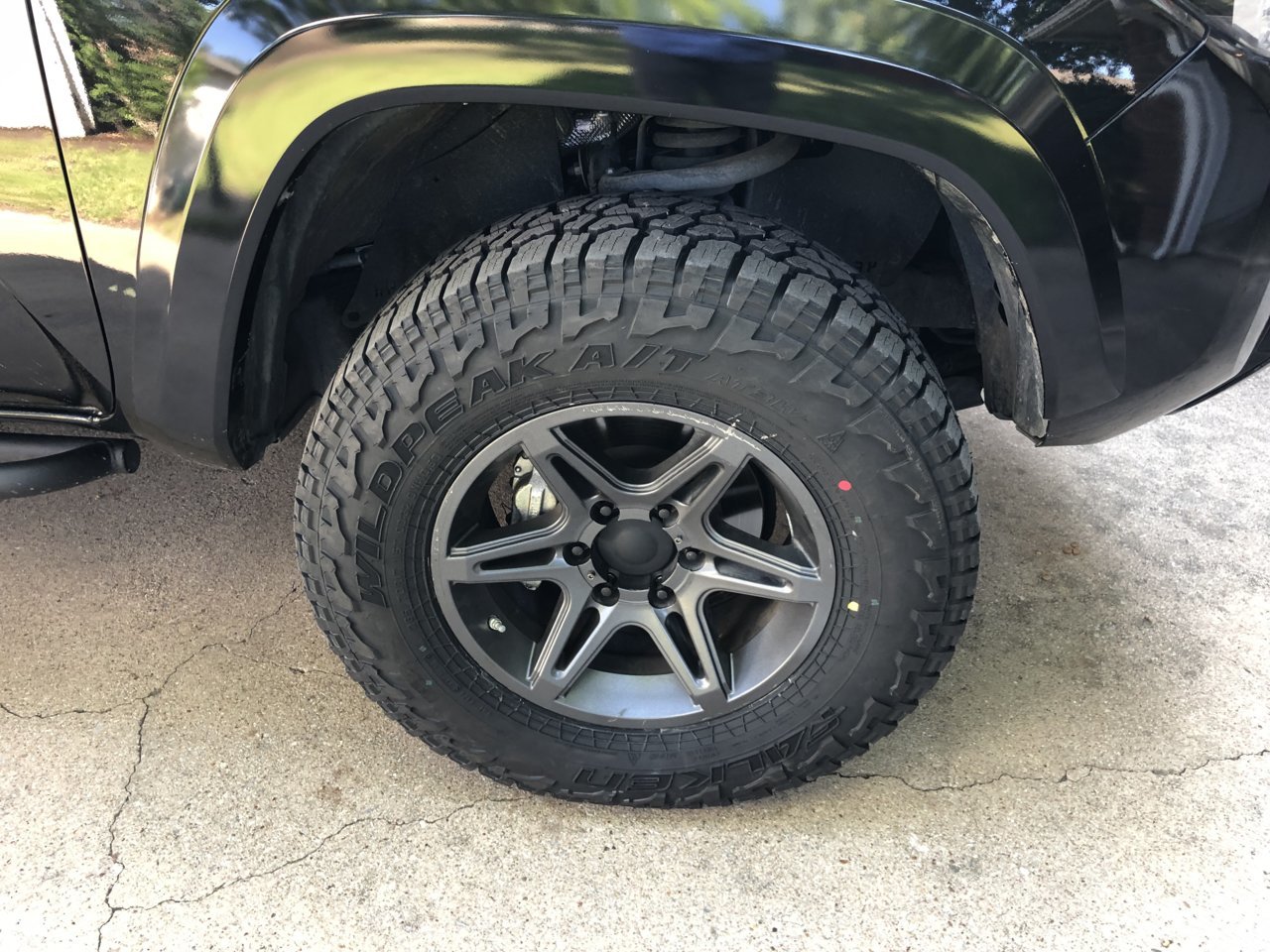

    So I just mounted a set of 265/70/17 Wildpeaks on my 2018 Sport 4x4. No lift, running 17” T-Force wheels with a +18 offset (compared to a +30 stock Sport wheel offset).
    No rubbing at all, even with the wheel cranked left and right. I will say that I removed my mudflaps some time ago.
    Looks great, zero issues:
    6-DA9-B766-75-D2-48-F7-9-B60-E0143-FCD6-_2aaa62f93f1a5db318f6758cc7e8e05d2df6853e.jpg

  15. Jul 25, 2019 at 9:10 AM
    #35
    johnnyroid
    johnnyroid Well-Known Member
    Mar 26, 2017
    #214424
    1,780
    John
    Vine Grove (Fort Knox) Kentucky
    2017 Black Tacoma Sport TRD
    Looks good, all that worrying for nothing.....;-)
