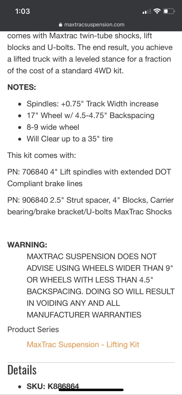

    The reason your rubbing is probably due to incompatible wheel spec.

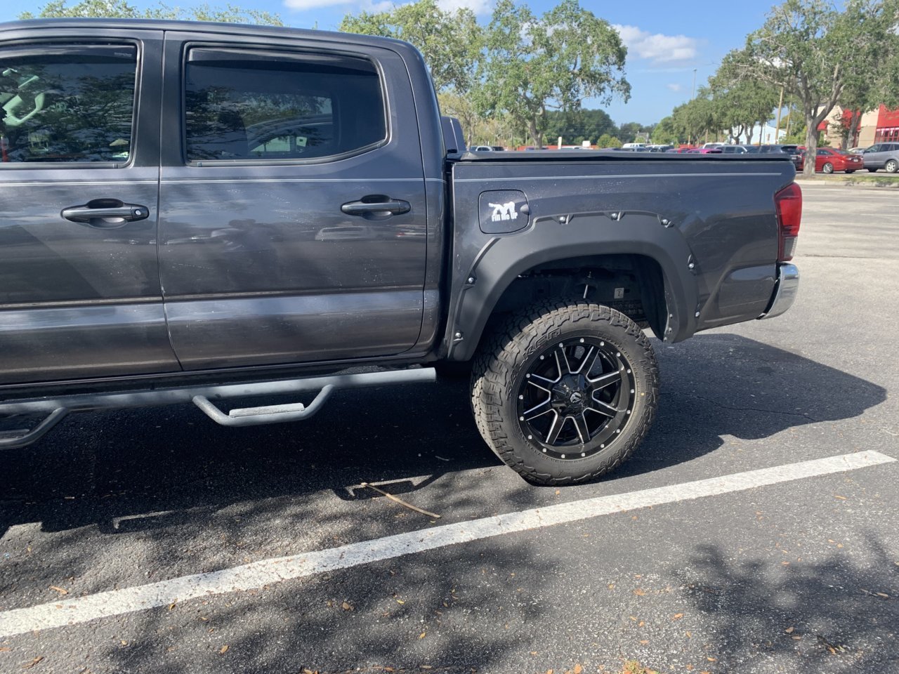

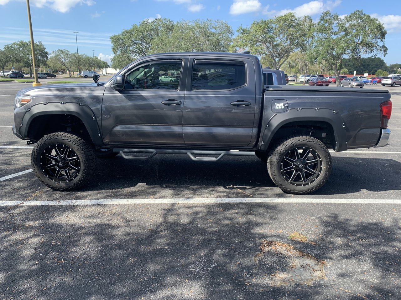

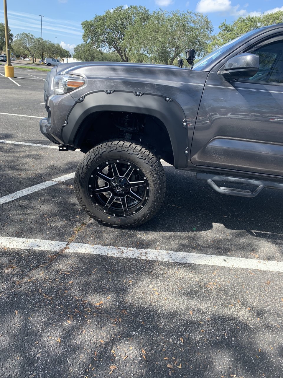

    When soinf a full turn or u turn the front left and right hits the back and rubs on the spindle

    I would install 1.25" spidertrax spacers and call it a day.

    Wheel spacers, bro

    OP what size wheels are those, like 20s?
    Also, can I see a picture of the 4" block I have never heard of that before
