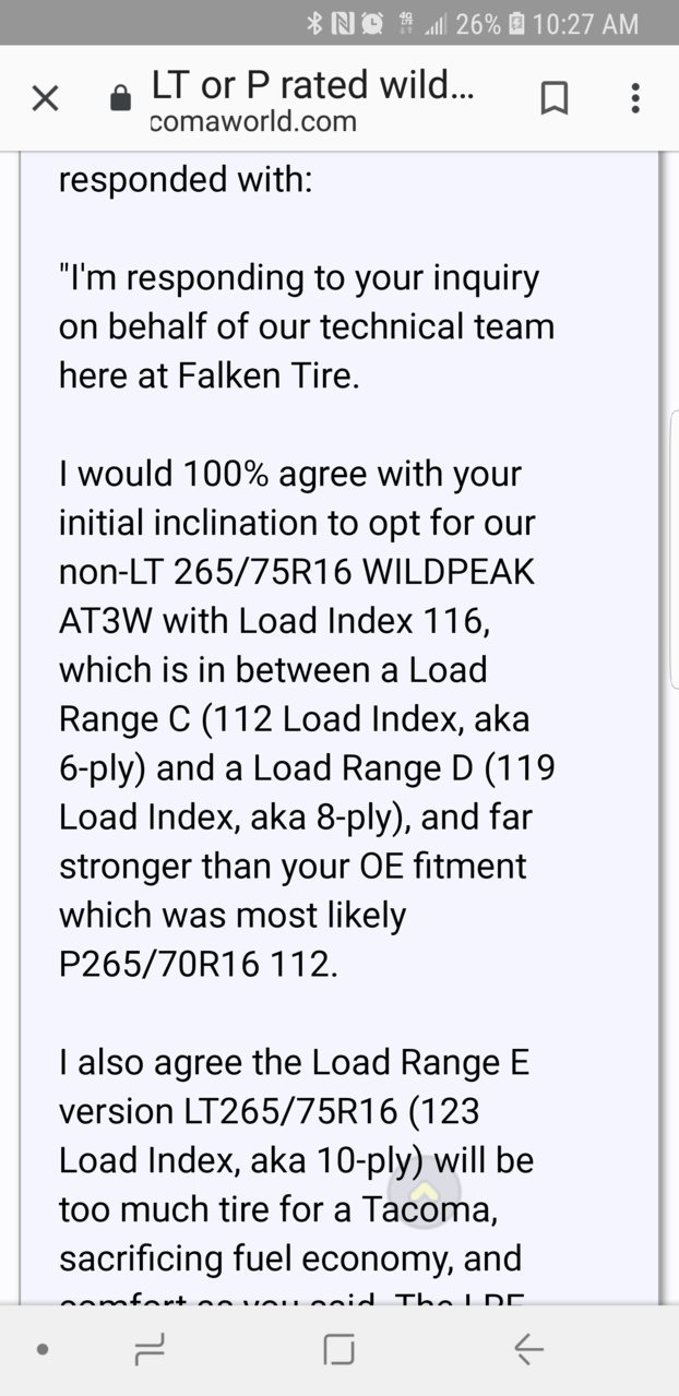

    From the Falken Rep. I have 265/75/16 stock suspension, NO RUB AT ALL! Not even close 16x8 +10 offset 4.5" BS...... I have aired down to 21psi with lots of luck...have 4x4 7-8 rated trails and these are the toughest NON-LT tire i have ever ran...if you are going to hard 4x4...get the LT's...camping, FR. Overland stuff...P265/75/16 fit the bill!
    Oh and the same size tire in LT and P, there is an 11lb difference between the two! thats huge, choose wisely!
