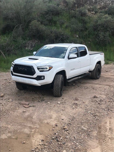

    When I first put them on they rubbed pretty hard in turns. Took the mud flaps off and they still rubbed rearward on the inner fender. Also rubbed on the air dam so I trimmed the corners off of that. A lot of guys hate that thing and just take it off completely. Then I put 2" spacers on the front coilovers and that solved the problem completely until I put the mudflaps back on. Now they just hit the mudflaps a little when hitting the bump turning in to driveways. I can live with that. You could just remove the mudflaps. I went with the 2" lift because I didn't want to start chopping things up. I also added 1.5" blocks on the rear springs just to level it out. I'm happy with that. I don;t do any aggressive offroading, so the spacers work okay for me. I'm convinced that the -10 offset is what caused all the rubbing. Many on here have run that size tire on the stock wheels with no rubbing at all.But I wanted a little more stick out and I'm happy with the look

    Thanks for the info.
    yeah, my OR doesn’t have an air dam, so at least I don’t have to worry about rubbing that. I do like the -10 look and love the SCS BR6. I want to do that wheel, so I guess I’ll just watch out for rubbing and try to identify where with marks from the tires and then shave them off with a dremel or something similar. Mud flaps will definitely have to go.
    nice ride!
