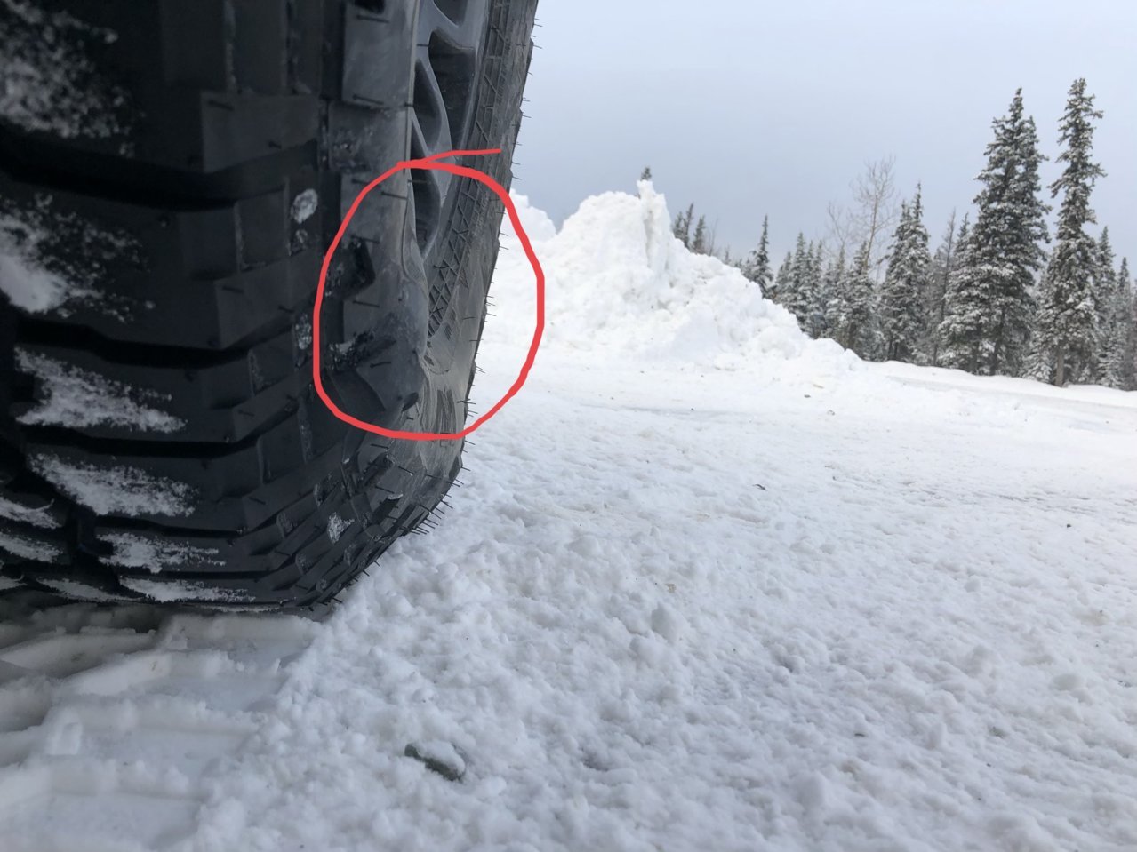

    Anyone experience this? Had mine for about a month now, and today was the first time I went off-roading. Nothing crazy, just mild trails. Does warranty cover this?

    Still holding air? Just the bulge? I think it should be covered.

    Yeah, still holding air. Just hate that it takes several days to get anything in Alaska. Thanks!!

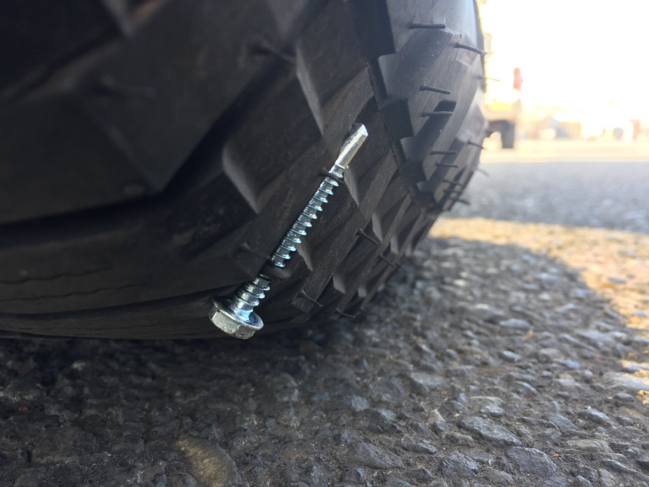

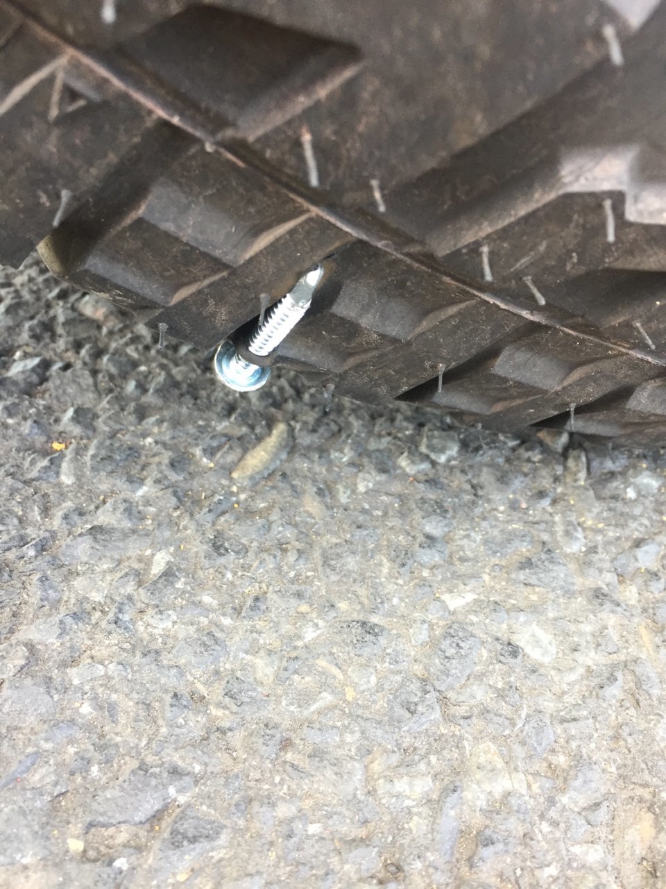

    Lucky Falken
    Screwed but not screwed.
    My wife noticed this on the left rear when walking back towards the truck in a parking lot a couple of months ago.

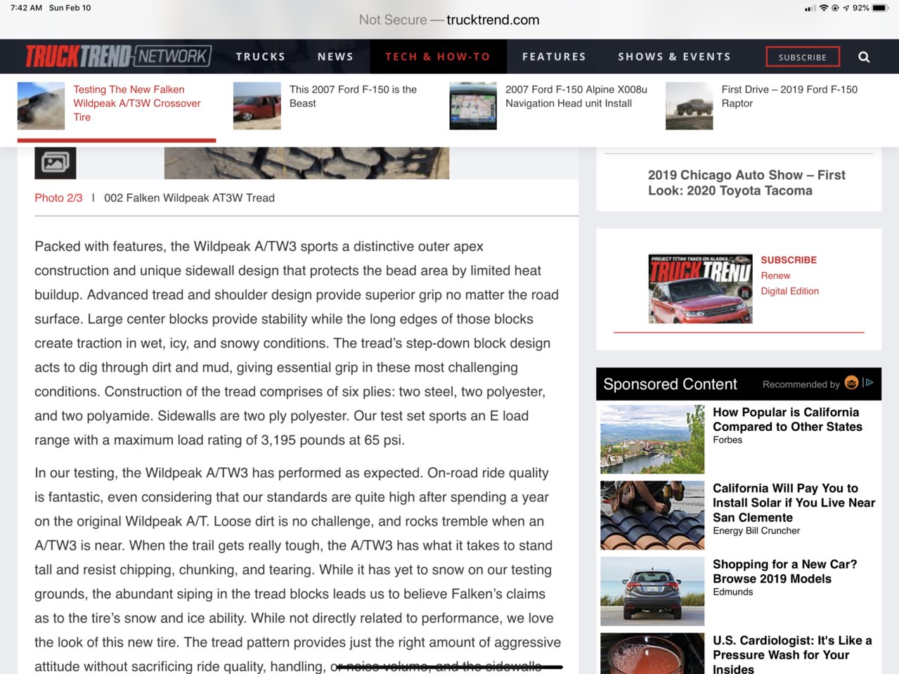

    Crappy sidewalls. Go BFG, they have 3 ply sidewalls.

    There are 3 plys and a apex in the sidewall of the AT3

    Are you sure...check again...They have a crappy 2 ply sidewall which is fine if you don’t off-road.

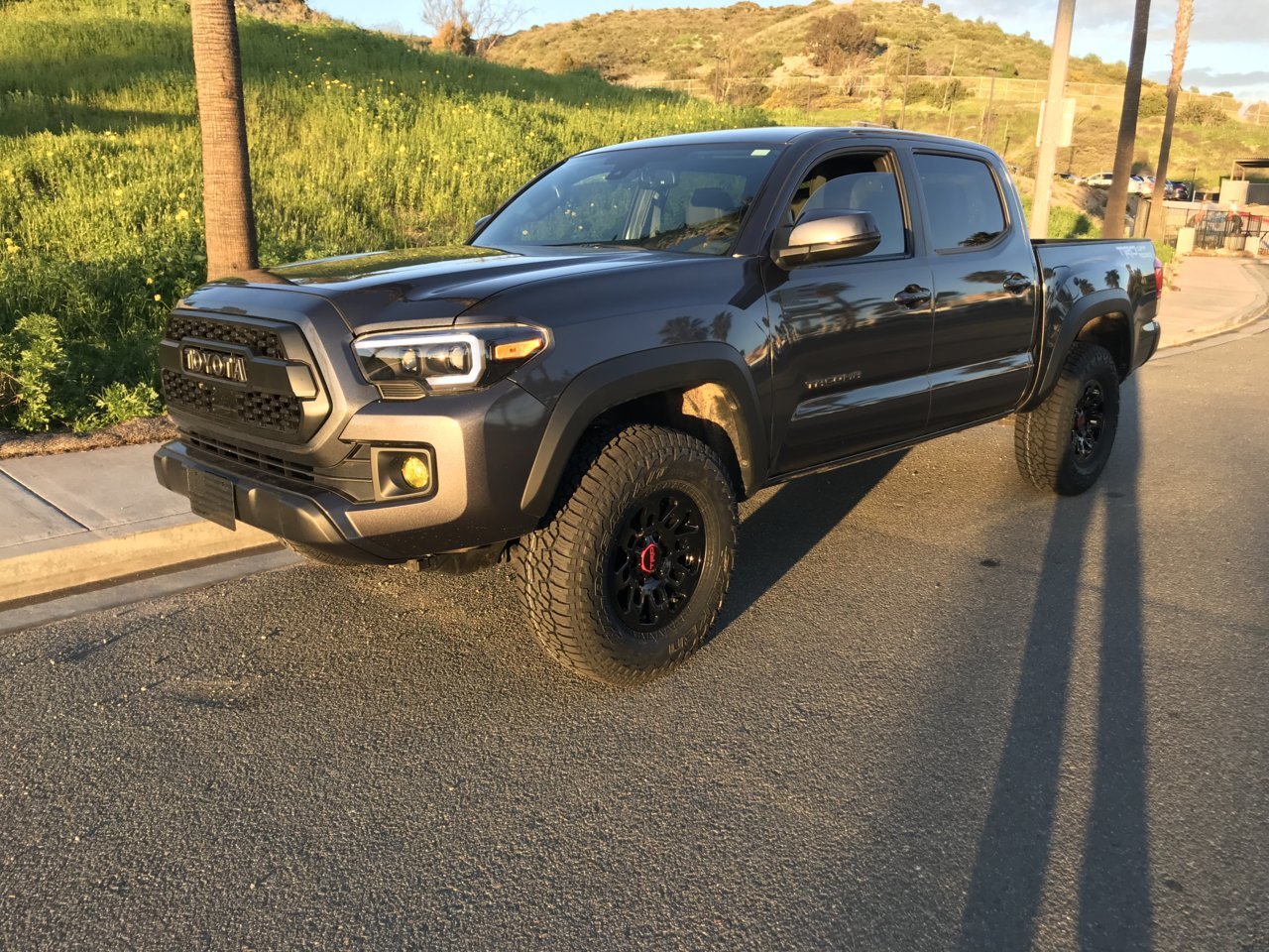

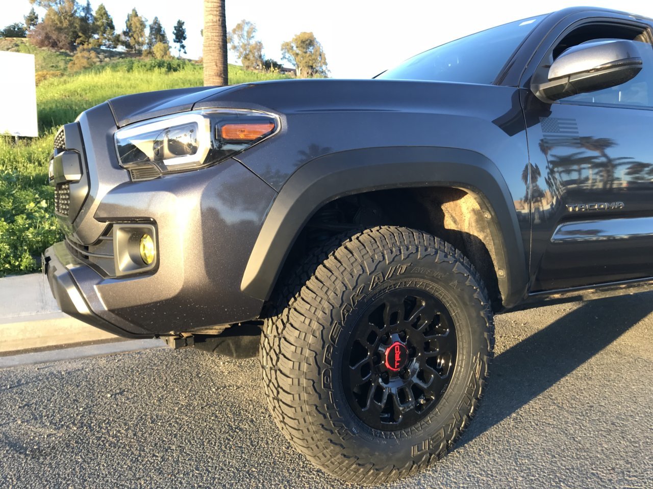

    Whats your setup?

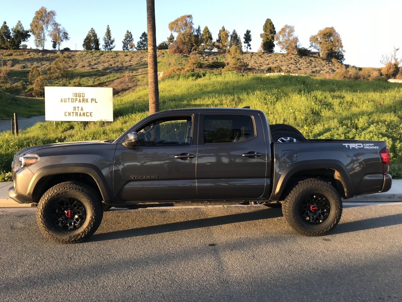

    100% Stock suspension with the 265/75/16 AT3’s and Tacoma TRD Pro wheels

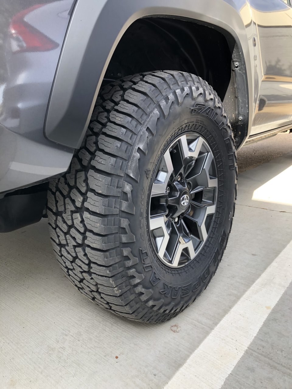

    These always look killer on the OR wheel!

    It says the SL’s are 4 ply so that’s probably 2 plys and 2 breakers so you are probably right. I’ve seen some of the wildpeak carcasses here in the plant. Not having the spec sheet I can’t tell you what is what so the ones I’ve seen must of been XL or C. I’m not real familiar with them. I work in the Moto department and majority of them have 3 ply sidewalls. So I guess I just assumed all those carcasses had atleast a 3 ply construction. Then again, the construction is different.
    Edit: just seen your attachment. If that’s the case for the standard construction that 3rd ply should be considered part of the sidewall as it will wrap over the apex. Unless it’s a floater. I’m gonna have to talk to a builder down there and see if I can see a carcass

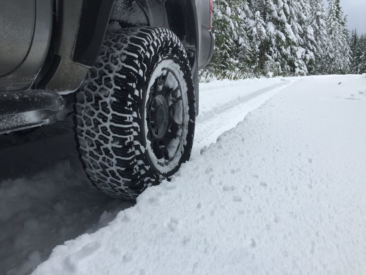

    265/70/17 (basically same as 265/75/16)
