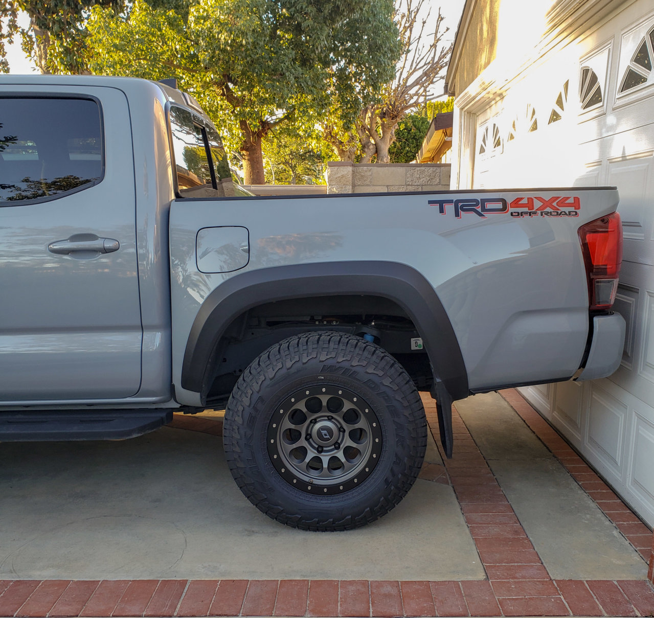

    2018 Cement Tacoma TRD Off-Road
    A little in the front which required the Mud flaps to be removed. Sometimes, also, there's a slight rubbing sound that comes when the nose is facing down on a high incline, but nothing crazy for daily driving. I'm def going to get this thing lifted soon though.
    Hmm I don't plan on lifting for a while, maybe I'll just go with 265/70r16's for now then? Have you regretted not going down in size?
    Absolutely not, for 98% of the driving I do, no problems with any rubbing once those front mud flaps were taken off. In the extremely rare instance that the truck is facing down in a steep incline, it'll barely rub and go away once the incline levels out. I'm very happy with the Falken 265/75/16s, couldn't ask for a better tire. My plans are since the back tires fit perfectly, I'll maybe do a leveling kit to add a few inches in the front till I save up and get better shocks. Hope that helps!

    I have the same color truck and am drooling over the picture. Was the suspension stock when this was taken? Any rubbing with the setup?

    You won't rub with 265/75r16 no lift

    Is that true regardless of offset? I was curious about this particular wheel and tire setup.

    2017 Tacoma TRD 4x4 Offroad
    Plasti Dip Grille and Emblems Removed V6 badge
    Stock offroad wheels are 16x7 +25 offset wrapped with 32" won't rub.
    I have 16x8 0 offset I still didn't rub but I was pushing it already.
    If you are thinking to go -5 to -10 16x8 or 17x8- 17x8.5 you might need to trim the plastic lower fenders...

    Ok. Thanks! Just realized you were still running the OEM Wranglers in that pic. Wow! What a difference the change in offset made. Has me thinking I'm going to get wheels before tires. Its occurring to me I'm more interested in a slightly wider stance than having more aggressive tires. I don't think I'd go with anymore than your 0 offset though. That looks perfect IMO.
