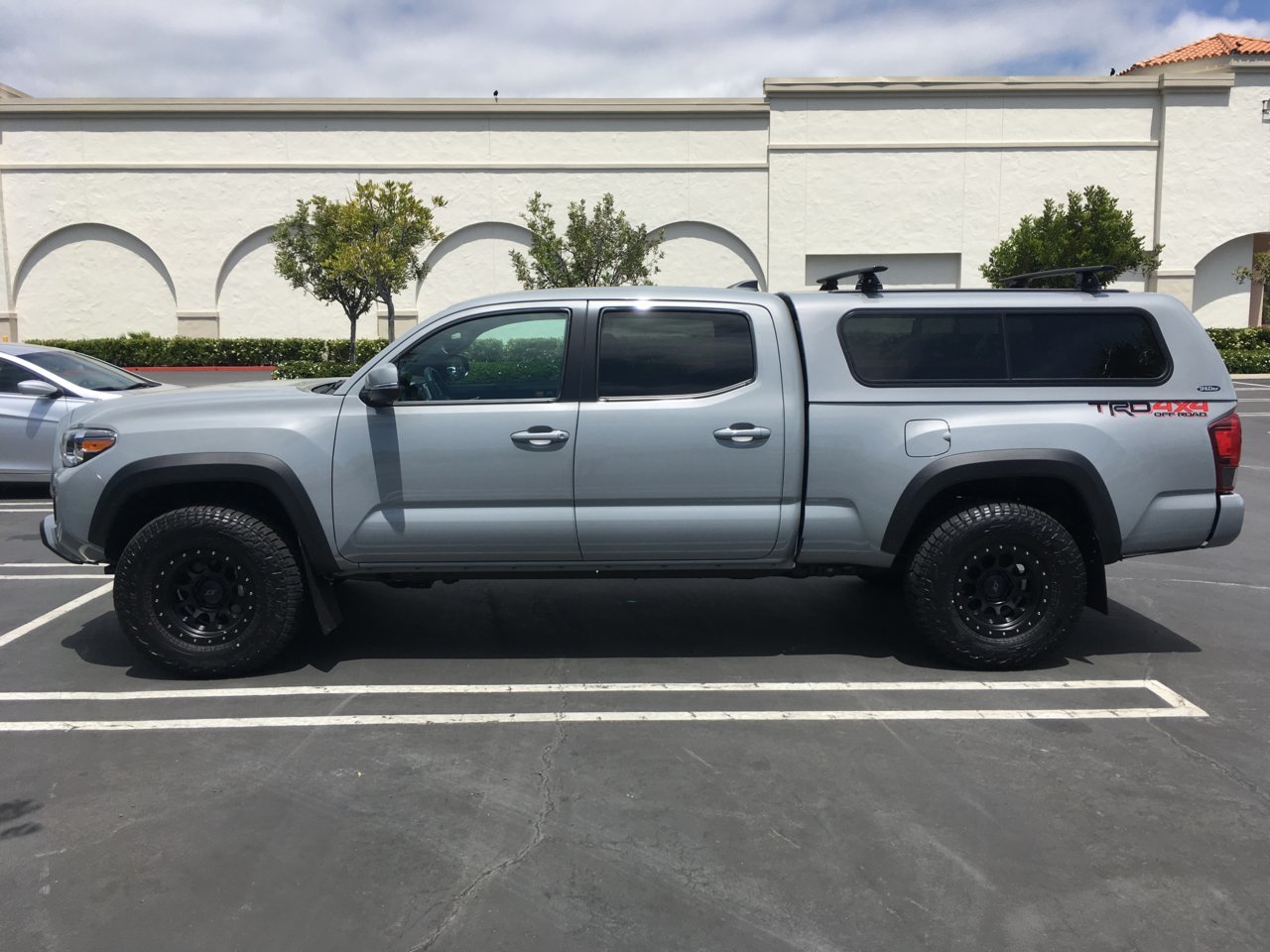

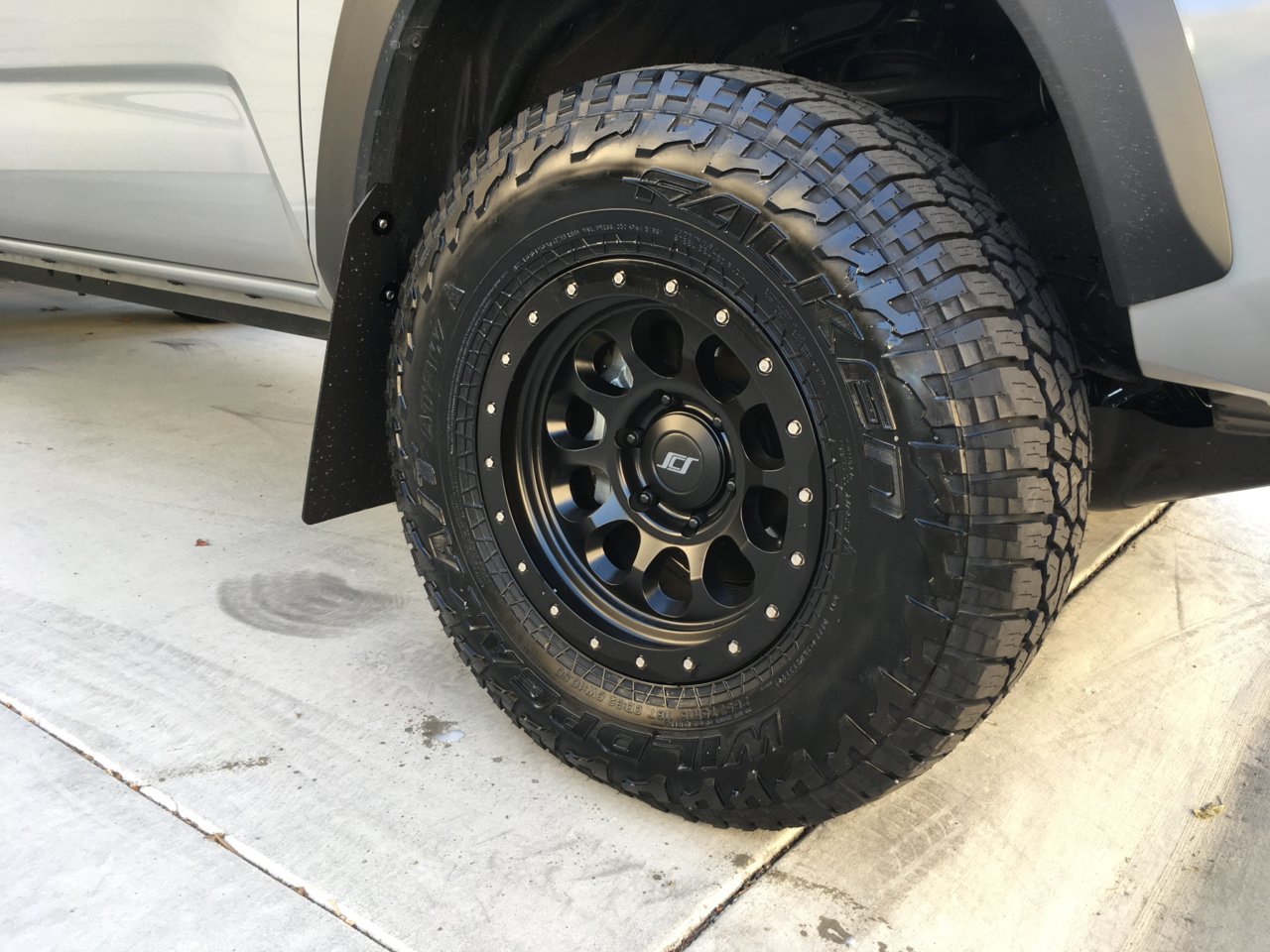

    Love the looks.

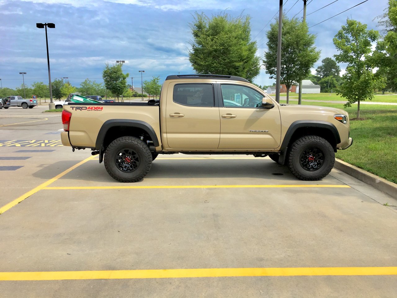

    Thank you sir... I have the 2nd gen TRD branded Bilsteins front and back (same as Bilstein 5160’s and 6112’s), HS 3 leaf AAL w/ overload leaf and JBA UCA’s roughly 2” all the way around.

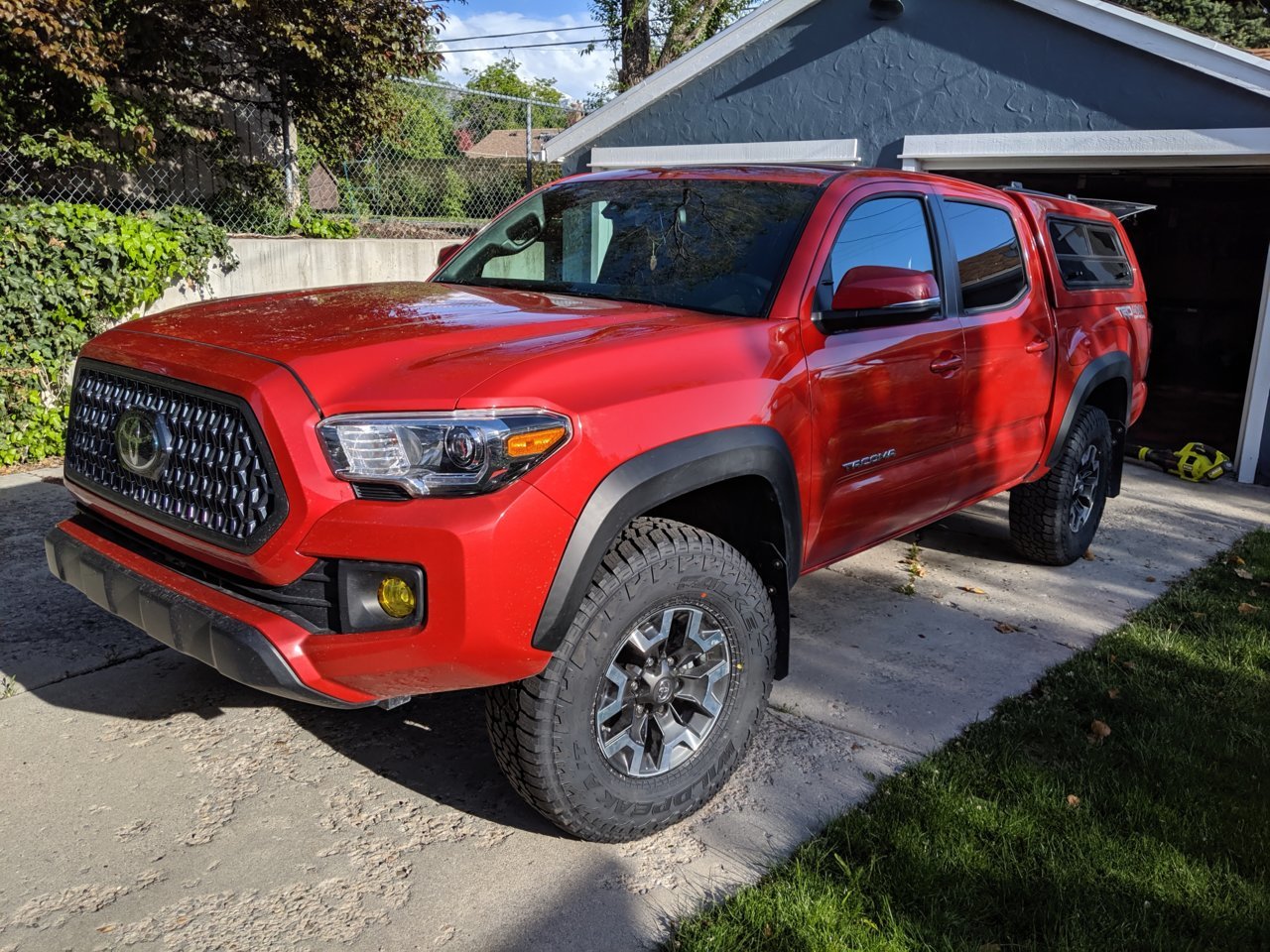

    Got my Wildpeaks installed today at DT - 265/75/16 SL. Quick drive on the freeway, I couldn't feel any shaking or vibrations, SUPER smooth, seems quieter than stock GYs. Love the look, but they are too clean, need to get some mud and dirt on em :) IMG_20190525_151456.jpg IMG_20190525_183831.jpg

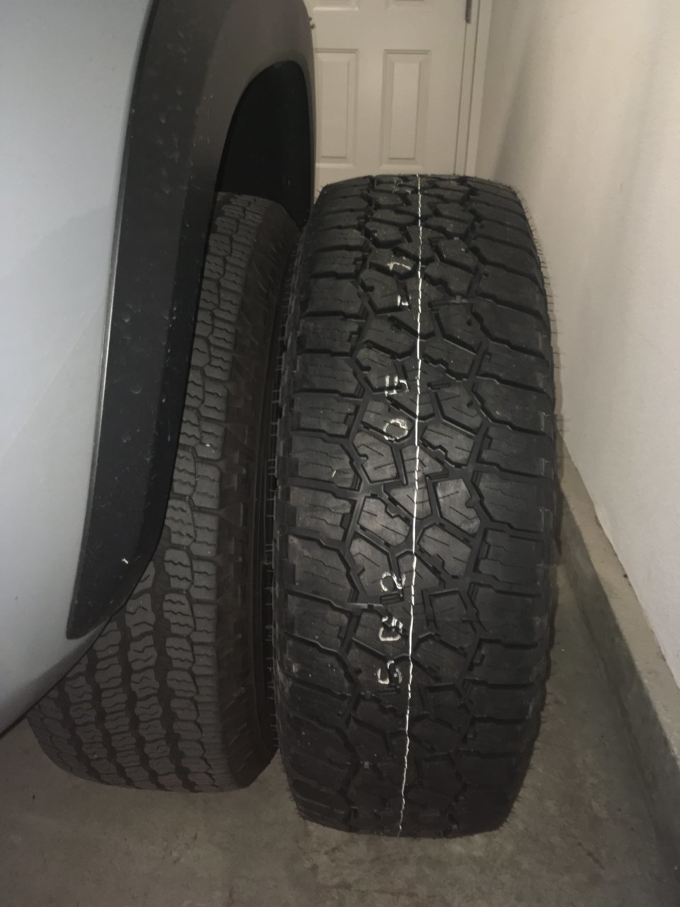

    I have a 2019... I'm running factory set Bilstein 8112s with Camburg UCAs up front and 5160s in the rear with a 1 1/2" 3-leaf AAL pack. With the Falkens, I gained an easy 1 1/2" upfront and a solid 2" in the rear. I want to crank my fronts up about 1/2" more at around 10,000 miles when I ready to get another alignment. My last alignment specs were really good so I decided to just drive it for a while as is.
    As to what's "perfect"... I'm very happy with my set up, but "perfect" is very subjective. This was my thinking: I didn't do the needle bearing replacement, I didn't want to ruin my ride with vibrations from the driveline, I was concerned about gearing and I didn't want to totally mess with my mpg. So, I decided to try and copy the ride height of the Pro or go just a bit taller. I'm very happy with the set up.
    hope this helps...
    Stock tires vs the Falkens...
