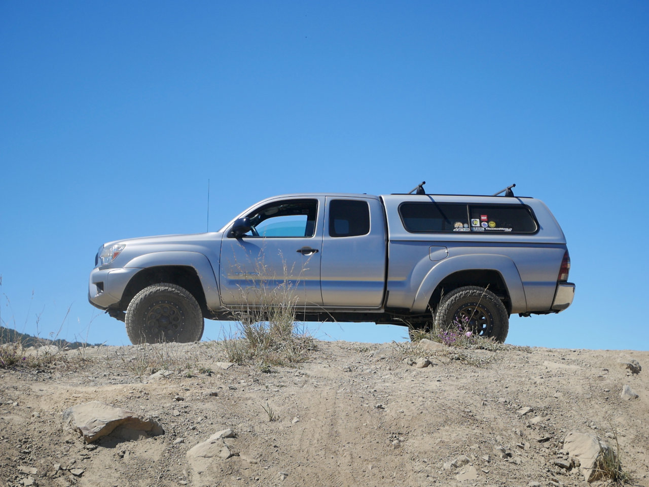

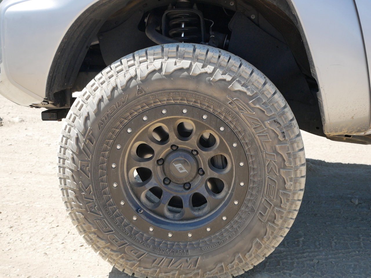

    Still loving mine
    5D4876E6-E17E-44E2-A49E-0E06E91F5476.jpg 7493482D-370B-42DD-82AA-78B6CABF973D.jpg

    By the numbers on tire it looks like you have the E-rated 265/75/16 correct? I wonder if the C-rated tire is having all the issues were as the E is okay.

    These are the E rated yes, I’ve never really had any problems with them before. I had initially thought that they were getting weird vibrations but it turned out the balancing weights had been knocked off that wheel. I think the wildpeak only comes in an E or a SL rated tire though, but I’m sure the lower rating would be fine

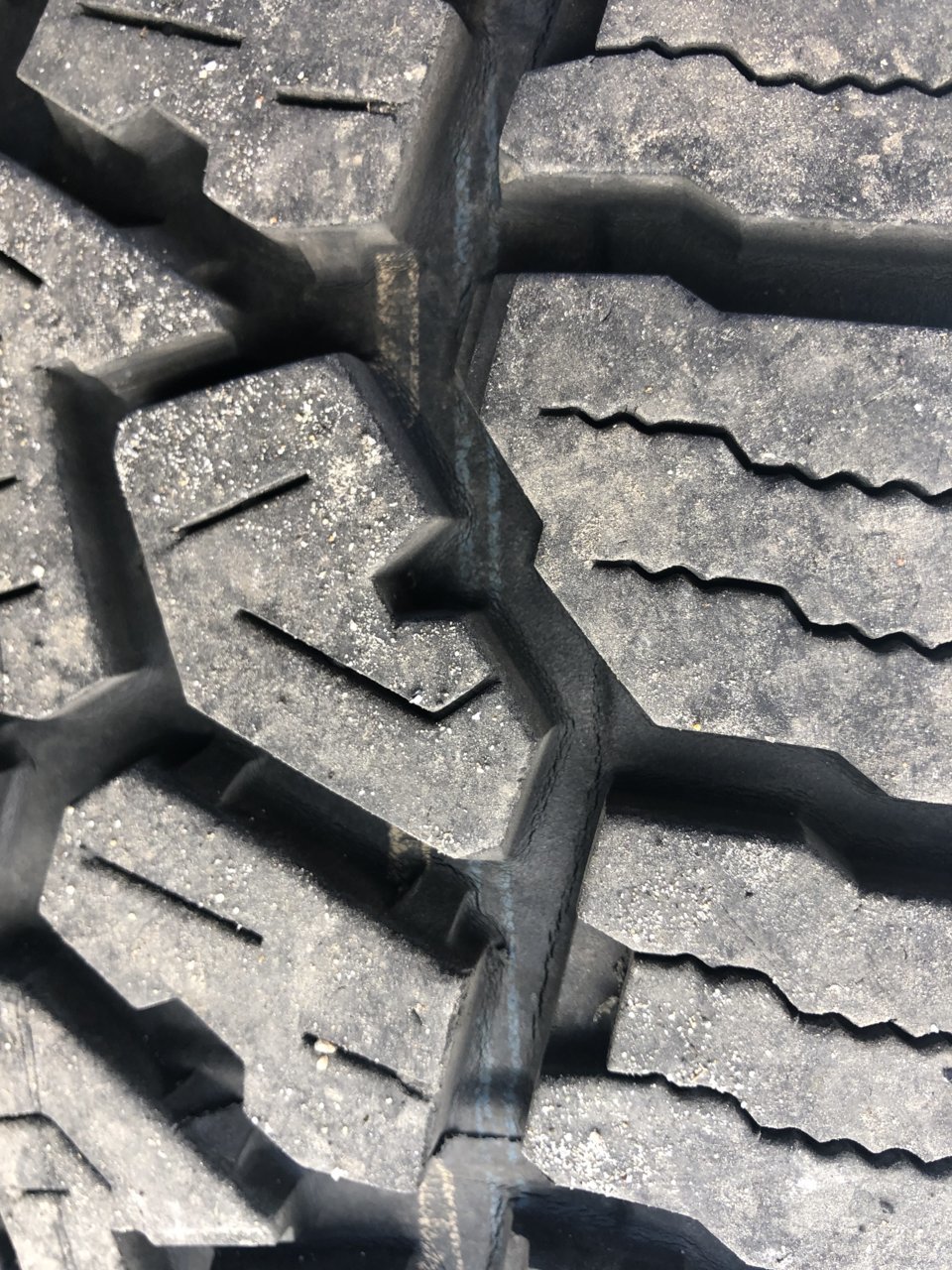

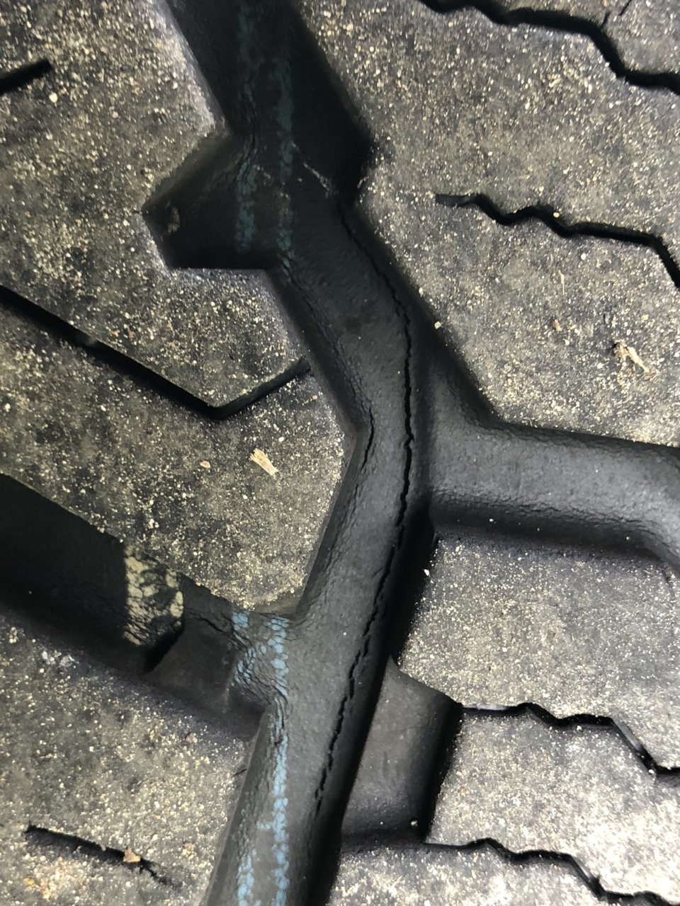

    Anyone else with SL have them cracking and looking like they're coming apart. Have 9500 miles, rotated at 2k,6k and wearing evenly as far as tread depth is concerned. But going by my rate of wear these would be dead at 27k miles at 2/32. They're at 9/10/32 now. Pressures are good, no vibes just look like they're dry rotting bad. Never aired them down or ran with low or high pressure. Don't use tire cleaner. It's even starting in the sidewall. All the tires are doing it, the first photo and the second were taken about 10 days apart. The cracking is actually starting to go around the whole tire. I'm more afraid of them failing then the wear rate, even though seems excessive for the driving I do. And they'll only pro rate in tread depth. I put these on in September last year. Don't really want to spend 400 bucks for new tires after pro rate. Just seems like a bad tire mold issue.

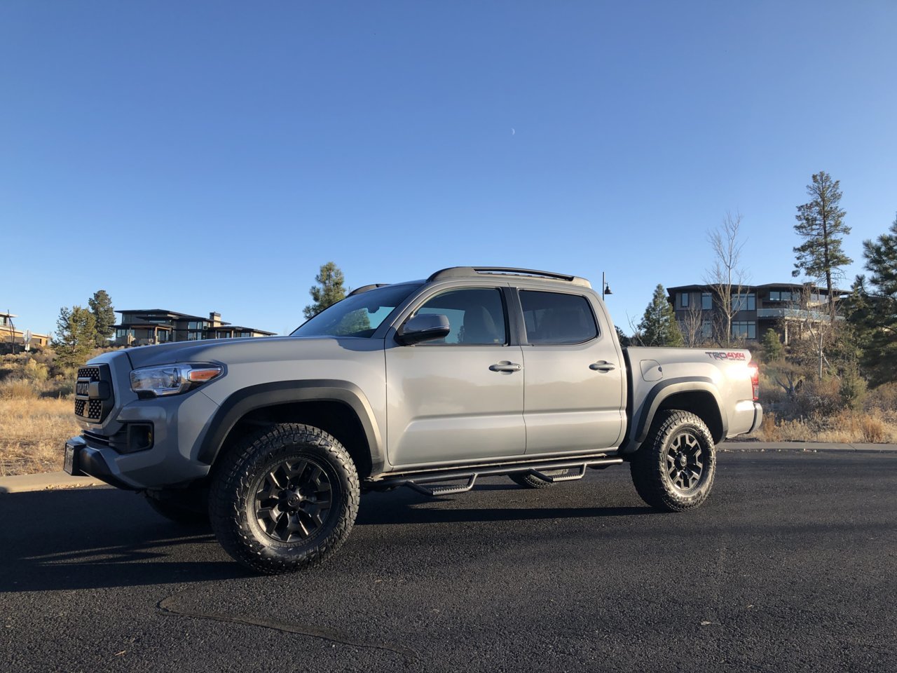

    Same as mine both with the tires and with falkens shitty warranty. Like pulling teeth getting them to warranty faulty tires. Then when they do weeks later, you have to use it towards more falkens. I went the E rated this time and are much better. The SL rated ones have a soft compound like a snow tire, maybe why they fall apart.
