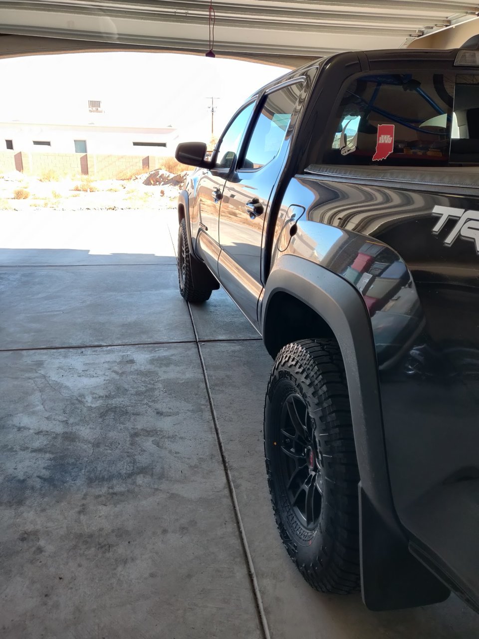

    So just switched over to the Falkens from Toyo's. These r abit heavier but soo so much smoother... No lift. Live in NM currently for winter i am running 35 psi F, and 30 psi rear. 265/75r16. I chose these because I had them on another vehicle and never had issues... and it is the smallest 75 tire in the AT category (most rev per mile for a 75).

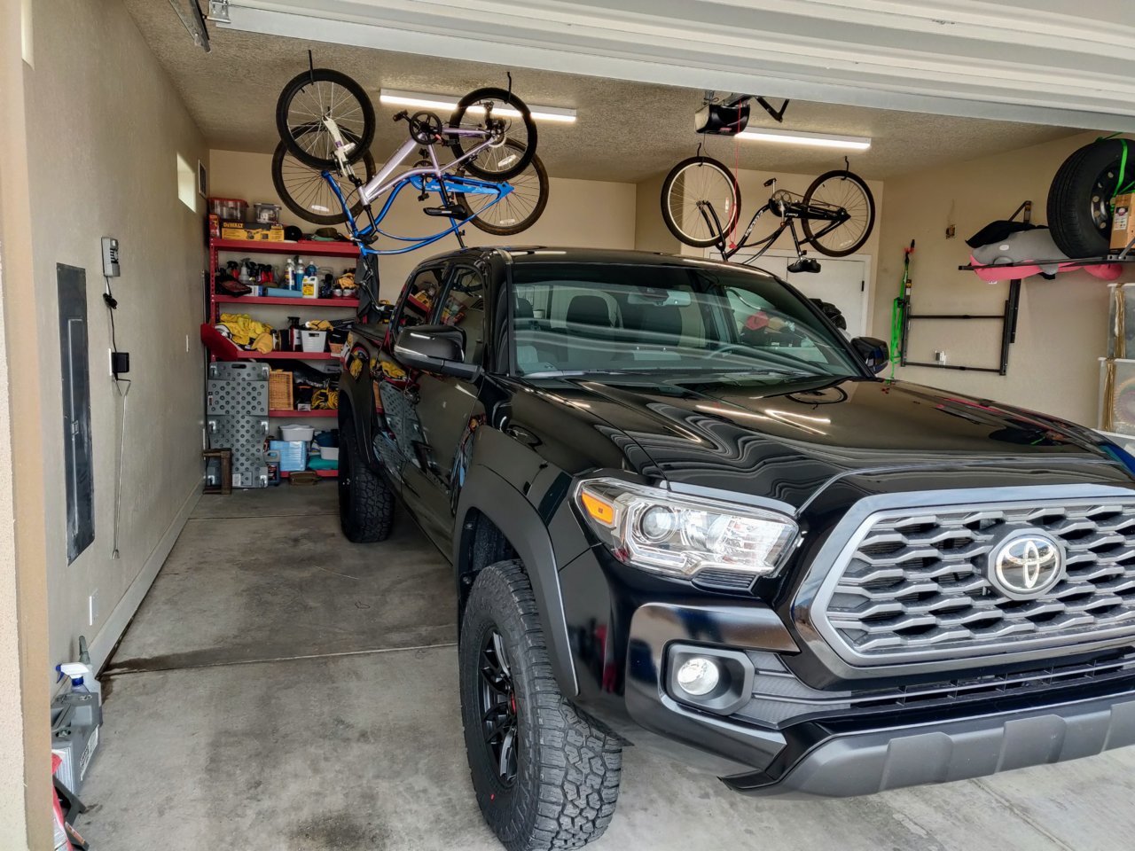

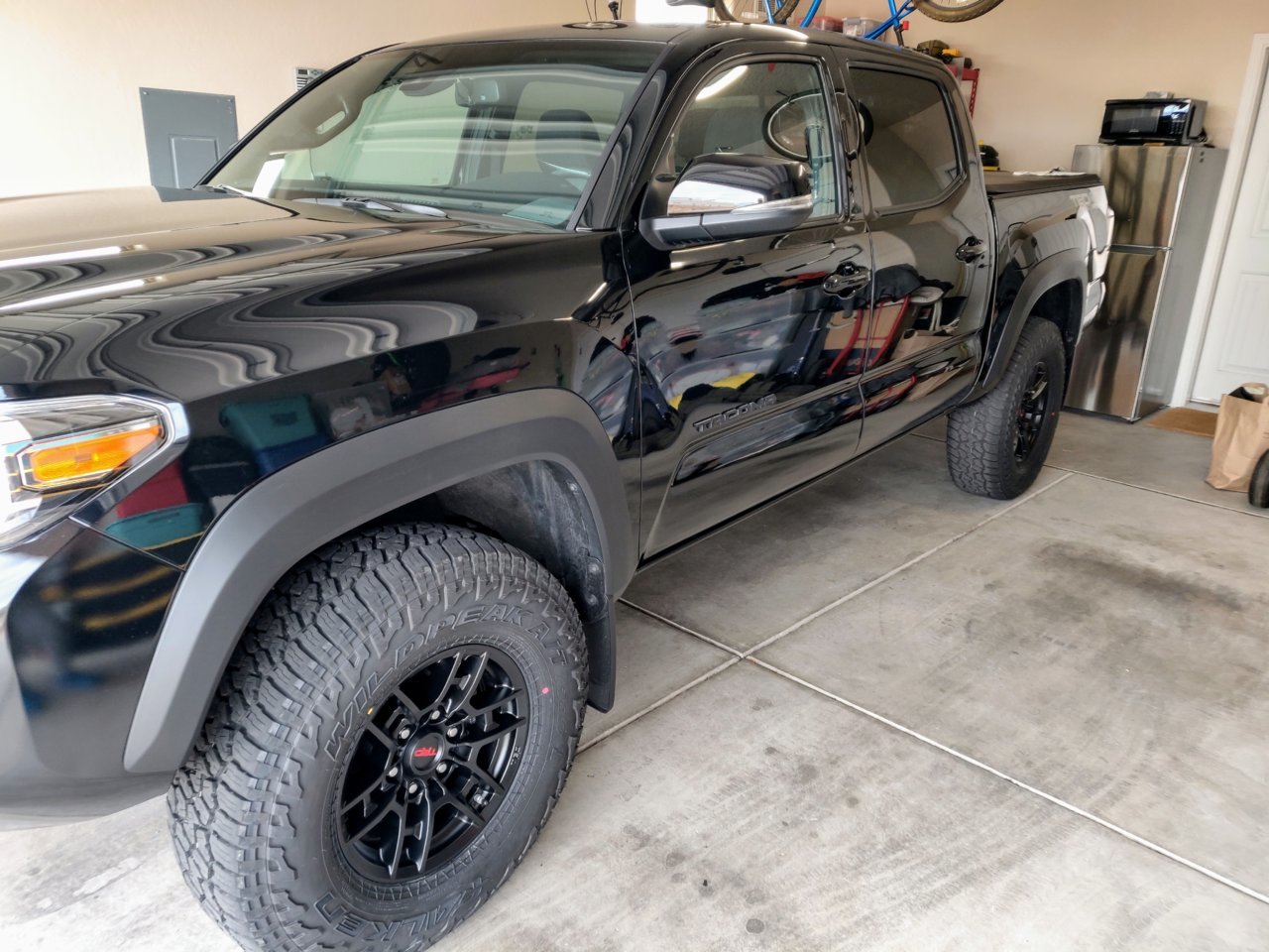

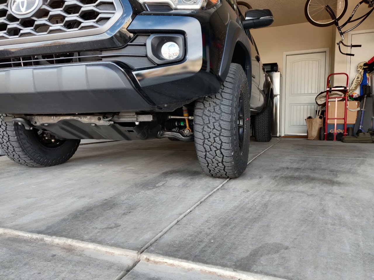

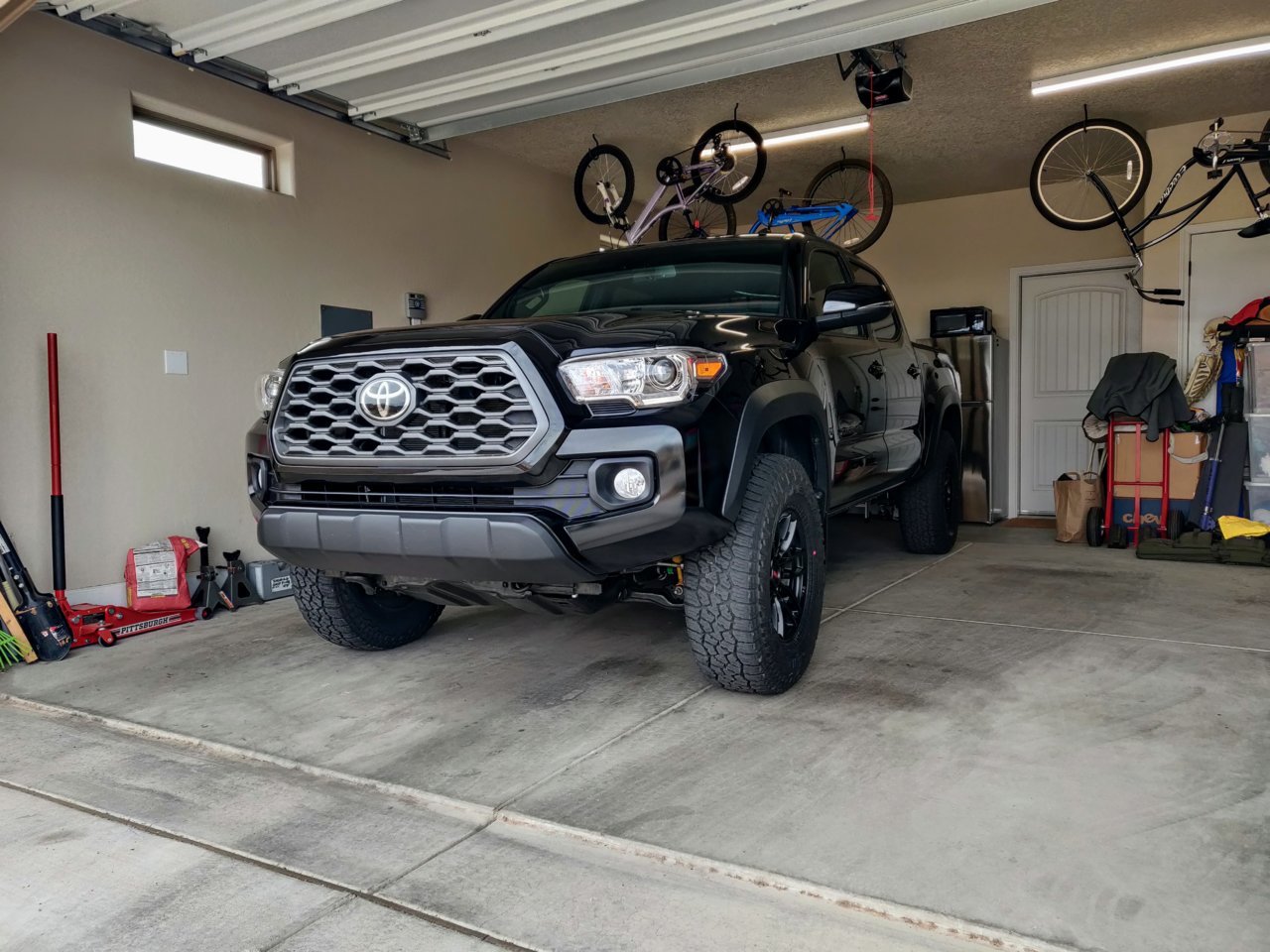

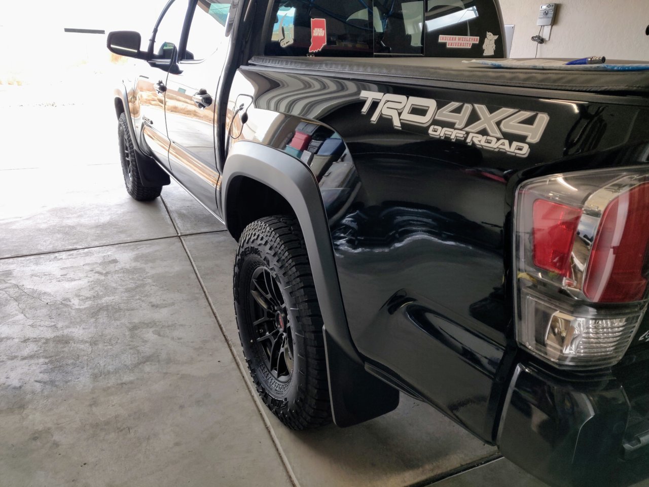

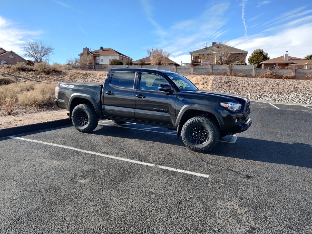

    MPG update.
    I am averaging 21 mpg 50/50 city/highway.
    that's it... that's the post... and here is a few pics of course
