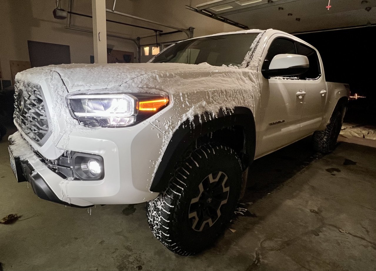

    Just a follow up to say how impressed I've been with the 265/75/16 Falken Wildpeak A/T3W SLs on my third gen TRD Off-Road on rainy and snowy roads in Washington State. Made two drives like the above on Mt. Baker Hwy 542 and they handled like a dream. No regrets with these tires!

    What kind of lift do you have?

    No lift, @ghoticov . The 265/75/16 Falkens are 1” larger than the stock tires but otherwise you’re looking at a 100% stock Tacoma :)

    Nice, looks great! Look like stock OR wheels? Any spacer? Looks like they poke a little.

    They are the stock rims with no spacers. Literally just a tire swap, that’s it!
