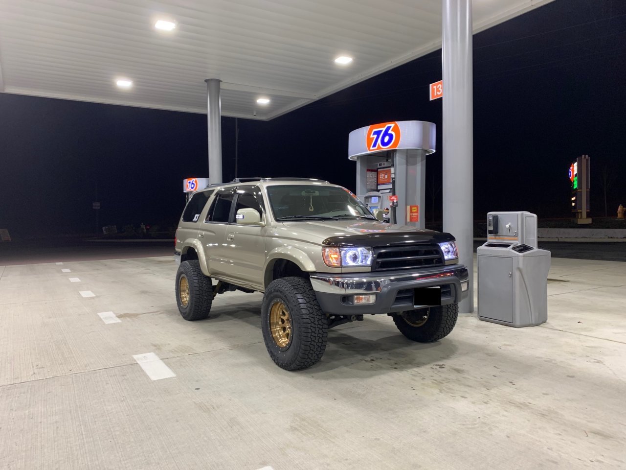

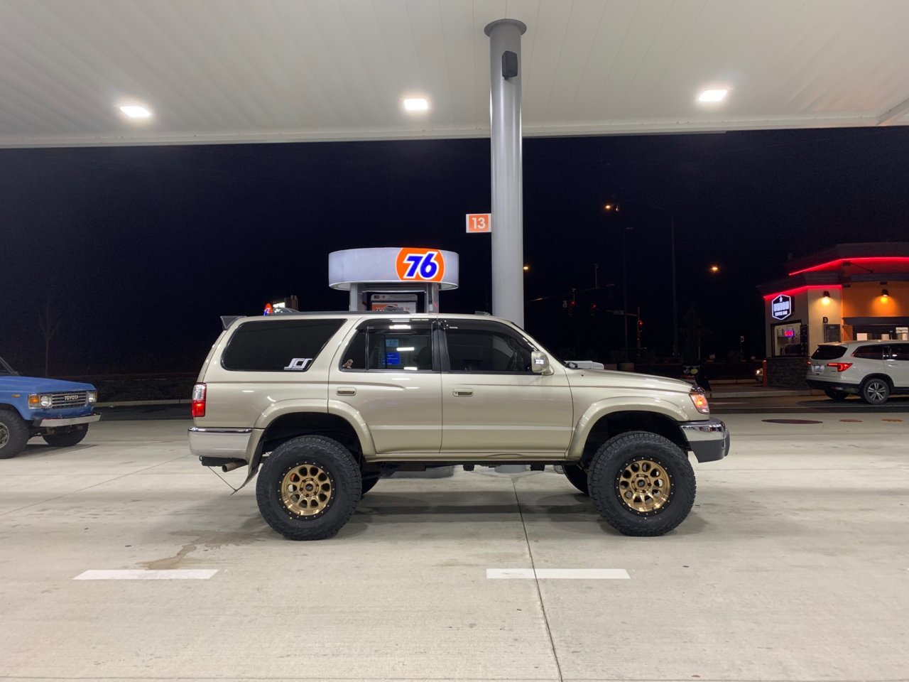

    285 70 17 - p rated
    ray10 17x9 -38 offset
    spidertraxx spacers - (no vibrations with stock setup) yes, i know its insane wide stance. i don't off-road anymore
    slightest vibration at 65+... feels like its coming from my rear wheels so im going in for a rebalance soon. only had 'em for about 500 miles

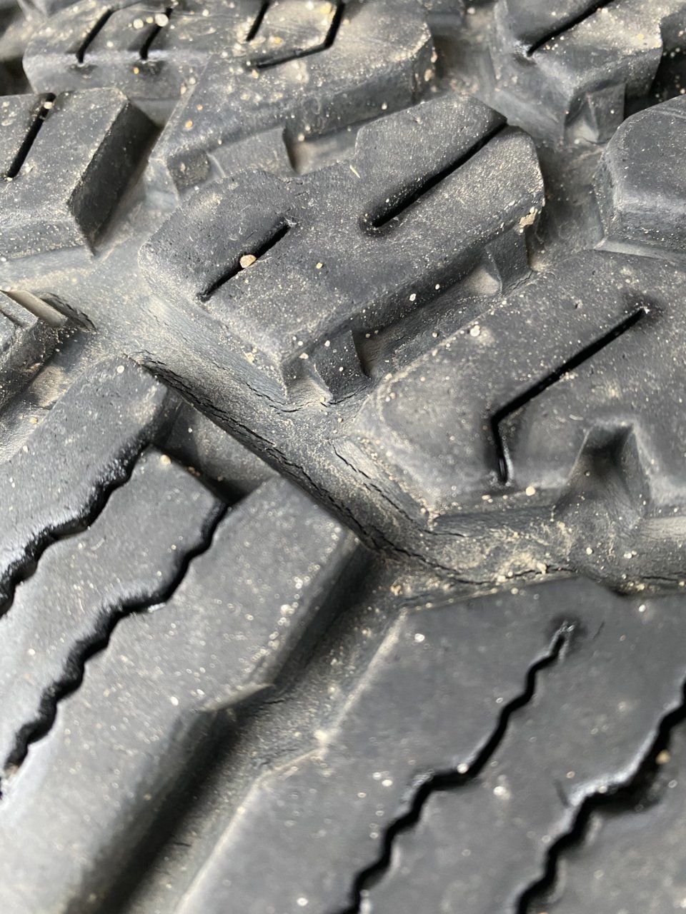

    Cracking

    Damn. Mileage? Load range? wonder if P loads crack even with the higher silica compound

    Man those tires look older than the 7yr old winters on my Camry.
    I've had my Wildpeaks since last March and they look brand new. Rubber still sticky, haven't worn at all, and still look smooth (no cracks)

    Yes I am looking to warranty mine unfortunately

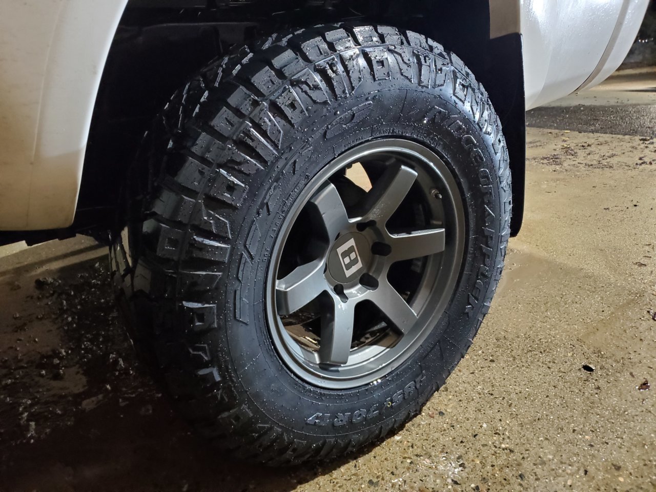

    Taking off my Wildpeak AT/3 265/70/17 today after 65K +/- miles. Mild wobbles @45mph - mostly braking. No other issues at all. The shop that put them on is quite impressed. Switching to the Wildpeak H/T02 only because I do too many road miles in comparison to off road.

    Agreed. Why I am sticking with Falken. Sitting in the shop now getting the new ones!
