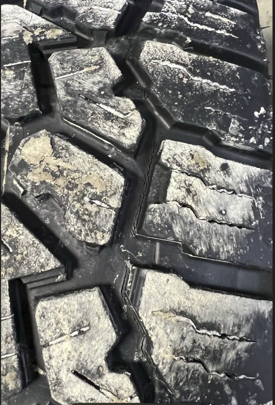

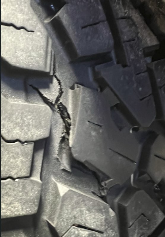

  14. Dec 26, 2022 at 7:58 AM
    #254
    Tacoma204
    Tacoma204 Active Member
    Feb 7, 2020
    #318487
    27
    Wanted to reiterate this post again for people, based on my current situation. I have a set of stock sized Falken AT3W's 265/70R16 on my 2020 off-road. About 2 yrs of use in Canada, 30,000km. Original tread depth is 13/32 and my measure about 9 to 10 now so not that much use. Tires were rotated 4 times in that span and pressure maintained at 35psi.
    I noticed some sever damage on one tire while I was washing it and bought a replacement two weeks ago. I do not remember driving over anything but though I must have. While dealing with this, I found cracking along the inner and outer tread blocks on all tires. My driving is 99% on road and maybe 1% dirt roads / frozen lake. See images below.
    I ordered these tires from a popular online store in Canada and two came from their Toronto warehouse, one came from Edmonton, and one came from Calgary. All manufactured in 2019. The pair from Toronto were manufactured in the same week of the year so likely same batch. The other two were made in different weeks. So they can't even say this was one batch that was bad...if you have these tires (especially 2019 ones), be aware. I was likely pretty close to having a blowout on the highway. Pretty pissed to say the least.
    I previously had high praise for these tires but now, I would say get something else. I will see what they do regarding warranty. If they are jerks about it, I will just get new tires and maybe put the new Falken tire on my spare. Not worth the risk driving on this garbage.
  15. Jan 12, 2023 at 7:14 PM
    #255
    glazer1972
    glazer1972 Well-Known Member
    Apr 17, 2016
    #184492
    81
    05 Tacoma PreRunner Double Cab 4.0L
    Intermittent Wipers.
    I purchased a set of as new one year old jeep takeoffs back in May of 21. They are LT285/70r17C. They are on a 2011 F150. No splitting or cracking yet. I’ve only put about 13000 miles on them though.
  16. Jan 12, 2023 at 7:24 PM
    #256
    Tacoma204
    Feb 7, 2020
    #318487
    27
    The online retailer I bought from didn’t help one bit with my warranty but I have to say Falken stepped up. They took my claim with photos and measurements and basically said go by a new set and we will reimburse you the pro rated amount. I’m in the process of doing that now.
    The recent research I’ve done on all brands, there always seems to be some instances of cracking so it seems like a problem that all manufacturers have now and again. Not saying it’s acceptable. More so saying it’s probably not avoidable by simply switching brands. Will see how this second set goes.
