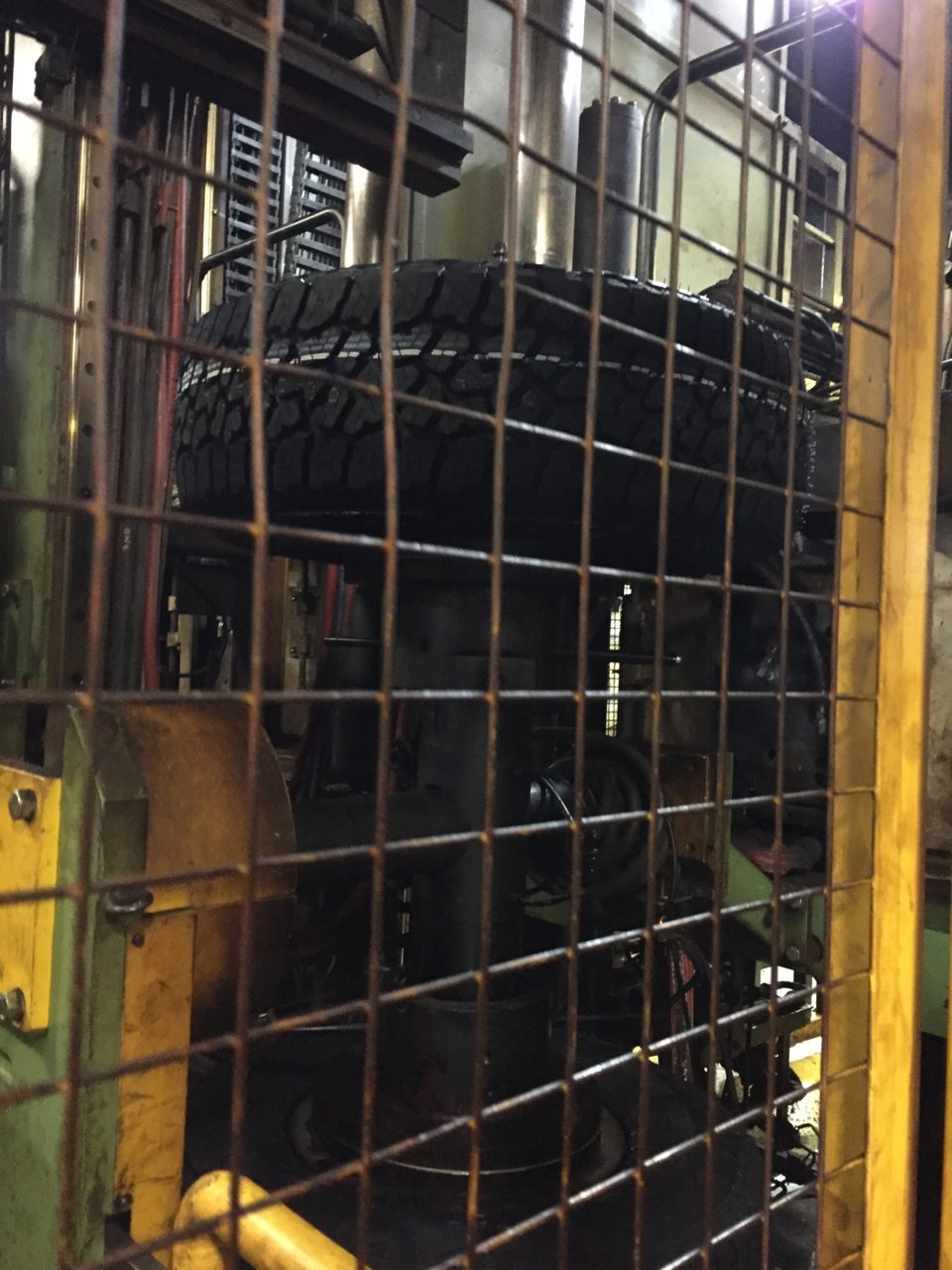

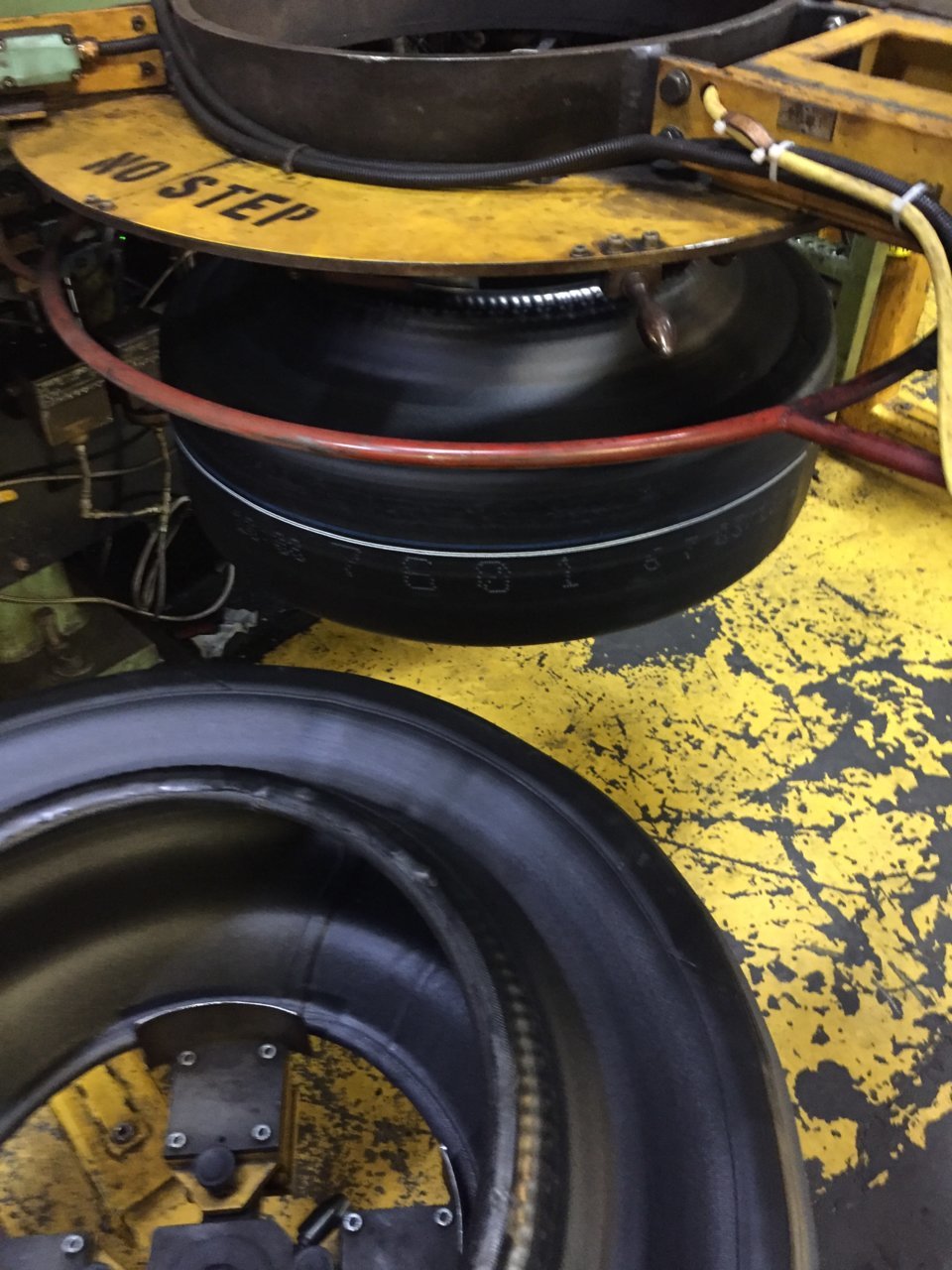

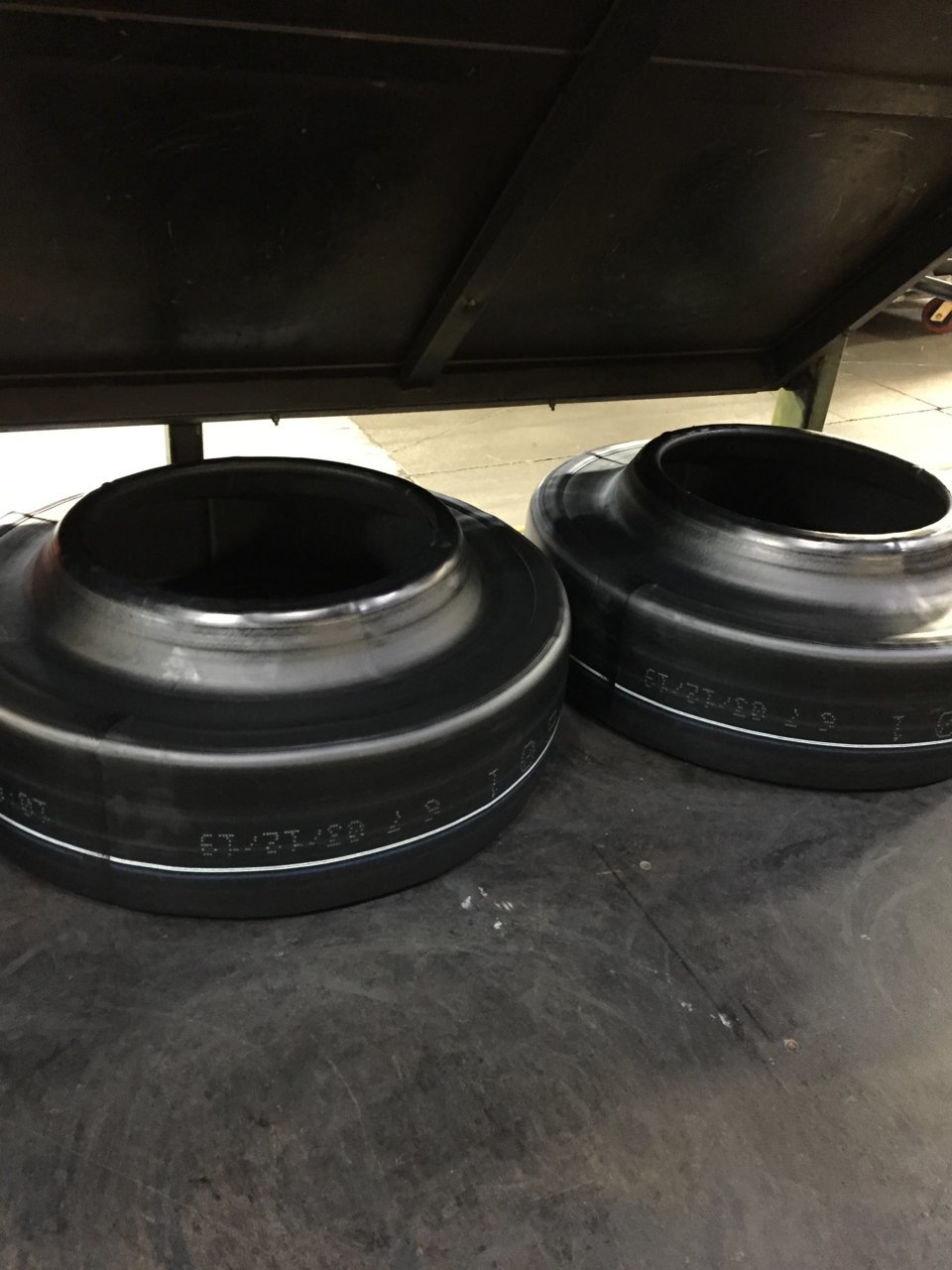

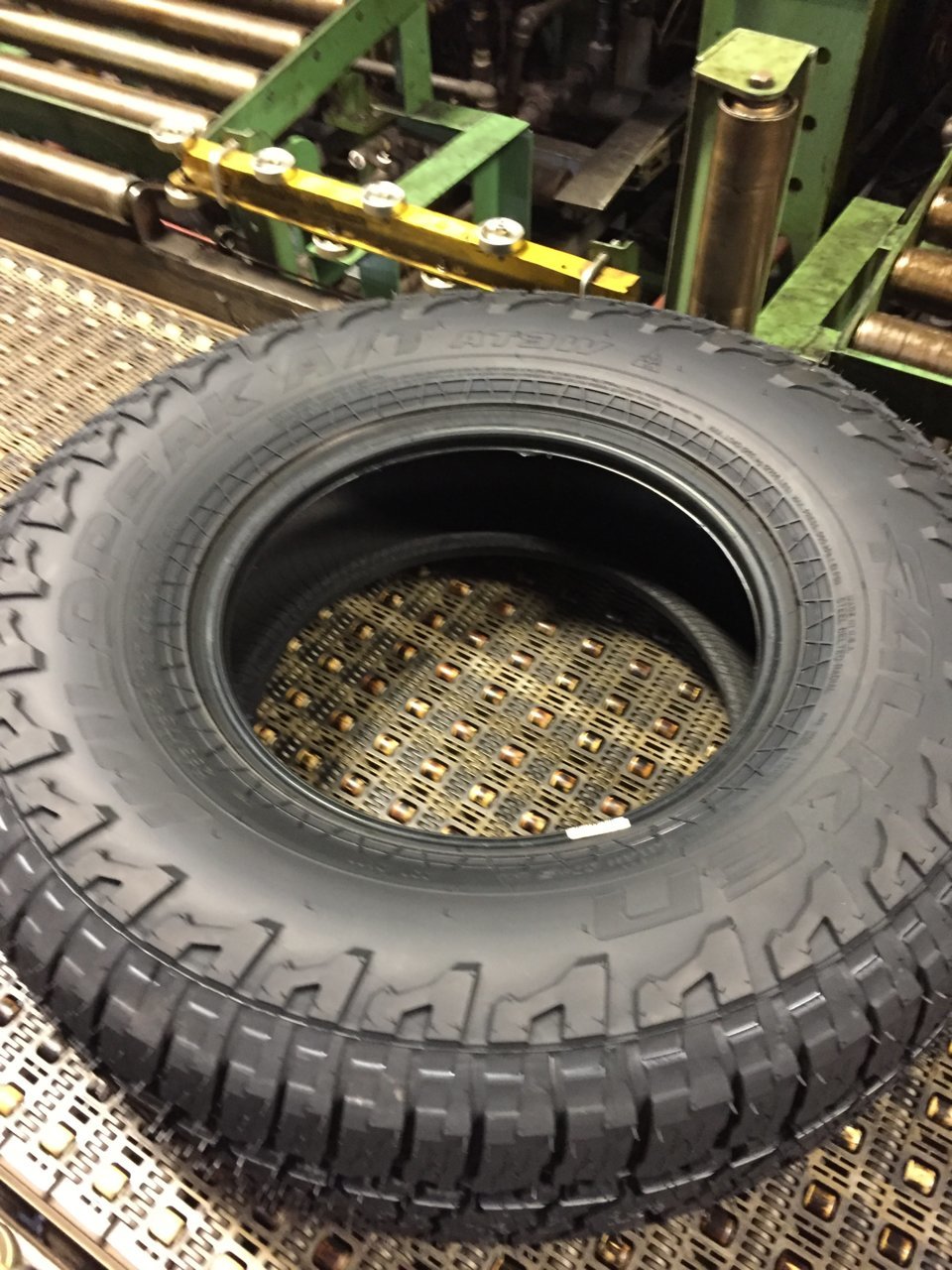

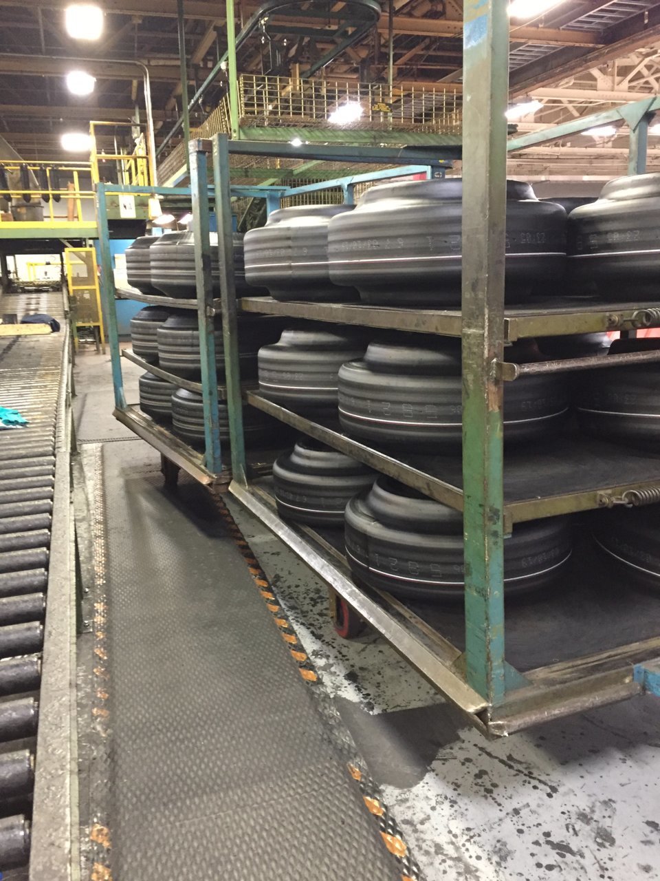

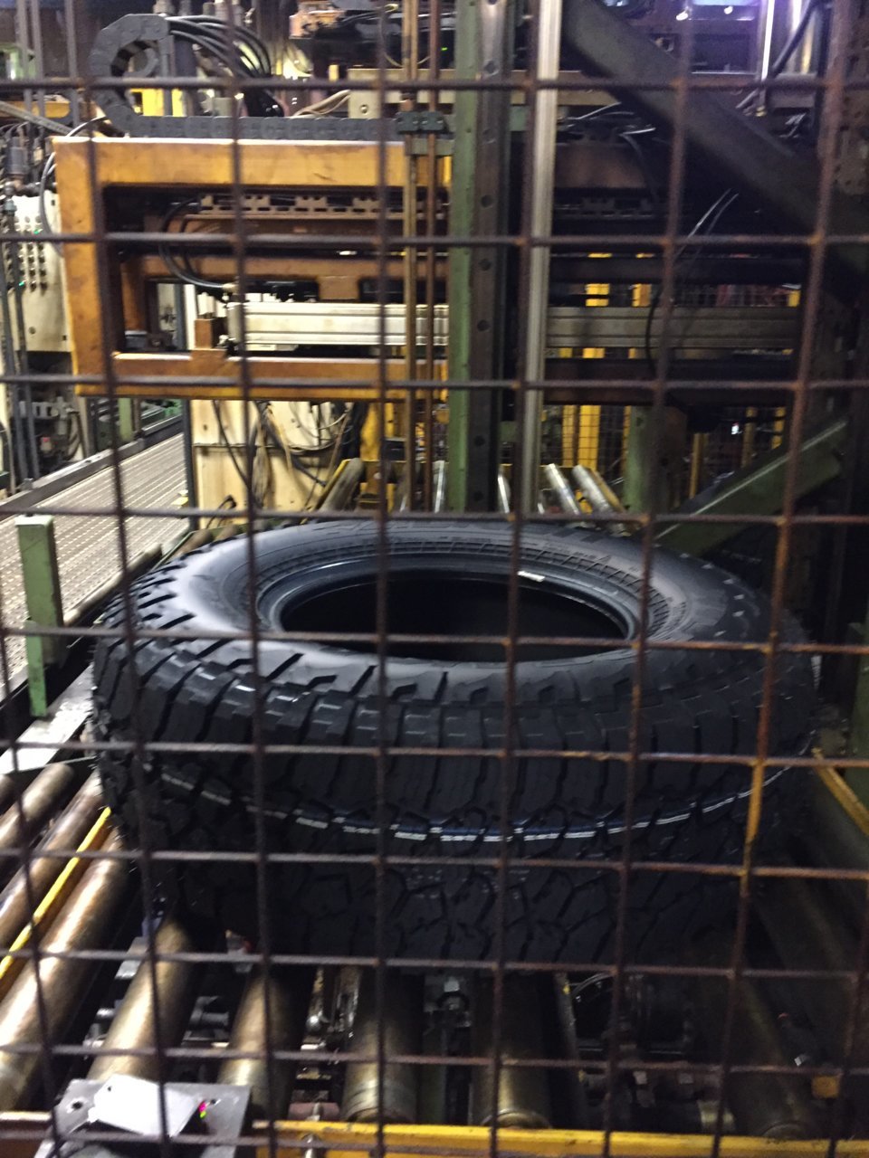

    There’s a lot of variables and things that can cause tires to have problems. From being manufactured, to being installed and balanced. No tire is immune from any issue. Nor is any brand. If people understood how a tire was made and how much labor goes into making one they might better understand. Even with some of the completely automated building machines we have problems still arise. Mostly only the OE tires are built with those. Which means your tire is completely hand built. They are built in 2 stages. First the carcass then the final breakers and tread. The machines build lots of other tires, meaning they get changed over and everything has to be adjusted for the tire it’s going to be building. Things get out of adjustment, components can vary, be slightly out of spec or not conforming. Builder could of just got sloppy, or the machine or something have a hiccup. Or there can be issues during curing. Most major issues will cause an immediate scrap tire. Those get scrapped. No tire is perfectly in balance. That’s what balancing is for. There are always variations. Tires aren’t injection molded. I don’t have any pics of the wildpeak carcasses but here are some pics of the green wire going into the curing presses and coming out, before going to finishing and final inspection.
