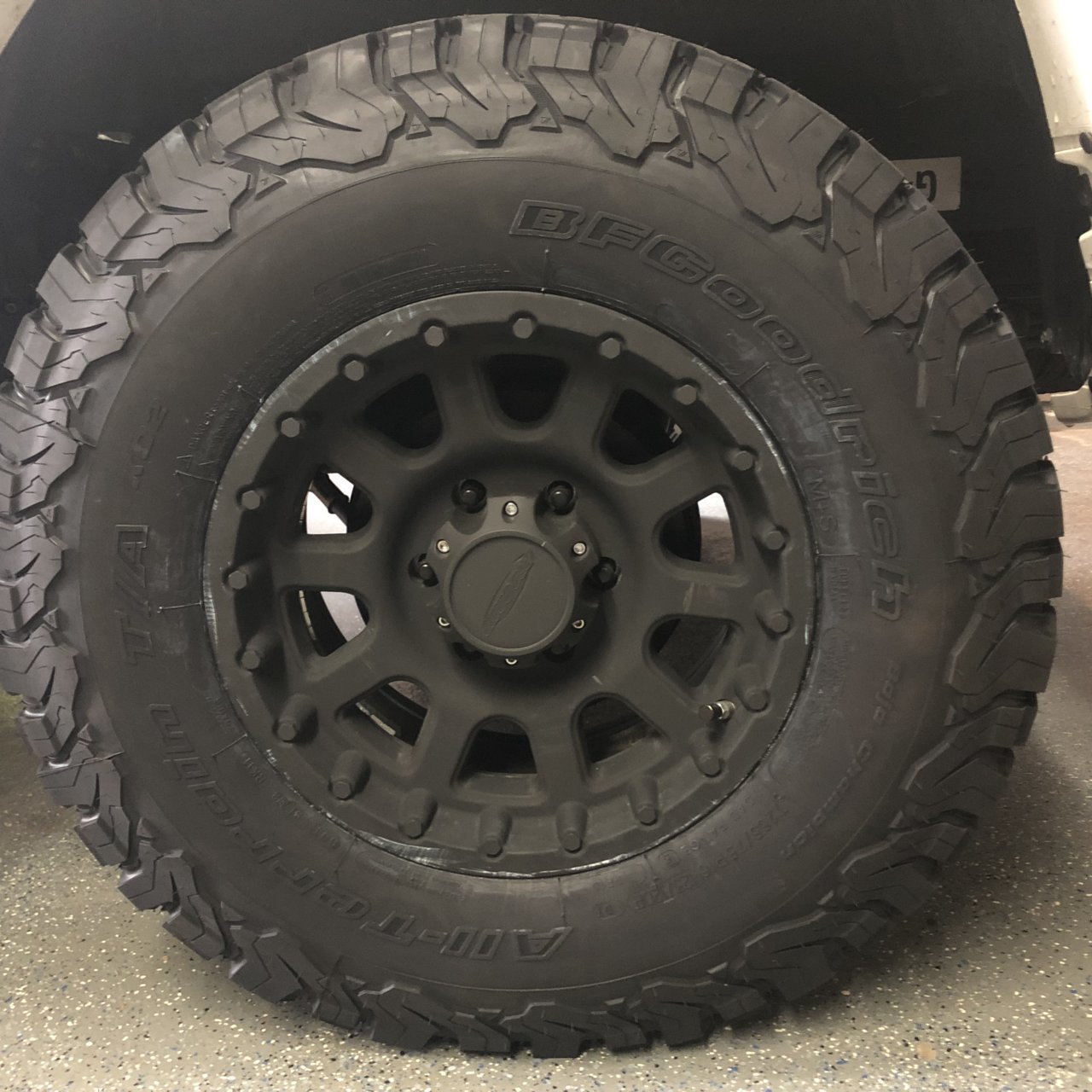

    Just passing it along... after removing my Wildpeaks and having my truck realigned, new KO2’s, rebalanced, vibration is gone.
