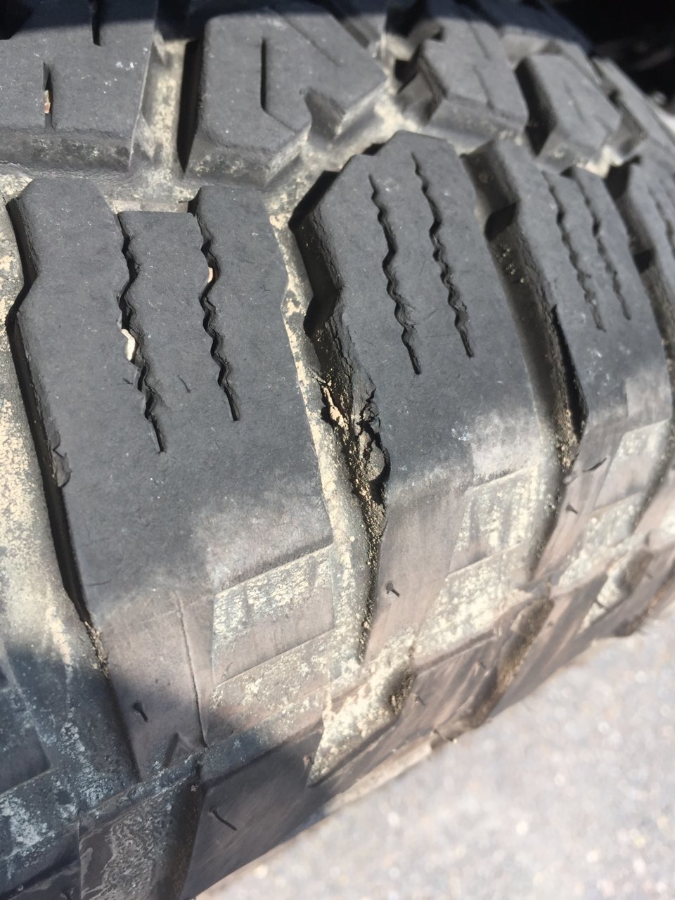

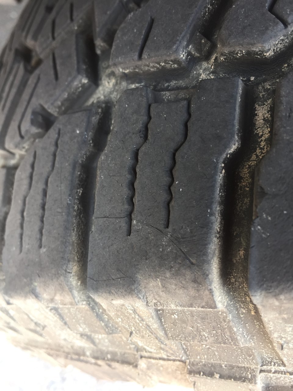

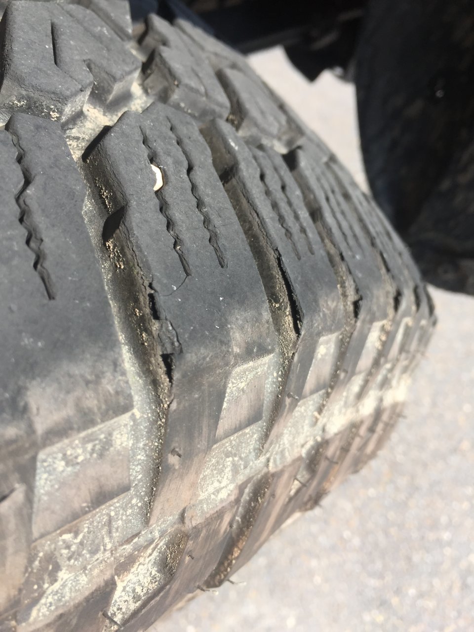

    Has anyone had this here problem? It looks as if some of the threads are peeling on the very outermost layer. It also looks like there some quarting on there, but it might just be scratches. The guy at the tire shop said that its common for tires to do that if they get off-roaded in.
    Also, Ive noticed the vibrations some of yall mentioned, but only after I went mudding. Once the mud washed off they went almost back to original, but were never the same.

    Ive been wheeling it, but Idk how hard the way I wheel is considered.
