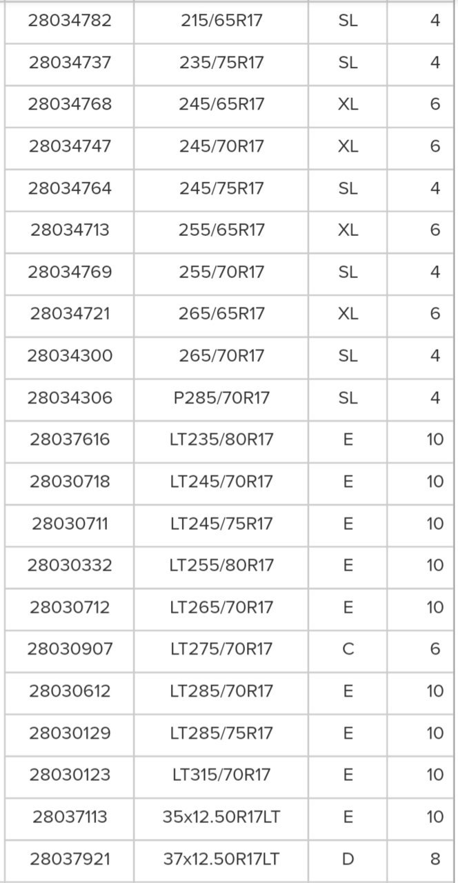

    The SL's are a 4 ply, C load is a 6 ply & E load us a 10 ply with the Wildpeaks

    no E rated tire has 10 plies, just to let you know.

    Yep your right. He's talking sidewall & not load rating. My bad. I would be real surprised if these are only a 2 ply sidewall with the max load capacity that high but technology these days changes things
