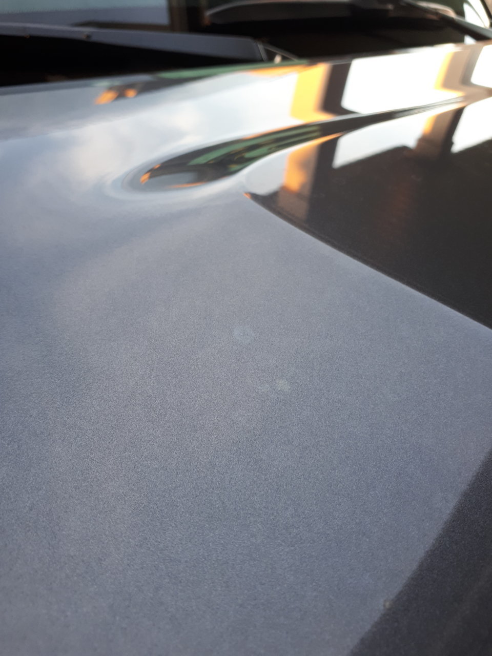

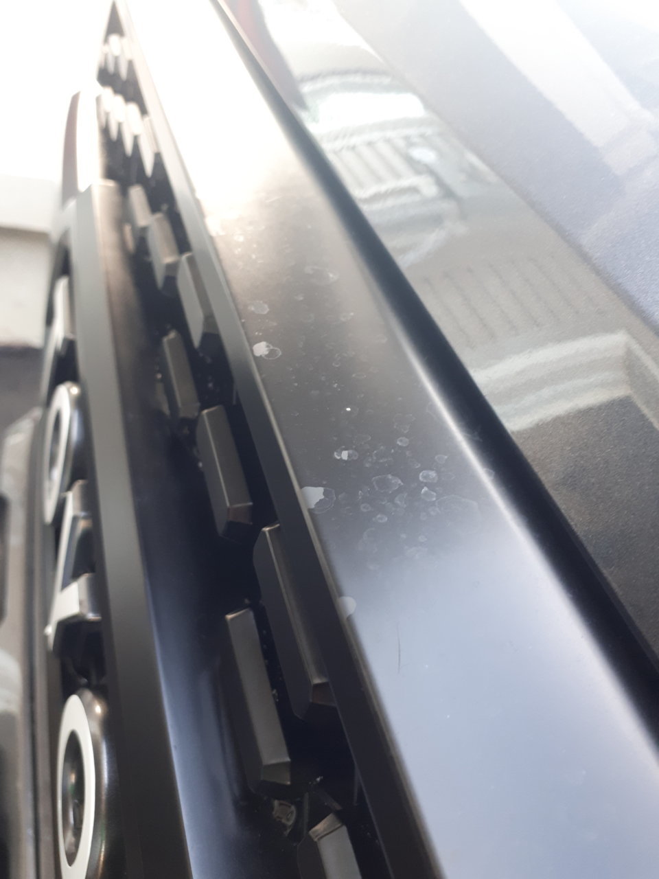

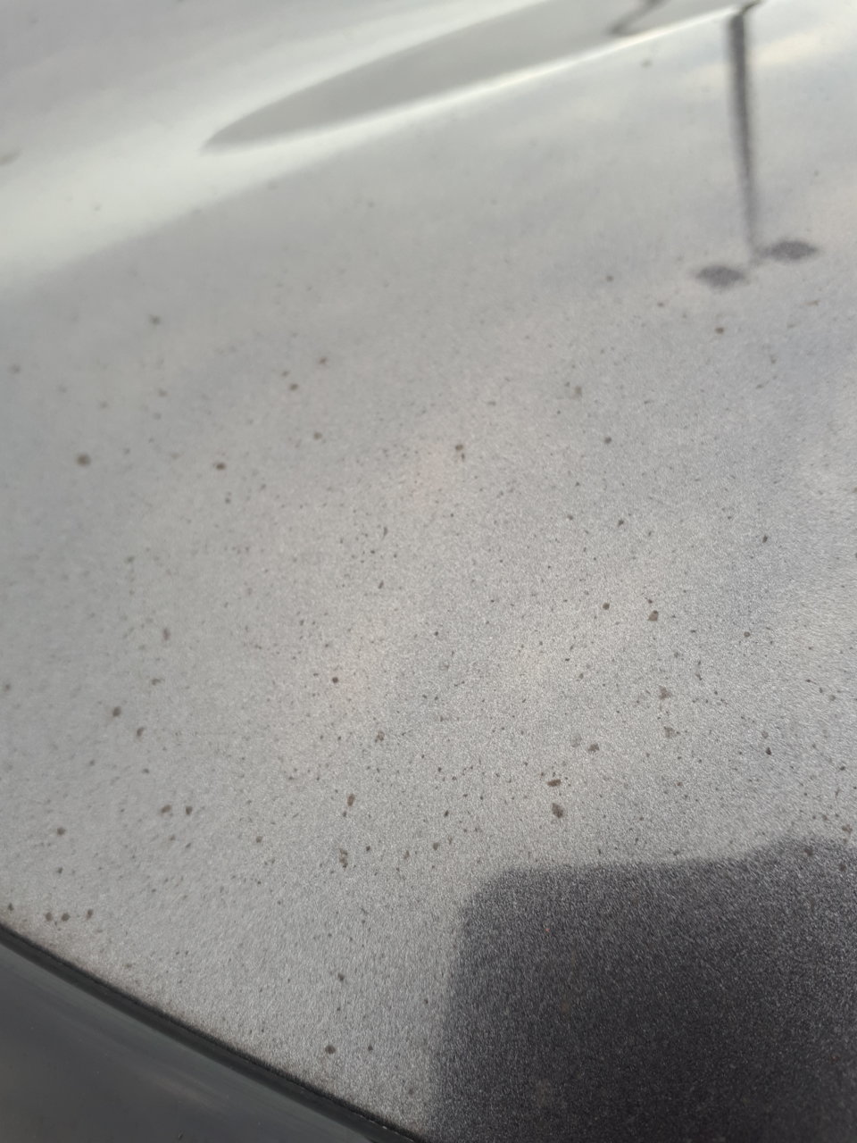

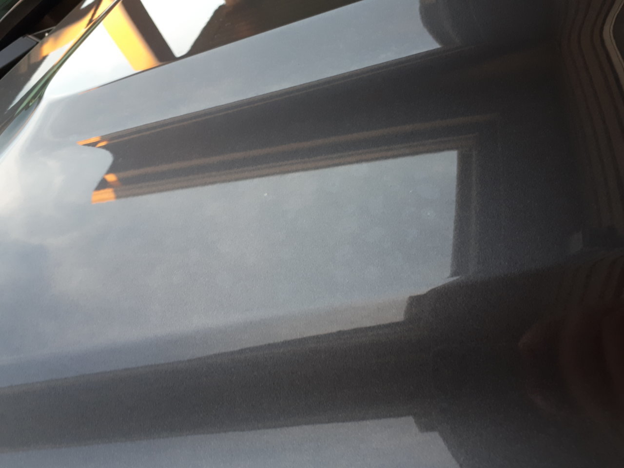

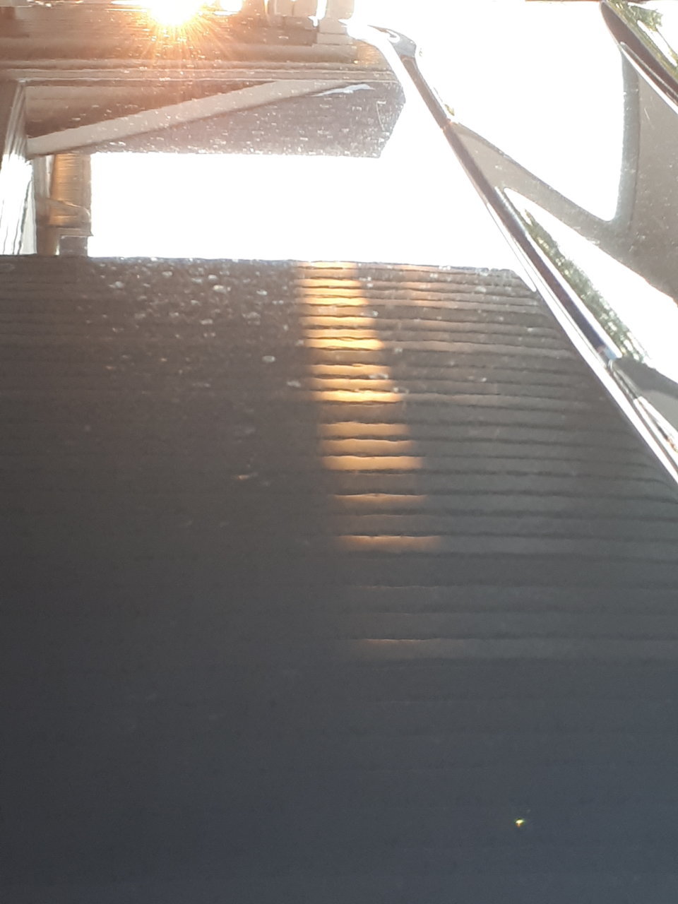

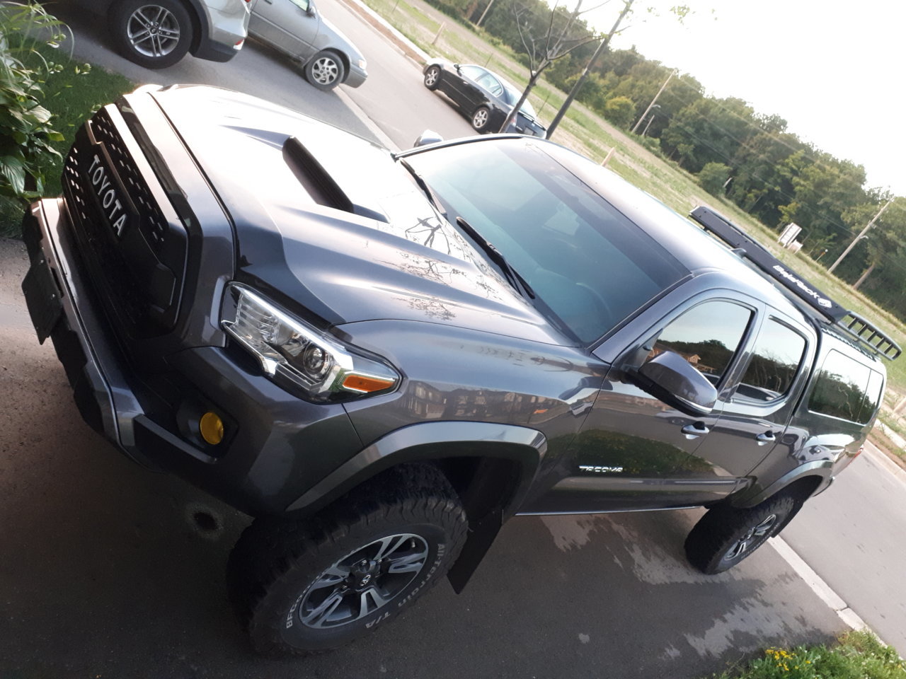

    So this is after 1 shift. It rained so this isnt half as bad as it usually is. Its usually fuzzy20180809_185006.jpg since then I washed, ironx it, clayed only the hood, and applied the ceramic companies maintenance spray. Looks good from far but there are harrd stains on it still and spots of discolouration all over the place. Ironx and clay bar did not remove this stuff. Im stumped now20180810_203723.jpg 20180810_201158.jpg 20180810_201114.jpg 20180810_201050.jpg 20180810_192222.jpg

    IronX isn't going to remove those water spots. Also every time you clay you are typically introducing some degree of marring to the coating.
    Some people have a hard time with water spotting on ceramic coatings. You can do a search on this problem.
    If there still there after you wash then perhaps try some white vinegar. You or the company that installed the coating may have to polish it out and reapply. But then this is going to keep happening. You may have to find a different type of paint protection!
    Sounds to me like your in a no win situation if this industrial fallout is bombarding your truck all the time.
