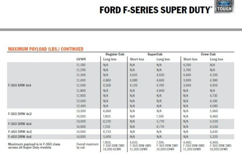

    Maybe you just know of the only dealership with a functional moral compass. Even if it's commercial, they are not responsible for what you choose to tow it with. If you tell them you have a Ford F350 and they sell you a 30 foot gooseneck, it's not their fault if you hook up to it with an F150 and wreck it.

    Anyone can hook up a trailer to anything and be stupid, my question is would an RV seller at the actual place of business put on a in bed camper into a truck they obviously know cannot support that weight?

    I'd say you'd lose money if you bet they won't.
    Look at it this way, how many dealership sales people know more than the model name of the car/truck they are trying to sell you? I can tell you, I have known more about every new car I've bought than every single salesperson I dealt with.

    A dealer is definitely assuming you can haul the biggest camper on the lot when you pull in with an F350 Dually. When in reality, a lot of them don't come close to being within spec. Those triple slide campers are nuts. Eagle Cap 1200 has a wet weight of 5,590 pounds. The highest capacity F350 dually is the 2wd Work Truck version, with a short cab and a gas engine @ 7850 pounds payload. You get a Lariat trim crew cab 4x4 diesel and that number tanks FAST. Below shows max Payload for F-350 DRW 4x4, and it's 6530. If you go diesel, that's about 500 pounds of payload lost. You're down to 6030 payload (not even talking about options), minus the 5,590 camper gives you 440 pounds left for people, food, beer, pets, clothes etc. And how many people add a boat or small trailer behind?
