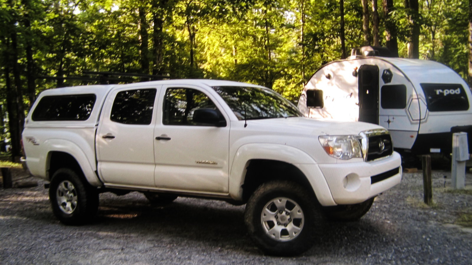

    Something like this is a sensible trailer for a Tacoma. Yes, you could pull a heavier trailer, but you're going to have to limit what you can put in the truck. Its 19', about 2900 dry with a GVWR of 3840. ASSUMING I have it loaded to max that would be about 500 lbs on my hitch. Add another 180 for the cap and that leaves me about 520 lbs of my original 1200 lbs of payload for my wife, myself and a few things in the truck. I have to pack carefully. Realistically I'm probably closer to 3500 lbs than 3850
    If I'm traveling very far I pull this with my F150. We are leaving GA in JULY for Glacier and Yellowstone. My Tacoma pulls it easily and I often use it for trips inside 100 miles. But at 17 years and 247,000 miles I'm not pulling it to Montana with the Tacoma.
    My TT is a 2022, the specs are slightly different for this 2024, but the layout is the same. The listed CCC on this 2024 can't be right. You're not going to carry 2200 lbs in a 2800 lb trailer. The CCC on mine is 950.
    r-pod RP-171C - Forest River RV (forestriverinc.com)

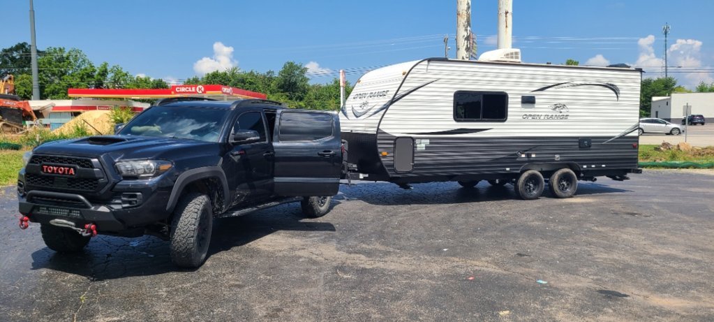

    I just got back from a decent trip to the coast with the family (8-9 hour drive) over the Chattanooga mountains.
    I hauled an OpenRange 20MB trailer (sleeps 7, GVWR = 6000 pounds), 3 adults + 1 baby, and tons of gear (starlink, night hunting gear, baby stuff, etc).
    I had to lock it in S3 for the mountains, and S4 virtually everywhere else.
    With a weight distribution hitch and a good brake controller it wasn't THAT bad considering I have a couple hundred pounds of armor on the truck.
    You just drop it to S3 when approaching hills and get used to the 3500 RPM you're going to be doing to get up the mountains. Get to the top, back to S4.
    Is it meant for towing and would I want to do this all the time? Hell no.
    A thunderstorm hit while we were traversing the mountains and with limited visibility it became white knuckle driving for a bit.
    I only need to tow maybe 2-3 times a year so will just be installing 5.29 gears to make it a little easier for the few times I do it.

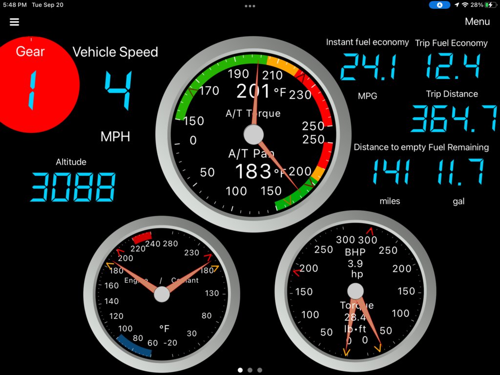

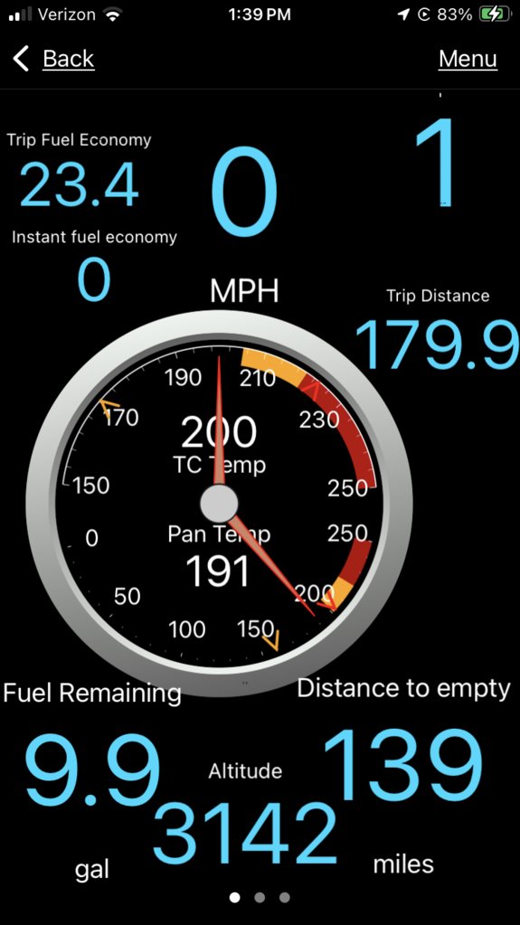

    What PID’s are you using for the pan and TC temps?
    Yes 3rd gear apparently partially locks up. I’ve never seen it show as locked on my dashboard in 15k miles of towing.
    On my dashboard I have a red circle behind the selected gear that turns green when the TC is locked.
    When you’re screaming up the mountains in 3rd you have the revs up and you’re moving fluid through the system quicker so that helps cool fluid. The TC will not be locked if you have that much throttle input.
    The operating temperature of the trans is 186’f and this is when the thermostat opens so I would put money on your pan temp being higher than 190’f if you’re driving through mountains towing that much and with your payload, that’s why I’m asking about the PID’s you’re using.
    Last week my pan hit 201’f and the TC hit 227’f driving up 4kft elevation whilst not towing anything.
    This screen shot was from not towing.
    This screen shot was from driving from Reno NV to Bend OR whilst towing a 5klb TT, also shows the lock up status (red circle)
