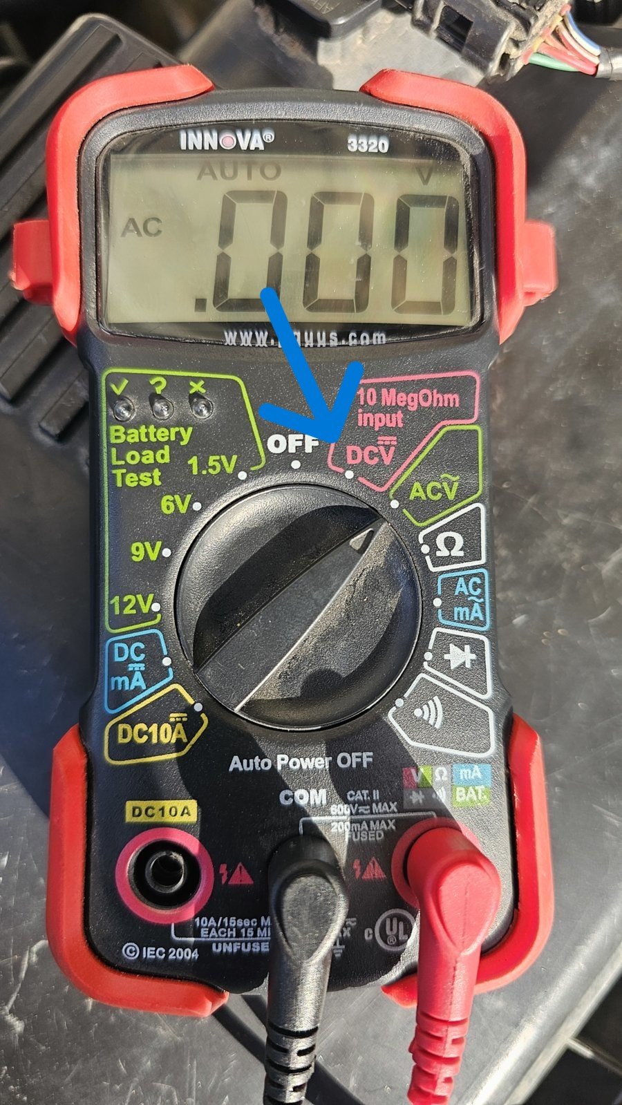

    Turn your meter dial ONE notch COUNTER-CLOCKWISE to DCV

    Ok got the reading at 4.99 volts. So it got power. But the secondary air pump did not turned on at cold start

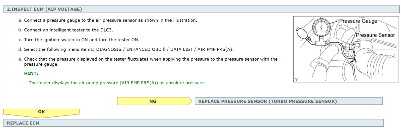

    I don't do this stuff everyday.
    @Dm93 does.
    But if you were to go off the flow chart.
    All you can do is tests the Pressure Sensor at this point.
    And I doubt your scanner has the ability.
    These ECM don't fail often. Like almost NEVER.
    If I were in your shoes, I'd feel safe throwing a pressure sensor at it.
    BUT.......You should NOT do that.
    What you should do is wait for Dm93 and maybe a couple other Techs to advise you better.

    Will your scanner show the Pressure Sensor value (AIR PMP PRS)?

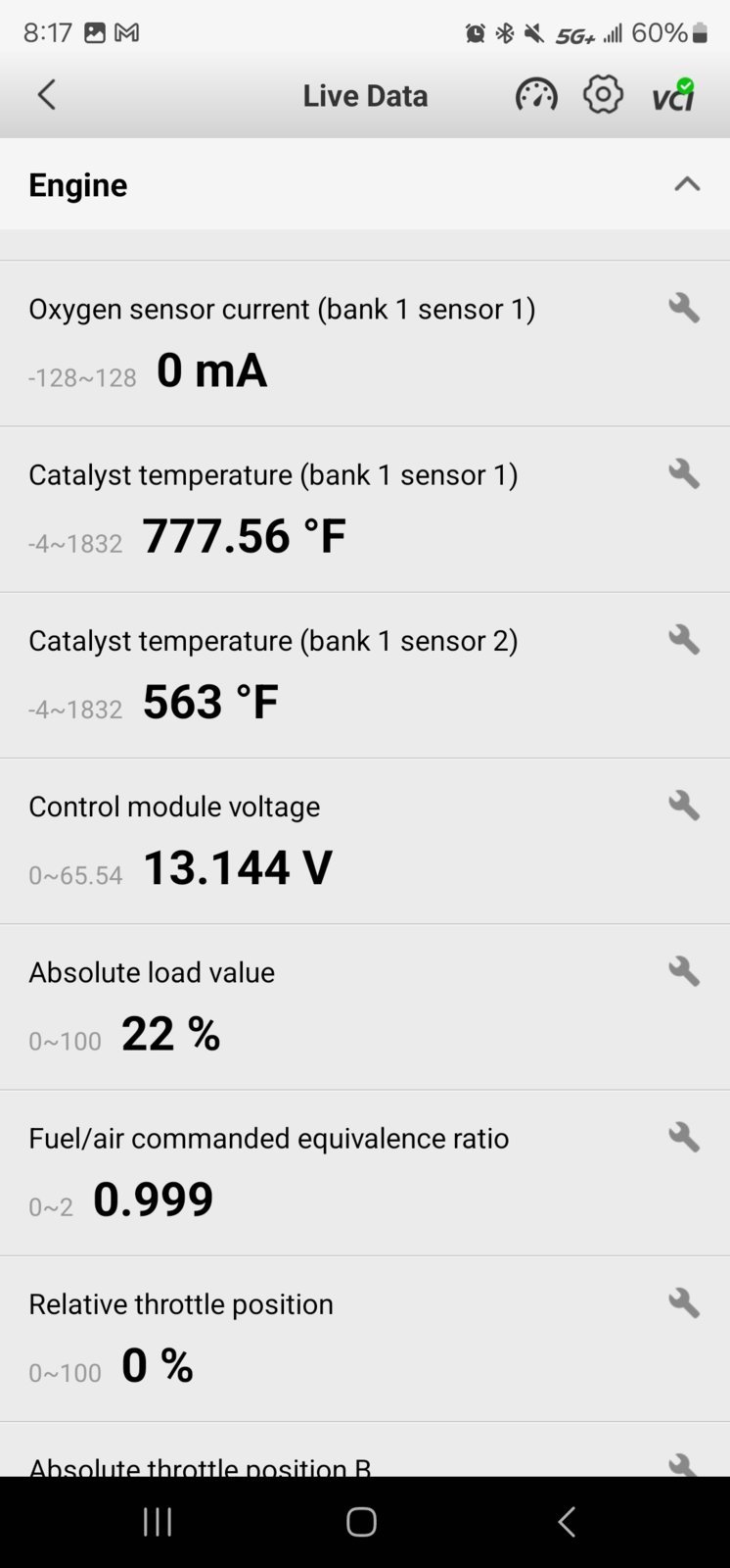

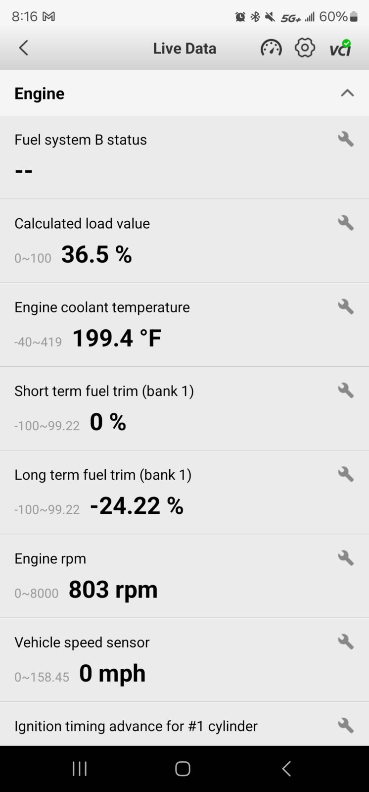

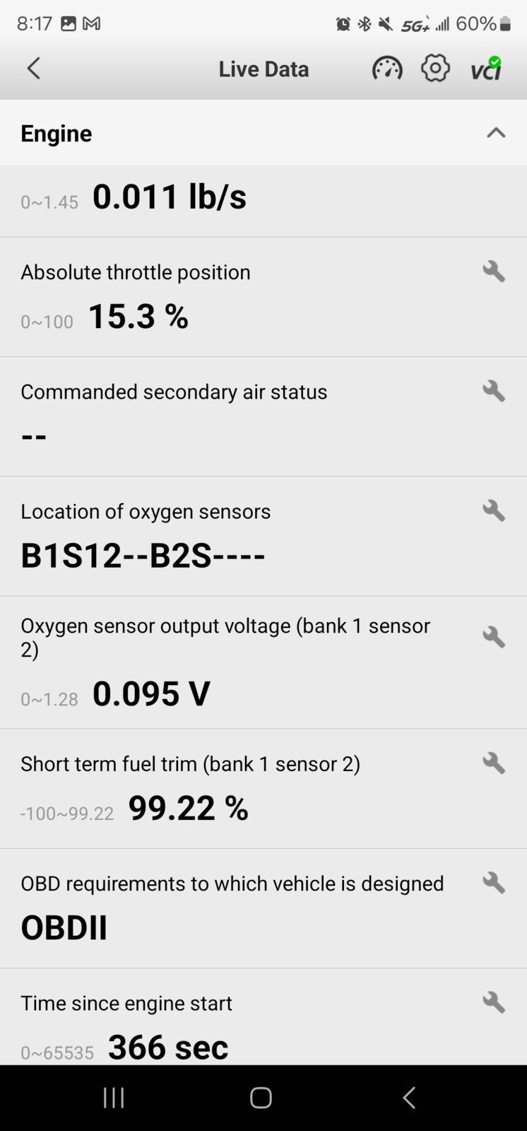

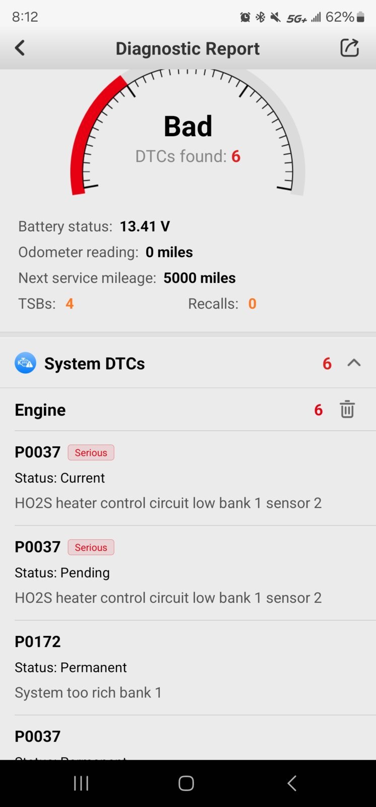

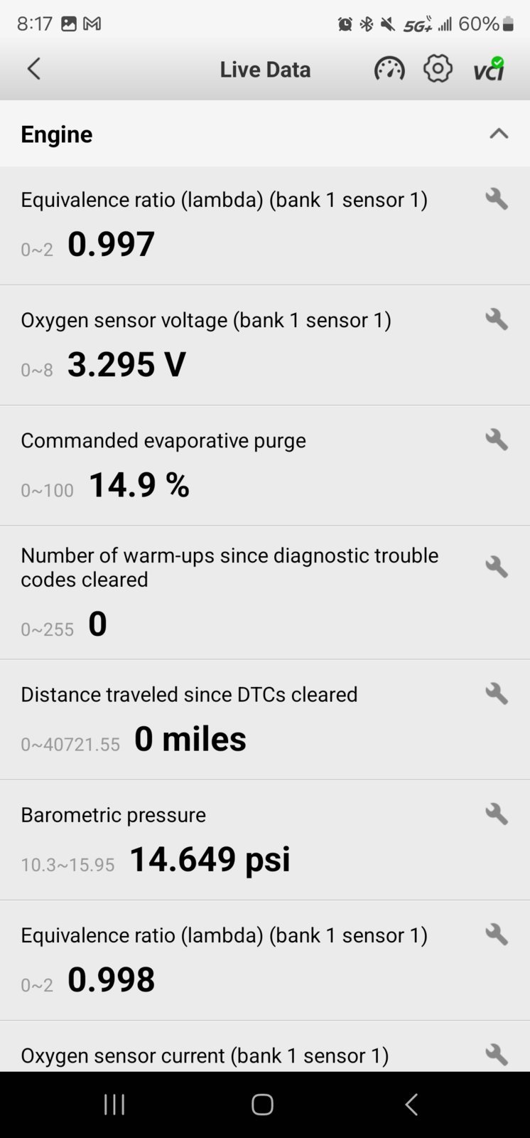

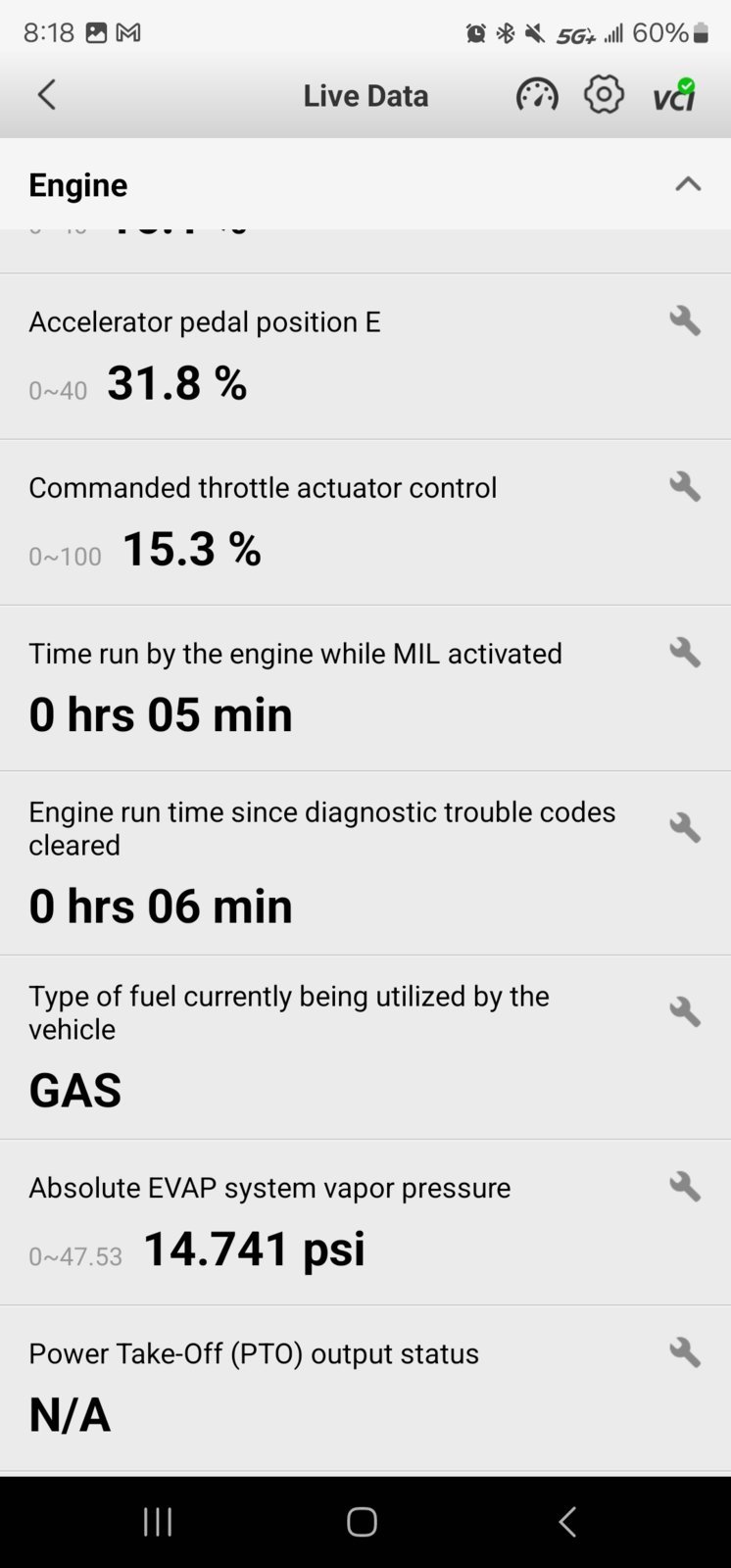

    Dont think so. This is what im getting now. I get the same error with the o2 sensor connected or disconnected. Been checking the wiring but dont see anything wrong.

    I dont understand according to this im getting the heater circuit low error. But i do get a reading on the catalytic converter temperature.

    The catalyst teperature is a calculated value, there is no temperature sensor.
    Have you checked for power at the O2 sensor heater wire yet?

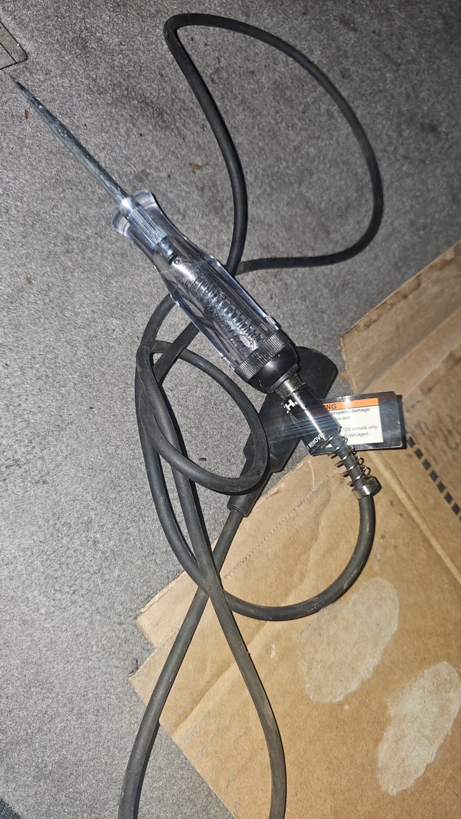

    That's a problem, do you have a test light so we can load the circuit?

    The one with the clamp and one poont to the connector?

    This one would work?
