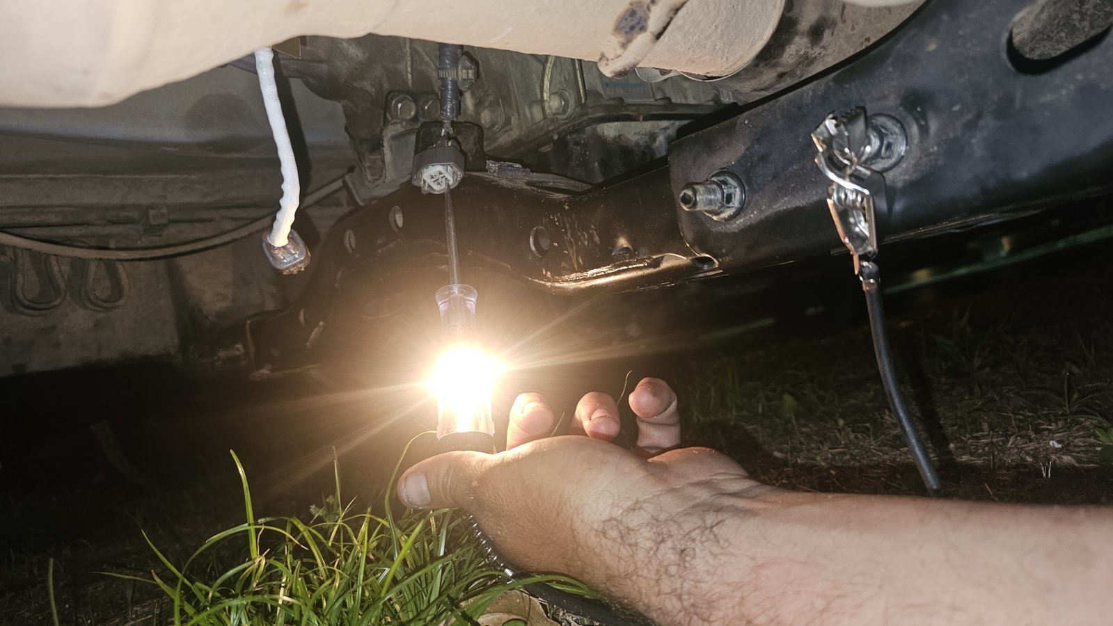

    Ok so i tested with a ground in a different place and the volts go higher than battery. On dcv 17+
  5. Jun 23, 2024 at 6:25 PM
    #45
    FrankFL.
    FrankFL. [OP] Well-Known Member
    Sep 30, 2022
    #406984
    92
    Franz
    2006 Toyota Tacoma
    Lift kit.
    With the voltimeter on dcv 10megaohm on white and blue cable its starts at 8 volts and starts climbing. Up all the way to 18 is that normal?

    Can you take a picture of your meter when it reads 18v+
    Looks like your meter has auto-range. Maybe you are reading it wrong?
  9. Jun 23, 2024 at 6:48 PM
    #49
    Dm93
    Dm93 Test Don't Guess
    Mar 3, 2015
    #150066
    13,763
    Texas
    2014 DC OR 6spd 4x4
    Predator tube steps, Ranch Hand grill guard, Magnaflow CatBack exhaust, Toyota tool box & bed mat, 2LO Module by @Up2NoGood, Rearview Compass/Temp Mirror, Tune by @JustDSM.
    See if it lights up the test light bright, if it doesn't we will need to go to Connector 2B in the underhood fuse box.

    It does light up on white and blue

    It is lighting up on the white and blue wire
  15. Jun 23, 2024 at 6:55 PM
    #55
    TnShooter
    TnShooter The TacomaWorld Stray
    Sep 2, 2010
    #42625
    21,338
    Deogee
    07' TRD Off-Road, Auto
    STOCK
    That's good.
    It should be.
    But is it BRIGHT?

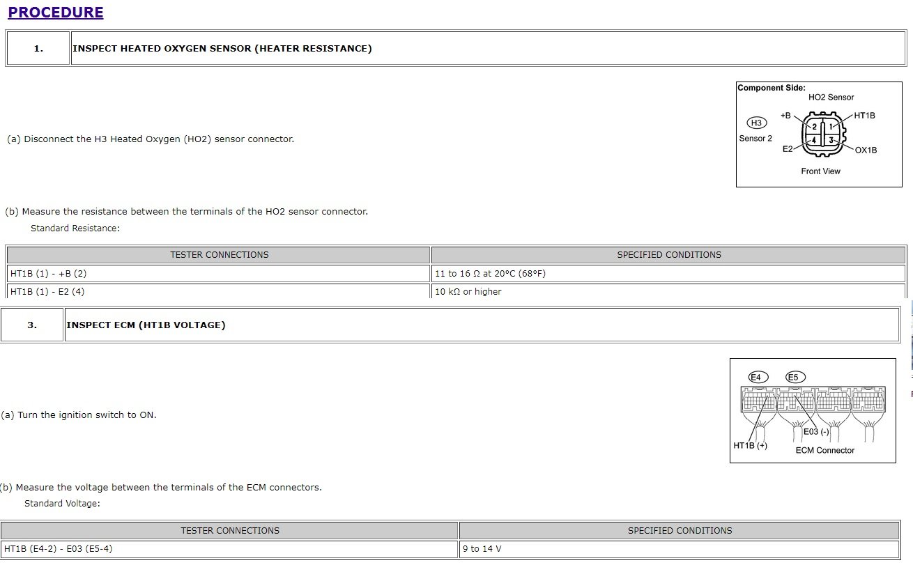

    Ok so we need to check the resistance of the heater and if that's good check for power at the PCM Connector E4 Pin 2 (Green).

    Yes

    The first test checking resistance on the heater is done on the connector attached to the sensor with the meter set to ohms.
    The second one at the PCM is with the key on and the meter set to volts DC yes.

    Ok so i tested the first
    Ht1b + b and getting 13.
    And on the second one no reading
