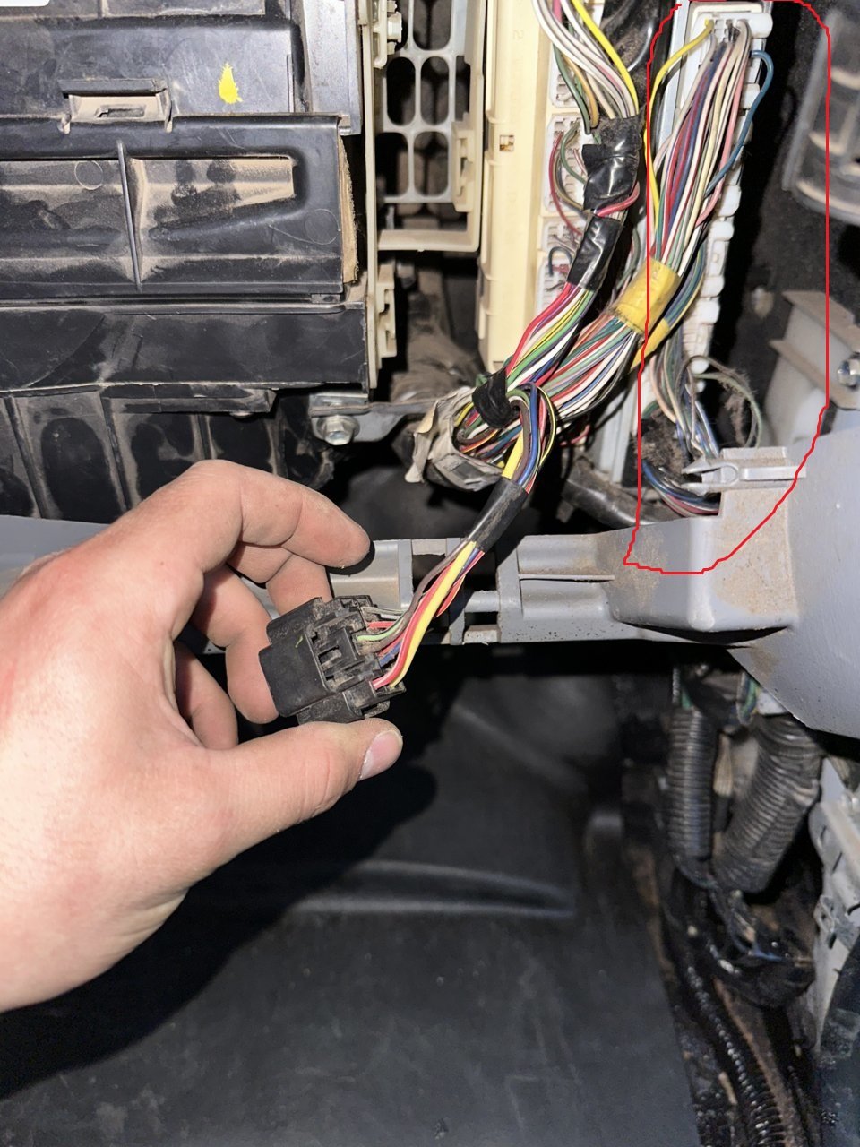

    Hello. Just got to work the tacoma. Any clue where is the pcm?
  8. Jun 24, 2024 at 4:48 PM
    #68
    Dm93
    Dm93 Test Don't Guess
    Mar 3, 2015
    #150066
    13,763
    Texas
    2014 DC OR 6spd 4x4
    Predator tube steps, Ranch Hand grill guard, Magnaflow CatBack exhaust, Toyota tool box & bed mat, 2LO Module by @Up2NoGood, Rearview Compass/Temp Mirror, Tune by @JustDSM.
    Behind the glovebox.
    TnShooter likes this.

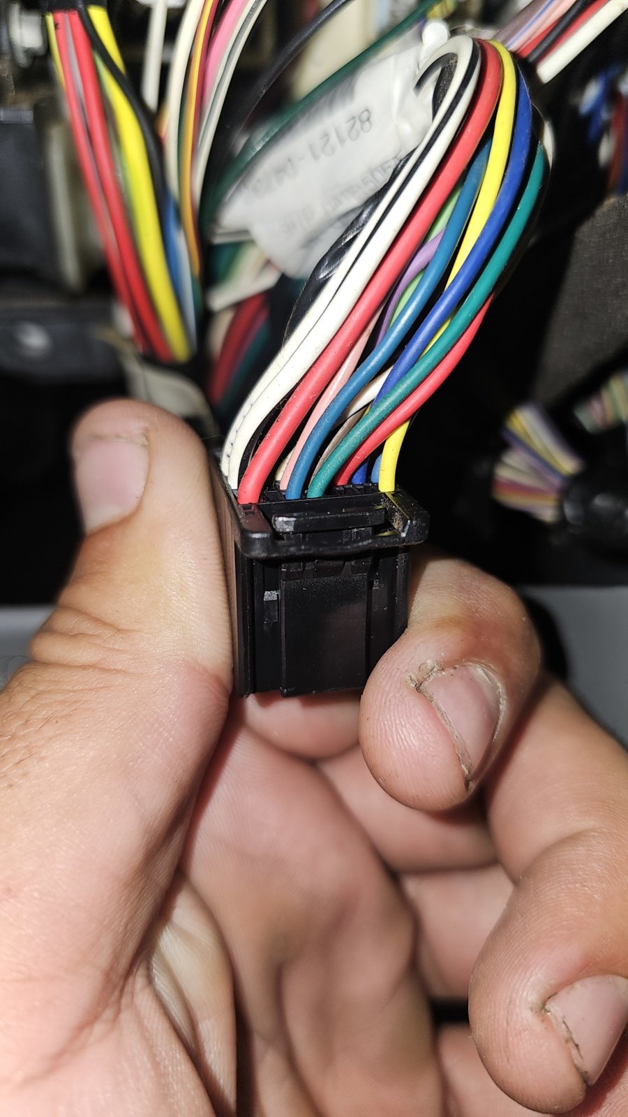

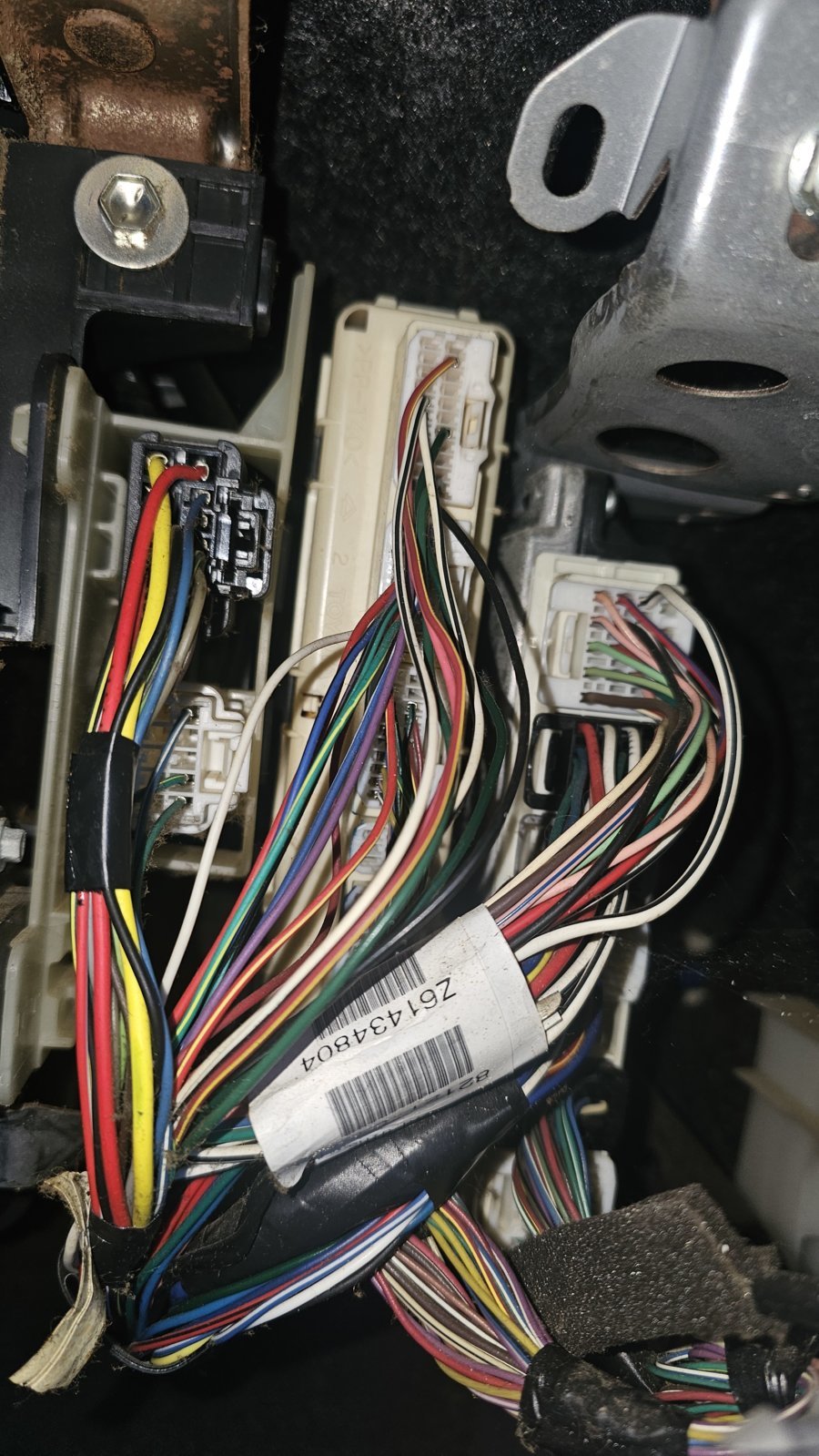

    Ok i got it here. Where should i start testing

    FrankFL.
    FrankFL. [OP] Well-Known Member
    Sep 30, 2022
    #406984
    92
    Franz
    2006 Toyota Tacoma
    Lift kit.
    Ok so for what i read on the pic is this two. Green and black and blue right?

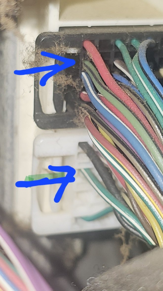

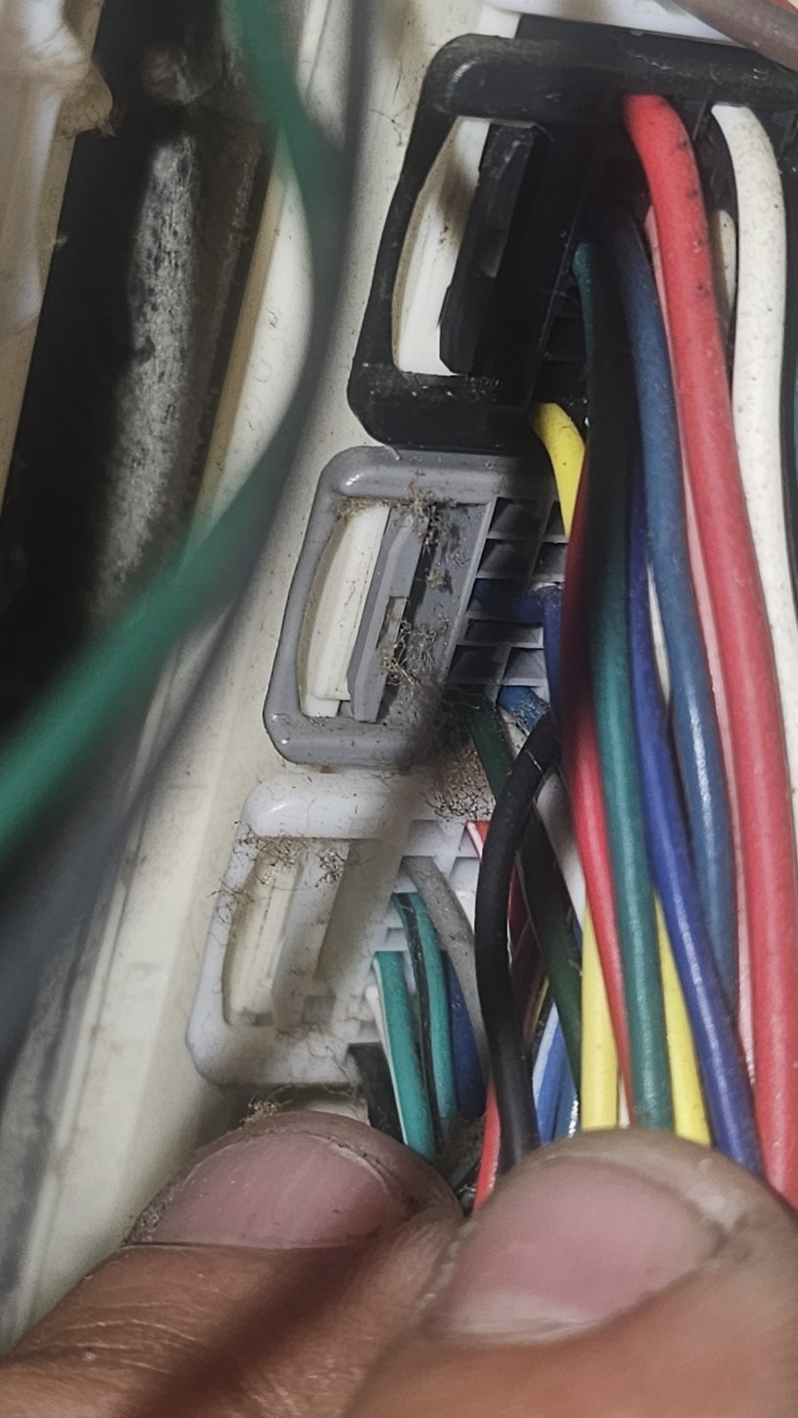

    Dont see a green wire on the second row
  20. Jun 24, 2024 at 5:51 PM
    #80
    FrankFL.
    Sep 30, 2022
    #406984
    92
    Franz
    2006 Toyota Tacoma
    Lift kit.
    Someone was here already i see a lot of wire tape and some labels. And one wire is completely covered in ductape. On the connector second row i see white blue, blue, red, brown and pink.
