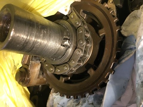

    it damages the HB seal......then later it can crack the inside timing cover..right on the back side of the oil pump gear cradle.
    and then after that....it can even sheer the woodwulf key.....and even wollow out the key slot....destroying the crankshaft..
    A sign that its gone too far....is when you try to tighten down the crank bolt.....it does nothin....still wobbles...
    Good thing replacing a crankshaft......aint that big of a deal.....
    only cost me $5K in parts and labor....
    If you try and just stick another HB on there with that shaft slot wollowed out like that....you'll get a couple K if your lucky........and then one day when you stress it...like the A/c compressor kicking on with a load.......HB will just bust free and spin......and then all your dash lights magically light up.....
    When you seat a new HB on crank....be very careful .....the new metal on the edge of its key slot can stick on that key......and when you crank that down ....you can damage both your brandnew HB key slot....and/or the woodwulf key....
    I would recommend file/smooth the front edge of the new HB's key slot a very tiny bit ...
    so there's no chance of it stabbing crooked...and that wont hurt a damn thing...
    live and learn....
