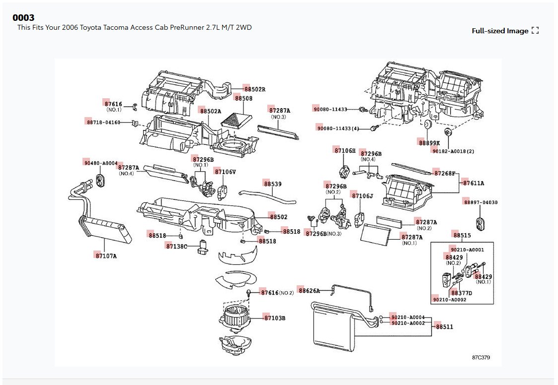

    Start with the basics:
    Cabin air filter. Replace it (I've seen ones after 15 years and people didn't realize it was even there).
    Fan Motor. Remove three screws; it drops out the bottom. Take care of that form gasket (often toast in Texas heat). Drop out the fan, inspect.
    The resister is marked as 87138C (this is just a locator diagram used by the parts counter, the next page shows part numbers). If you are new to wrenching, that's
    fine. One trick to screws is to put light pressure on them, screw them back until you feel a click. Now spin forward. Prevents cross-threading. I'm old enough to remember when AC was a rare option and the heater housing was all metal (1970 Toyota's). I'm older than dirt.
