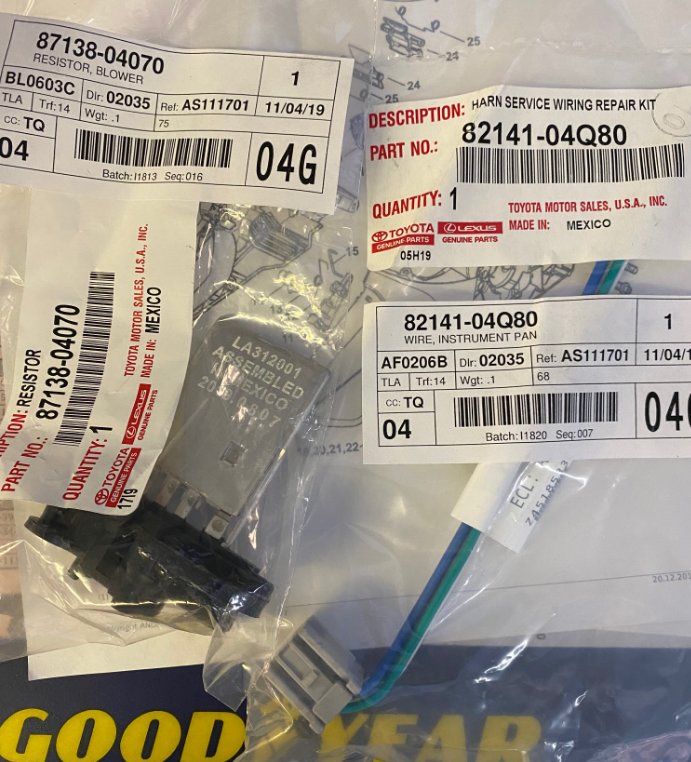

    Welp... replaces both terminals on Saturday... worked fine until today... not working now... so I’ve been through the resistor and connector and the connector and leads on the blower motor... HELP!!!

    Did you look at the connector on the Blower Controller in the dash?

    you may need to replace the blower itself, a few screws and it drops right out. I had the issue of the fan only running on HI. Replaced the connector and resistor, no luck. Replaced the blower and been running fine for over a year now.

    Jimmy, I did not... oddly enough, I wakeup this morning and the damn thing was working when I started it up... :frusty:

    That's starting to sound more and more like a bad blower motor because where the motor armature stops can affect how (and if) it's going to start next time.

    ^^^ agree
