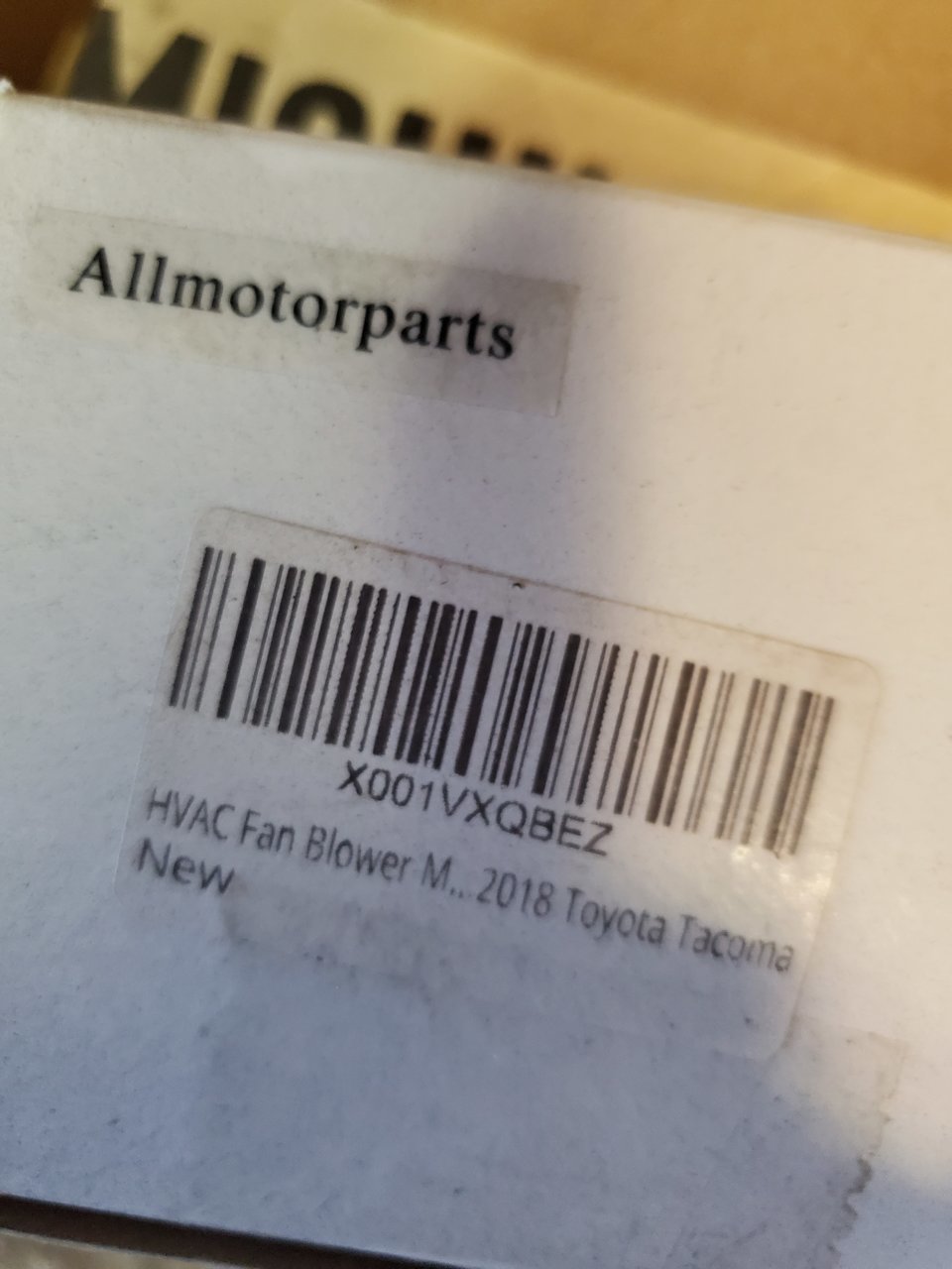

    Parts ordered! Thanks guys!

    Parts came and done! Thanks a bunch!!
