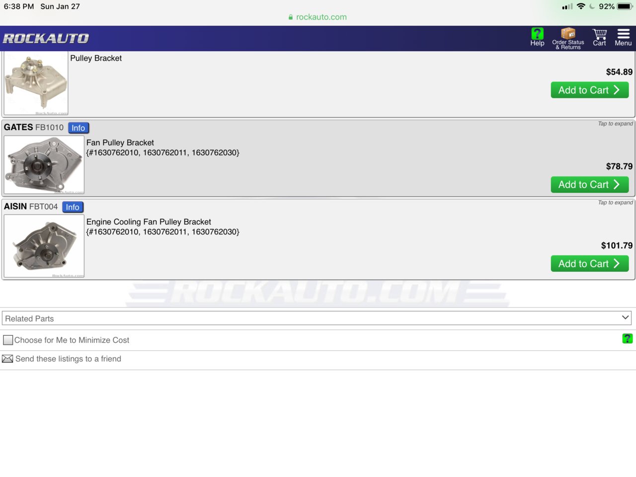

    If that trick doesn’t work, rockauto has Asian ones for around 100.00 that work great.
