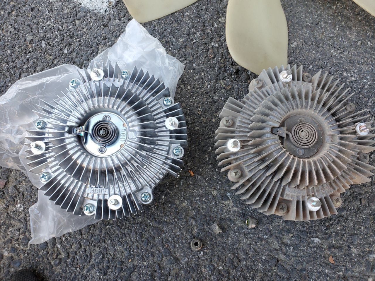

    FYI, my new Import Direct / Hayden 2670 fan clutch sounds and test drives good. This turned out as one of the easiest jobs I've ever done.
    I've had a rhythmic vibration for a couple years when under steady load going uphill at ~55mph. That appears to be gone too. It was all the fan clutch. I wonder if a couple nuts were not seated properly on the original one by a mechanic at some point, the way it had a little wobble.

    Does the Alsin/OEM perform better than the Hayden? The Hayden is roaring the fan at weird times at low speed like the OEM never did. At least I think that's what I'm hearing.

    Just buy a new Aisin green band.
    It's cheap, easy to replace, and will keep your truck as cool if not cooler from the factory depending on the clutch it came with.
    The Aisin orange band is the common one found on most of these trucks unless you got a specific package.
    One of those "why would you buy any other brand" sort of parts.

    I just see the Aisin FCT-013 as compatible.
    Any reason I might benefit from a new fan blade too? Aisin makes one too.
    It turns out that rhythmic vibration at high speed uphill that I thought was fixed by this isn't gone. Makes me wonder if that could be a tweaked fan blade, if the fan clutch is even engaged at that speed? The blade looks fine from what I see.

    Yes, FCT-013 is the one you want.
    FCT-067 is also a direct replacement, but meant as a lighter duty variant. Use the first one mentioned.
    As for the blade, I can't comment on that. You'll want to visually inspect it once you pull it off. Make sure your shroud is properly attached too.
    About a 10-15 min job to replace.

    Also check the bracket/flange the fan clutch mounts to. I had a bearing in there go out as well. Easy to replace if needed. Also agree why wouldn't you just go OEM/Aisin on this? As for it being locked at weird times, I wouldn't worry about it until it stops locking/your truck gets really hot sitting in traffic.
